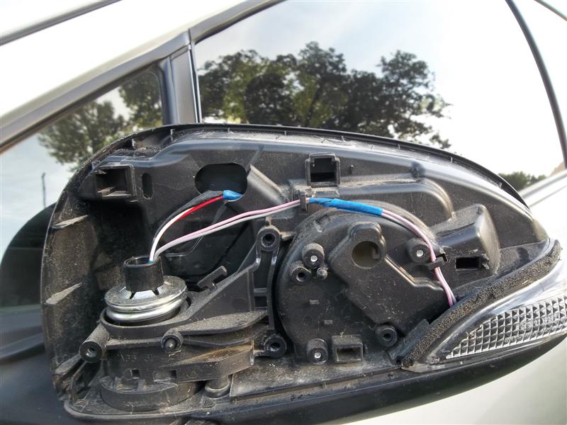

    You don't need to remove the Mirror head from the car or the door trim panel.
    #1 - Remove the mirror. The glass from the mirror pivot has 4 clips that must be released to remove the glass.
    #2 - Remove the mirror back cover. It also has clips. I think it has 4 also.
    #3 - After you get the back cover removed you'll see the retaining clips for the turn signal light lens. It has 2 clips
    that must be pushed to release it from the mirror housing. Then you can replace the bulb.

    This is what I see with the back removed. I can't figure out how to get the glass mirror off. 100_1835 (Medium).JPG

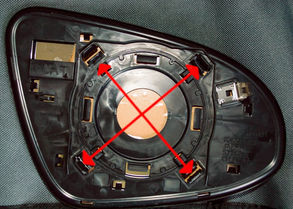

    The Mirror has 4 clips that attach to the pivot on the power motor head.
    Here's a few images.

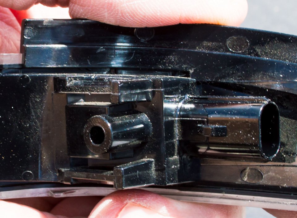

  8. Drdiesel
    Drdiesel Active Member
    Jun 11, 2013
    585
    153
    Monterey CA
    You can't replace just the bulb in the mirror mounted turn signal. The bulb, plug and lens are a sealed
    unit. Toyota really did a number on this design. I plan on cutting it open to replace the bulb with an LED bulb.

    You get behind the mirror with your finger and push the tab away from the pin and it pops off.
    You can gain access to the first one by pushing the mirror towards the bottom and out. Work from the top
    side and it pops off pretty easy.
    If you look close at my images in post #6, you can see how the mirror has two tabs. One on each side that slips over the pin on the motor pivot head.
    They just slip over the motor heads pivot pin. Look at the red arrow I placed in the images and you'll see what I'm talking about.
    Those images were taken from my car.
