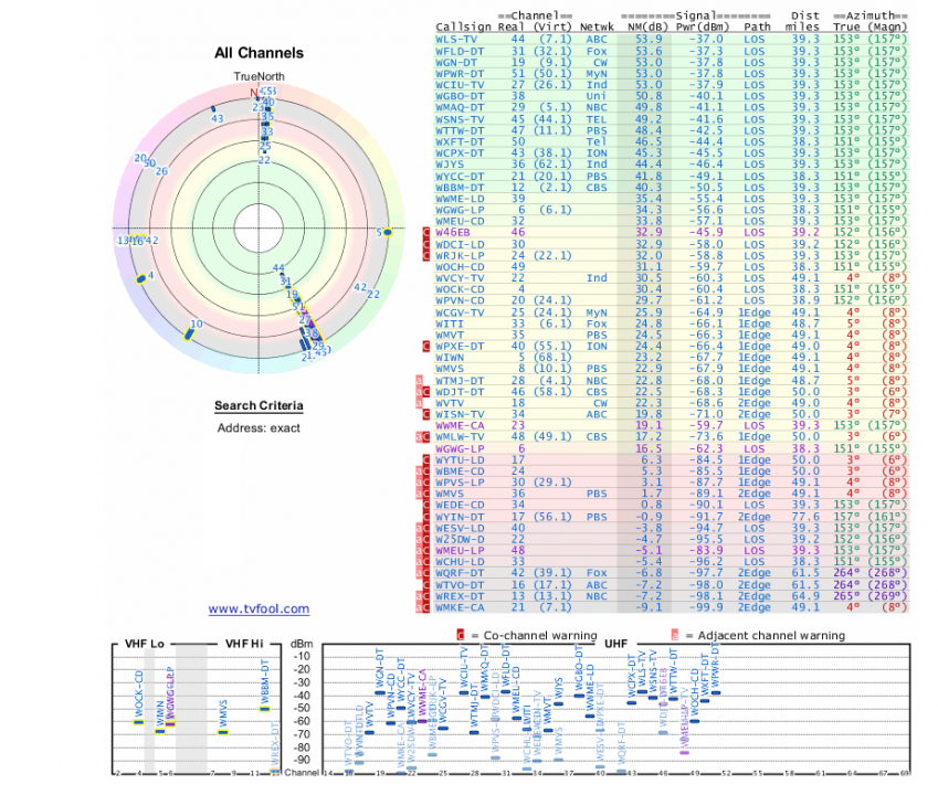

  9. TonyPSchaefer
    May 11, 2004
    14,816
    2,500
    66
    Far-North Chicagoland
    tvfool.png OK guys. Thanks so far. Here is the tvfool.com evaluation for my place. It seems that the bulk of the channels are NNE (more like NNNE) and SSE.
    Excuse my very ignorant question, but it almost seems like I need two antennas, one in each direction. Is that even possible?
  10. fuzzy1
    17,601
    10,369
    It seems that you should first focus on the stronger SSE stations. Then identify what programs you want to see on the weaker N stations that are not available on the SSE signals, and how badly you want to see them.
    Omnidirectional and bidirectional antennas will have no problem with the opposite directions. Rabbit ears, old set-top UHF loops, dipoles, folded dipoles, and the homemade antenna Mendel pictured fall into this category. But you'd have to be very careful with your installation in order to not lose too much signal to tune the weaker N stations. Indoor and attic installations will have a tougher time of this than outdoor mounts.
    For unidirectional antennas such as I linked to, performance will depend on the front-back ratio. You might be able to point such an antenna directly towards the weaker N stations (or split the difference between N and NNW) and still get enough signal from the strong stations in the back (SSE) to sufficiently tune them in. Again, this will work better with high outdoor mounts. Not being a real RF engineer, and lacking the proper signal analysis equipment at home, I use the trial-and-error method to determine what I can receive.
  11. Mendel Leisk
    59,929
    41,187
    If you're signals are close to 180 deg apart that's actually very good, using a directional antenna without a reflector. There is no front or back to it.
    The bulk of our stations are to the north west, but at least one is to the south east, albeit a bit further away.
    Hah, see Fuzzy's on it. Good good.
  12. TonyPSchaefer
    May 11, 2004
    14,816
    2,500
    66
    It took me a little bit of time to figure it out. I'm admittingly a bit slow on the uptake sometimes. Notice in my location that I'm "far-North Chicagoland". Embarrassingly, I actually had to ask myself, "why would I be getting two large clusters due North and then also almost due South?".
    Yeah. Duh.
    Milwaukee is almost exactly due North and Chicago is SSE.
    Per fuzzy's suggestions, I'm going to focus on the Chicago stations first. I mean, seriously, why bother with Brewers and Packers games when I can watch the Cubs, Bears, Bulls, and Blackhawks? As Mendel said previously, "are you going to miss hockey?"

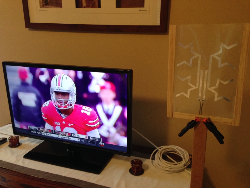

  14. TonyPSchaefer
    May 11, 2004
    14,816
    2,500
    66
    Using the instructions at DIY Flexible Fractal Window HDTV Antenna I was able to run proof-of-concept test over the weekend. The full-HD digital image was better than the cable box I was using.
    I was most impressed that the broadcasters send scheduling information. I was able to browse shows and check schedules.

  15. Mendel Leisk
    59,929
    41,187
    Isn't it a mind blower? ;)
    With our stations and tuner if I press info I get just a terse explanation of the current show, and how long it's on. Depends on the area I guess.

  18. Mendel Leisk
    59,929
    41,187
    Have you tried your homemade antenna in the attic?
  19. edthefox5
    edthefox5 Senior Member
    Jul 25, 2007
    10,096
    4,833
    Clearwater, Florida
    Nay. Just buy a regular antenna. That antenna bandwidth is 400-700 and there's quite a bit of stations here for instance below that freq here.
    Go to antennaweb.org and look up the freq of all the stations in your area.
    Go to mcm.com and look up antenna selections for a mid size antenna.
    MCM Electronics - Search Results for antenna
