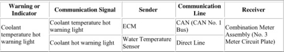

    But maybe I'm mistaken. I did find this table a while back in the repair manual, indicating the light comes on either because of the EHRS sensor in the hose tee, directly wired to the combination meter, or because of a CAN message from the ECM (which is where the sensor in the cylinder head connects).
    The table doesn't exactly say under what conditions the ECM sends a CAN message to turn the light on. It could be only when the cylinder head temperature sensor goes over, or it could be because of that or a message to the ECM from the power management control ECU about inverter or transaxle temperatures. I don't know for sure.
    The one in the cylinder head is the one that's wired to the ECM and is reported at the OBD-II standard PID for a coolant temperature from the ECM. The one in the hose tee is wired directly to the combination meter, so you will see that reading only on a scan tool that has the ECU address and PID for that.

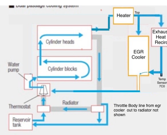

    The Car Scanner app with a bluetooth obd2 or Techstream can read both temperatures identified as engine coolant temps as referenced in Brian's link above.
    Car Scanner app with engine warming up
    Exhaust Coolant  7C0 and Engine 7C4 Temp Sensors.jpeg Two sensors to combo meter.jpeg
    Normally the two temps stay within 3 degrees of each other after warmup.

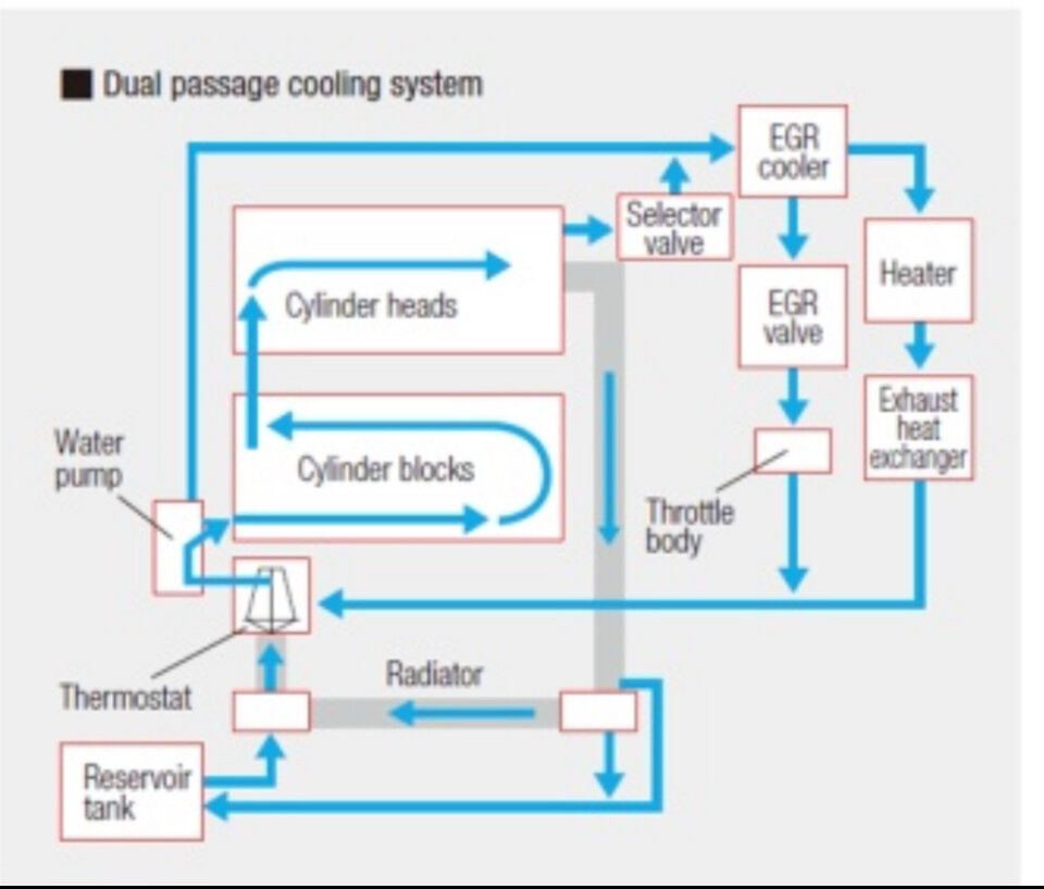

    The question then becomes why are there repeated incidences of gen4 engines in gen3 cars overheating at the temp sensor monitoring the exhaust heat recirc system. Especially when things were fine before conversion?
    One might think the gen4 coolant bypass line not used on the conversion and the missing gen4 selector valve are suspects.
    A gen4 cooling system has a water pump direct bypass to the Egr, heater and exhaust heat recirc system. This bypasses the engine. It also has an electric selector valve to reduce or shut off engine heated coolant from going to the recirc system.
    Gen4 engine with gen4 coolant engine bypass and engine_coolant control selector valve
    What happens if the gen4 secondary flow to the egr/heater/recirc system is higher than a gen3 engine?
    A gen4 engine in a gen3 control system without a bypass or selector valve may excessively preheat exhaust heat recirc coolant at all times.
