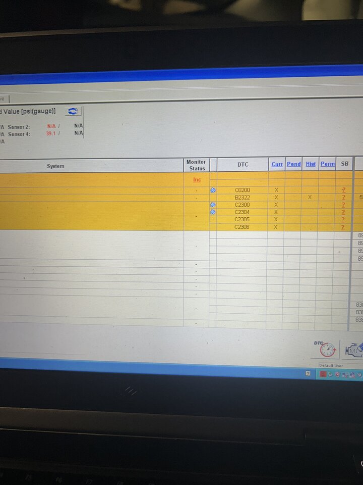

    I have a 2011 Prius with P Lock Malfunction
    C2300 C2304 C2305 C2306
    I replaced the head gasket and as I’m ready to start up the car now I get the codes mentioned above. Only other thing I did is I kind of used it as a parts car before. I borrowed the Integrated Relay, Integration relay and Hybrid Battery. I put everything back from a running car and now I get the P lock Malfunction.
    Any suggestions where to start the troubleshooting procedure.

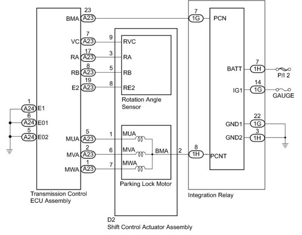

    Looking at the shift control actuator it is missing 12v coming from the integration relay.
    I need to trace the wire and see if there is a short somewhere.

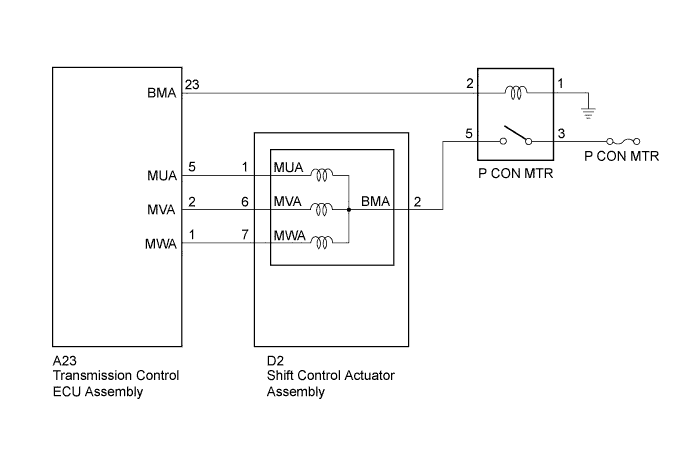

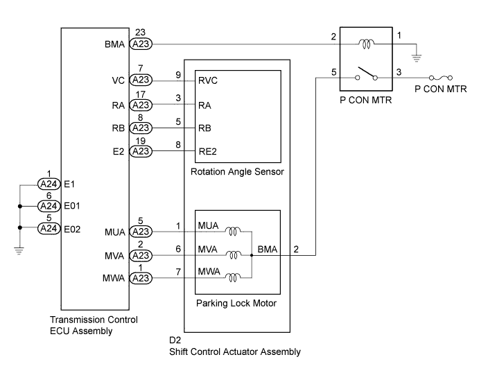

    To check the circuit in the error code C2300, this diagram is used. The A50/A51 connector is not here.
    To check the circuit in the error code C2304, this diagram is used. The A50/A51 connector is not here.
    gus1203 likes this.

    from my findings so far I have an open wire at BMA 2 - 8 at PCNT integration relay. I will trace wire later today and post update.
    and you are correct A50/51 connector is not is this circuit.
    Thank you
