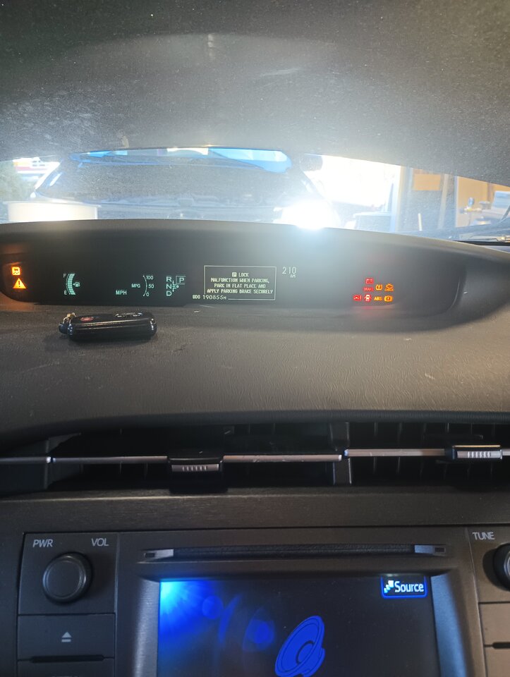

    Ok. So I am helping a family member put an engine in his 2012 Prius.
    We got it all mounted up, and apparently something is wrong.
    Basically, it won't go into park. It doesn't appear to be false failure, as when I jack the front end up I can spin the axles.

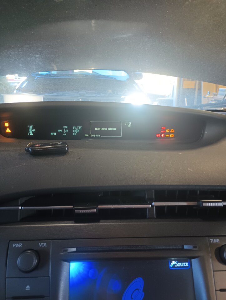

    6) put it in maintenance mode. It ran the pump, so I at least got to bleed the inverter coolant...

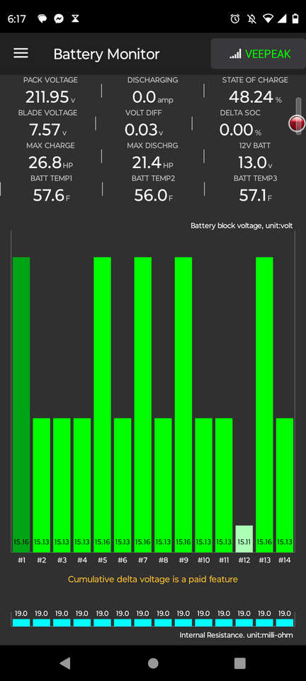

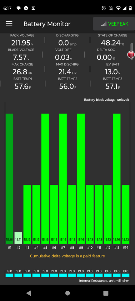

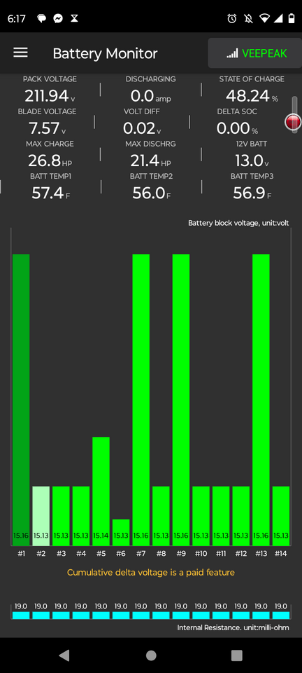

    I have a few pictures of the dash, and of the dr prius app. The dr prius screenshots were taken while trying to jump the car.
