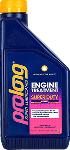

    Of course, as long as it's SUPER duty Prolong.:ROFLMAO:
