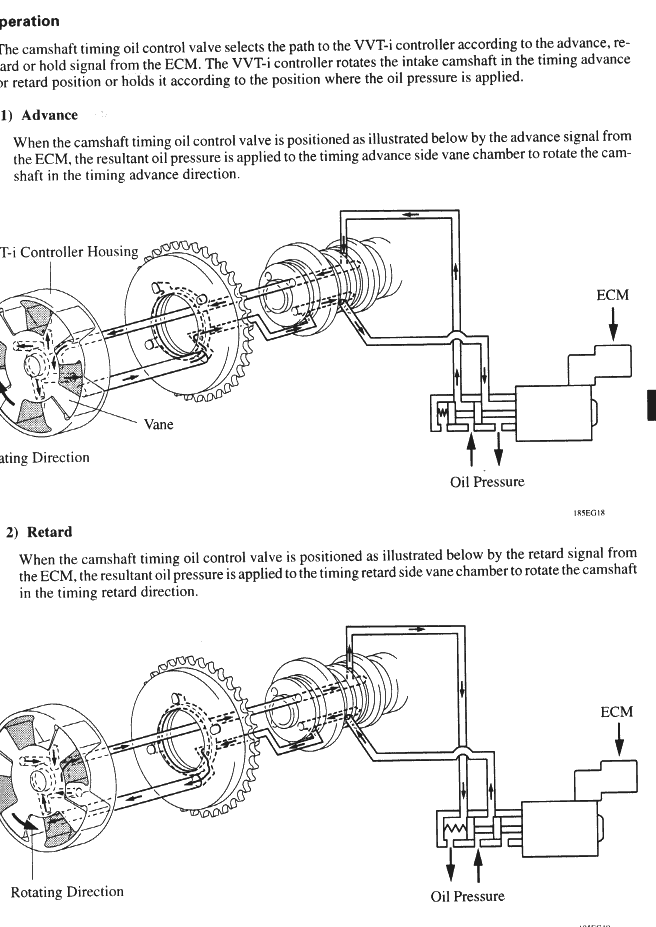

  7. ChapmanF
    28,638
    18,959
    Thoroughly described in the New Car Features manual (more info).
    Part of it pasted in the thread of the guy who was selling one that's better because it's red.
