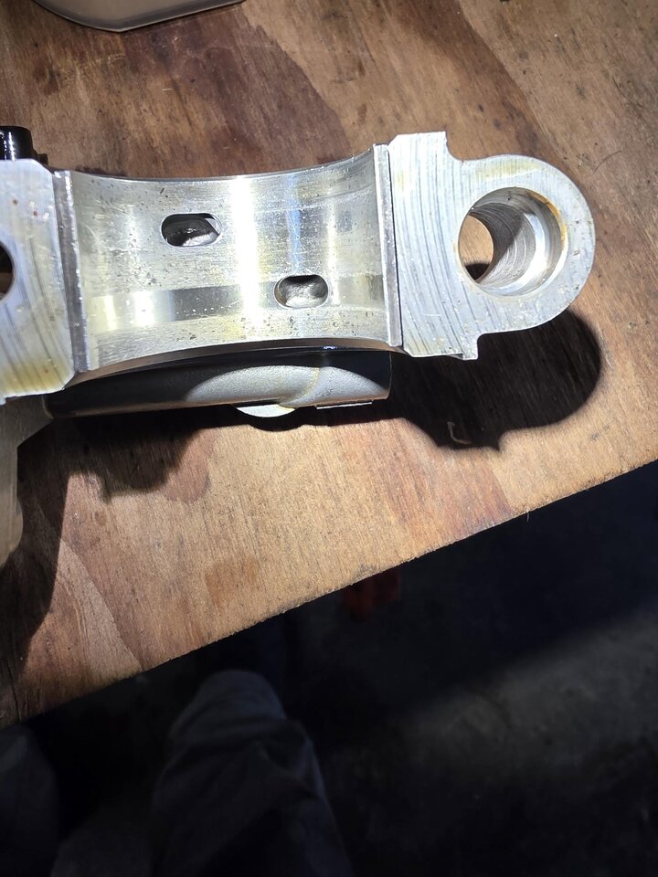

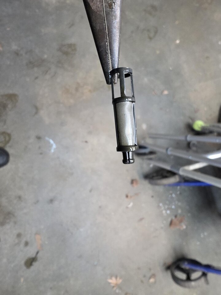

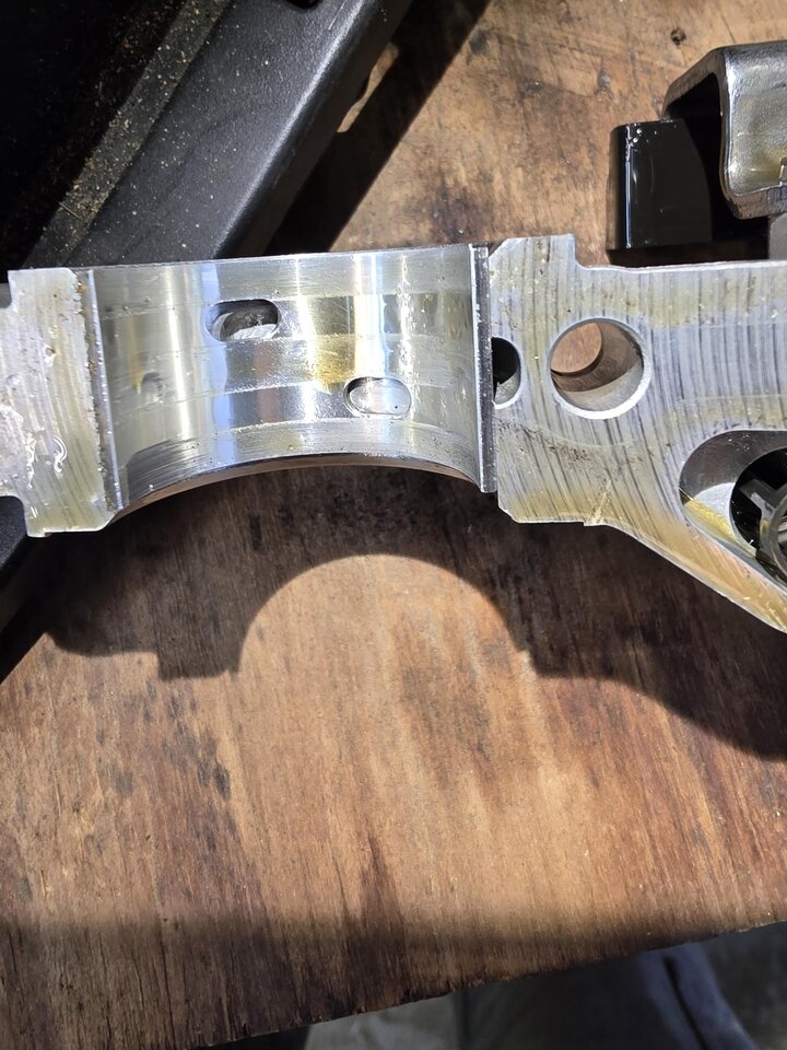

    Ok I apologize for the delay I had some family issues going on but I finally got around to pulling that and checking it and it looks like I was ok so still no luck in figuring out this code. Any more sugesstions? I am including pictures showing how they were installed (tahe one is a little shifted in the pic but was lined back up when installed). I also included a pic of the filter showing it was clean.

    Replace the frowny face and o-ring with genuine Toyota. Also clean the screen that is located near the VVT solenoid.
