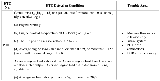

    I'm skeptical about loading up the parts cannon just yet, through Amayama, even the generic equivalent would be around $110 CDN all-in. When I cleaned the one in there it looked pristine, fwiw. To, maybe a red herring, but it seems like this started on the heels of that sketchy gas fill up.
    Attached is the Techstream-laden diagnostic procedure from Toyota, for P0101 (plus P0102, which is referenced):
    As far as I know, the check-engine light came on with the car fully warmed up, on a steep uphill. Residential neighbourhood, doing about 50 km/h. At least that's the first I noticed it.
    Guess I'll wait-and-see for now. I don't think the MAF sensor cleaning was necessary or did anything, but I'm hoping the code clear plus the dilution of the possible bad gas may do something.

    P0101 is an interesting code. The ECM computes two estimates of the load on the engine—one based on the MAF reading, one based on "driving conditions"—then sets the code if the estimates are not close enough to each other.
