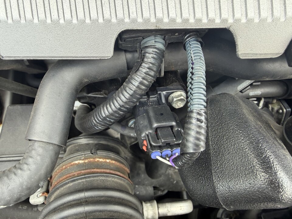

  7. Kwm488
    Kwm488 Junior Member
    Nov 26, 2018
    38
    Hong Kong
    Hi
    I replace this MAP sensor. It is visible , mount into the intake manifold
    I uploaded a photo
  8. Brian1954
    Brian1954 Senior Member
    Jan 31, 2021
    2,687
    1,073
    South Central PA, USA
    Yes, that is the MAP sensor.The location on a Gen 4 is different than on my Gen 3.
    What is the short term fuel trim (STFT) and long term fuel trim (LTFT) when the engine is idling?
    I am guessing that you have a vacuum leak. I would first check the small vacuum hose on the sensor. Find out were the other end of that vacuum hose connects to. Check both ends of the hose for any cracks that may have developed. Replace the vacuum hose if you see any cracks.
