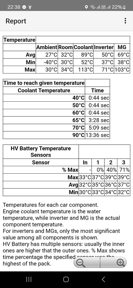

    I got the red thermometer light on the dash recently while driving a steady uphill on a highway. Pulled the car over instantly and checked the ECT reading in the Hybrid Assistant app which was at 113 degrees Celsius (see the attached screenshot). It took me a couple seconds before I checked the HA app, so the light might have come on at 110C. The engine would start when pushing the gas pedal. Didn't have the engine shutdown like in the water pump code scenario.
    As for the ECT sensors, the HA app must be getting its temp data from the D6 (brown and pink wire) connector. Every time I compared the HA and Car Scanner readings, HA would show the higher temp from the two available in the Car Scanner app.
  4. ChapmanF
    27,648
    18,243
    I know the threshold for the EHRS sensor to turn on the light is 120℃ because I actually used a variable resistor in place of the sensor and turned it until the reading was 120℃ and the light came right on like clockwork.
    I've just never actually gone out and done the same thing with the ECT sensor. I keep meaning to; I would be more sure of that result than I would be just from saying "the light came on while driving and ECT was X". It's possible I don't know all the reasons the light could have come on.
    What did Car Scanner show for the EHRS temperature at that time?
