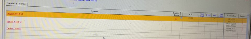

    My 2012 Prius with 278,000 miles has a problem. The engine sounds awful and act like it is shaking off of its mounts. The check engine light is on. There is an unburnt fuel smell as the car runs. The engine oil dipstick seems free of coolant. The code from the computer is P0303. The scan tells me that the number 3 cylinder is misfiring. My reading of prior post suggests a possibility of a bad coil or a blown head gasket. Are coils something that should be replaced after a certain number of miles? I can replace them all for about 50 dollars. How do you tell if there is a blown head gasket? How do you suggest I proceed? Thanks so much for the help…

    Thanks for the help… I changed the coil between one and three. Correct me if I’m wrong, I understand the cylinders are counted from left to right in order. I have some software on my computer to read the codes. Unfortunately, I can not tell if the information is new in that the number of misfires did not change from my earlier exam. Also the engine would only run for a couple of seconds before it would shut off. It did give me another code of P0302. It says that both codes are active. I have not swapped spark plugs or injectors yet. As to my coolant level it seems like it might be a little lower than the last time I checked it. I drove the car about 5 miles with the issue. It never ran great but at forty-five the engine vibration was greatly reduced. Would the coolant go down much with 5 miles of driving? Is changing the head gasket a difficult job? I am up for trying. I successfully disassembled my HV battery to get rid of the triangle of doom, changed brake rotors and pads and replaced the brake master cylinder along with general maintenance.

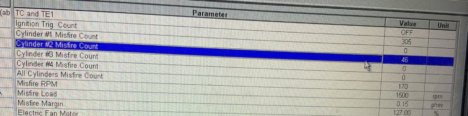

    I swapped the #3 cylinder spark plug with #2 cylinder and the #3 coil with #4 coil. I watched the live stream from the car computer and as the car was running, the #4 cylinder was active. I’m not sure what it means but there is a “value” that goes up and down. The #4 fluctuated while all of the other cylinders remained at 0. There is a total misfires number that continued to go up. I am going to move the coil over to the #2 cylinder and see if the problem follows. This suggests that the coil might be the problem and it would be worth replacing. Input regarding this information is appreciated. A couple of questions: What is the “value” that is going up and down represent? What coils do you recommend and should they be replaced as a set or would replacing only one be acceptable? I was asked earlier what brand of spark plugs I have. They are autolite. I have included a comparison between the #2 plug and the #3 plug. Thanks so much for the help… IMG_3663.jpeg IMG_3662.jpeg

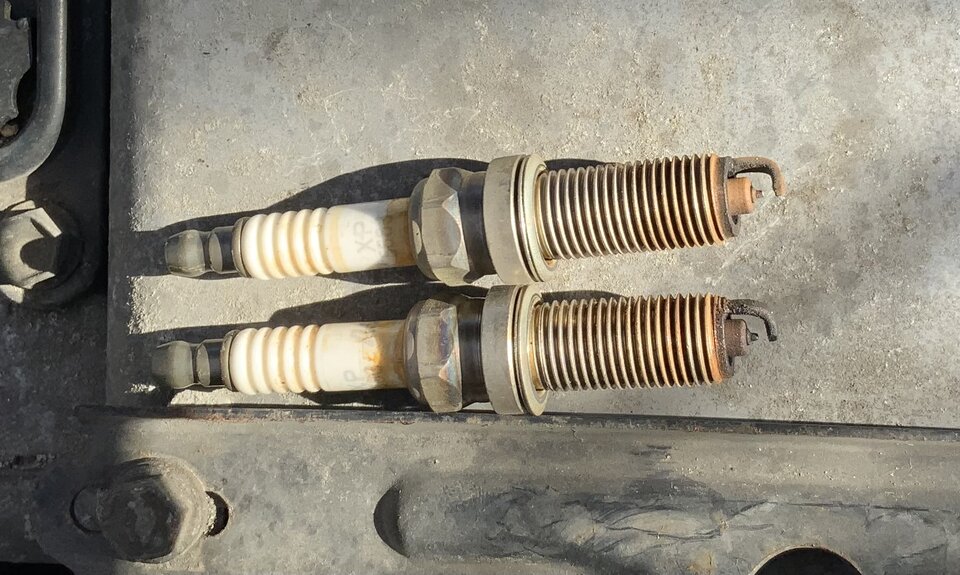

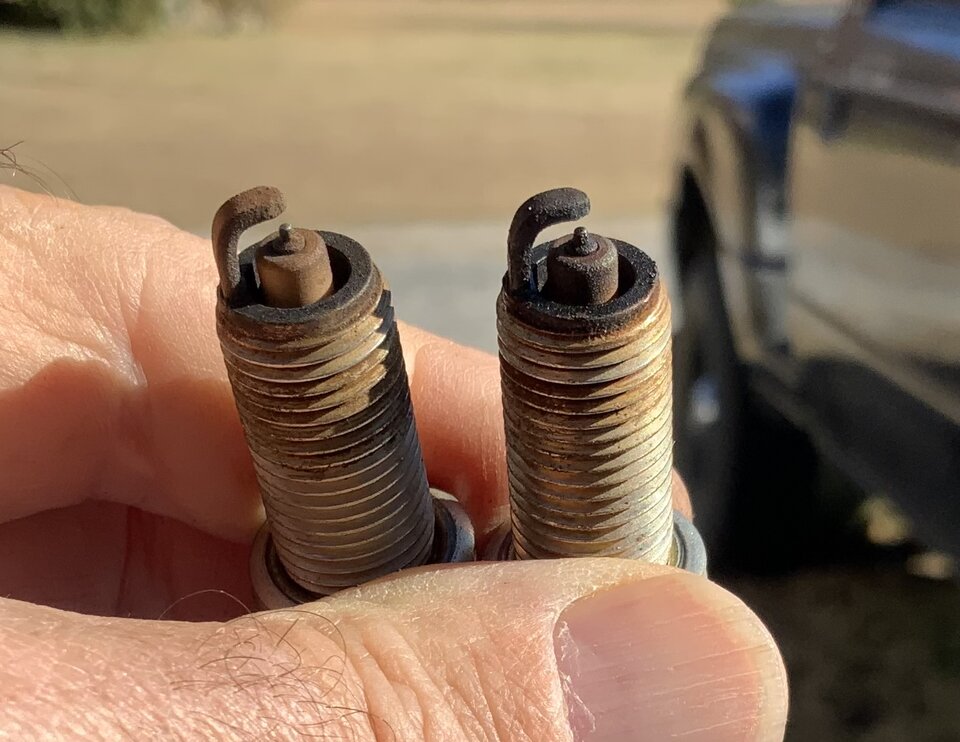

    Sounds like you have a problem with the coil currently in #4 position. At close to 300K miles; IMHO - I'd go ahead and replace all 4 coils. Toss out the know bad one, keep the other 3 for future troubleshooting. Are those Autolite spark plugs iridium? Iridium plugs will go 100K+ miles w/o issues.
    re: spark plugs. The brown one is fine, the darker blacker one is burning some oil or running a little rich in that cylinder. Should probably run some injection cleaner with your next tank of gas; that might clean-out a slightly leaky injector issue. If the slightly blacker plug is from #3, that would explain the darker color - unburned, rich fuel mixture from intermittent misfires.

    A value of zero on a cylinder misfire counter means no misfires, while a higher number represents misfires per 200 revolutions.

    Thanks to all. I did clean the EGR and all of the pipes, the intake manifold and replaced the PCV. I installed an oil catch can and cleaned the MAP sensor. I soaked the EGR with oxiclean for a short time and then hit it with a pressure washer (did not hold the EGR with my hand). I was covered with specks of soot but the EGR was clean. That was about 30K miles ago. I moved the coil to #2 cylinder, cleared the codes and the new code was P0302. I will replace all of the coils and spark plugs. I will get iridium spark plugs. Please recommend good coils to purchase. I will give an update. Thanks again
