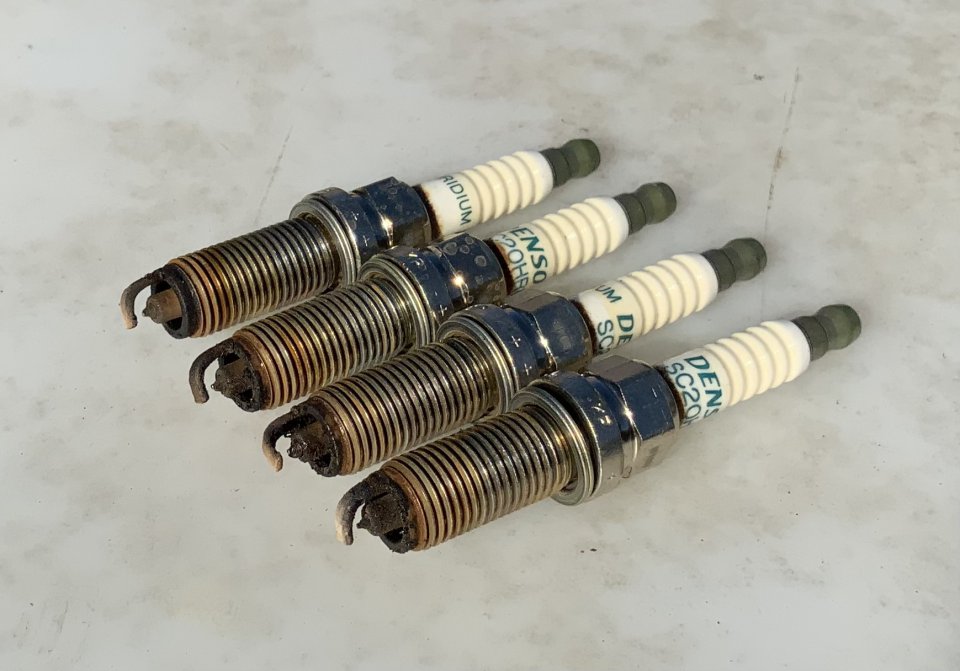

    The car was misfiring upon starting. So I decided to change the spark plug in my 2012 Gen 3 Prius. It has 250,000 miles and the spark plugs had not been changed. I got everything apart and put the new plugs in. I got side tracked and went back and started the car. In ran incredibly bad. After searching for potential problems it occurred to me that I had not put the coils back onto all but one of the spark plugs. After doing so, the car ran quite smoothly. I have not had any further problems. I ran a health check on the car and it has several codes relating to this situation. P0351 P0352 P0353 Ignition Coil A, B C. Primary/Secondary Circuit Permanent and P3190 Poor Engine Power. I can not clear the codes. With the knowledge that the car is running fine, is there any repair or procedure that is necessary? I have included a picture of the spark plugs that may add incite to the situation. Thanks so much … Vegg
