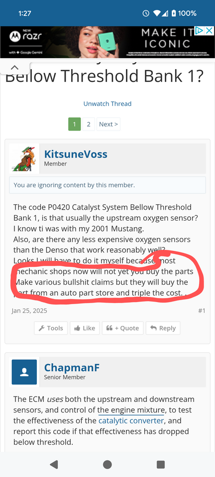

  4. KitsuneVoss
    KitsuneVoss Member
    Nov 13, 2022
    376
    55
    Virginia
    A minor update. My oil was low when I checked the dipstick a little while back, likely at least two weeks back although maybe even three weeks. I did not check afterwards but likely added about two quarts. Likely driven anywhere between 700 and 1050 miles between then and now. Checked it just now and the oil level is still pretty high so I don't think the engine is burning excess oil.
    Have not interrogated the computer yet. Have so many things on my plate that I often lose track of things.
  5. KitsuneVoss
    KitsuneVoss Member
    Nov 13, 2022
    376
    55
    Virginia
    Some minor updates and questions. I have a new catalytic converter I got from Rock Auto. Figured more trustworthy than eBay and decided to order it before tariffs make prices go insane.
    I do know of an old man who used to work on exhaust systems. He was cheap but did a good job. He is a short "Prius" distance from home even though I moved. Figure check if his shop is still where it was. If I can get him to weld it, should I?
    Also, if I remove it myself, I know someone who welds. In such a case, would I be better off getting it welded by him or better off clamping it? Concerned that if the fitting is not perfect and welded, might not fit?
    Also, if I end up doing it myself, I have a grinder. Would that work for cutting the pipe or would I be better off getting a reciprocating saw as is used in this video at the 7:00 mark?
    Also, I want to clean the intake system a bit. I was thinking about spraying to down at least real well with throttle body cleaner. I have removed throttle bodies in other cars to clean them but would prefer to wait on that. There is a video where the person did not want to push on the throttle body to get the underside. Is that an actual concern?
  6. KitsuneVoss
    KitsuneVoss Member
    Nov 13, 2022
    376
    55
    Virginia
    Update: I ended up going to a shop to get the catalytic converter replaced. Ed's Muffler Shop if interested.
    It is the older person I mentioned last post and has been around for I think decades.
    Charged me $100, so not bad.
    #26 KitsuneVoss, May 5, 2025
    saneesh8 likes this.

  8. KitsuneVoss
    KitsuneVoss Member
    Nov 13, 2022
    376
    55
    Virginia
    I don't know but will post an update in a little bit (few days to a few weeks.)
    At the shop, Ed's Muffler shops in Chesapeake VA, Ed did say that the O2 sensor in the cat looks good. he said that usually bad ones look black and/or scorched . Doesn't sound like he works on hybrids often but has DECADES of experience. I went to his shop for repairs first likely 20 years ago and I think he was long there already. He likely has more experience with O2 sensors than almost everyone on this board combined.
    Edit: One local shop quoted me that it could be up to around $300.
    #28 KitsuneVoss, May 5, 2025
