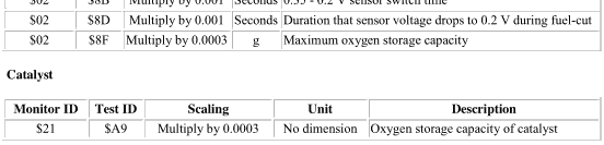

    That's kind of a good question. Mode 6 monitor results have a field that reports the measurement unit, so the scan tool can show it, but what $21:$A9 reports for its unit is "no dimension". I used to think it might be seconds, like, the length of time it takes for the O₂ reading to go rich after enriching the mixture.
    Only I'm just now noticing for the first time that among the Heated O₂ Sensor monitor tests just above, there is also a test ID $8F giving "maximum oxygen storage capacity", and that one lists g as its measurement unit. The scaling factor is the same as for $21:$A9.
    I have never looked at that one. Maybe something new to investigate. I know I've wondered in the past why the "min" threshold for $21:$A9 doesn't seem to be a constant. Now I'm wondering if it's somehow related to the result of $02:$8F....
