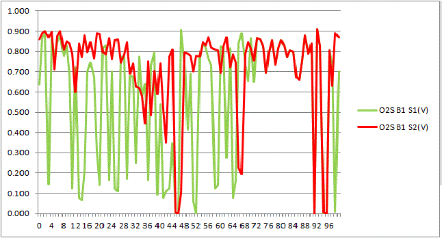

    The P0420 hasn't come back since clearing the code 150 miles or so ago. However any thoughts on the O2 readings I got tonight, thinking about replacing the sensors. I have been monitoring the O2 performance and besides the voltage on the downstream sensor seeming to wander a bit, I captured about 2 minutes where the two sensors fell into line which I don't quite understand. These readings were started after about 15minutes of full speed highway driving and the first 80% are around 60mph with the last 20% of readings as we slowed down to get off the highway around 40mph.

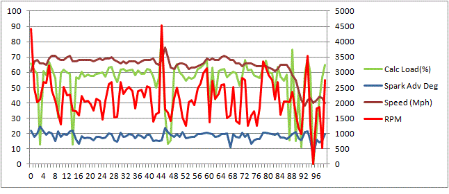

    Also I have the other 15 or so measurements over this same 10 minute window covered by this data if anyone has a recommendation bout anything else I should be looking at. Car was idling pretty rough upon starting but once it gets warmed up we don't notice any issues, power or otherwise.

    1. Regarding the rough idle, when was the last time the iridium spark plugs were replaced?
    2. The B1S2 sensor, which is downstream from the catalytic converter, should show relatively constant voltage readings compared to the B1S1 sensor which should show big swings in voltage as the engine air/fuel mixture swings back and forth from rich to lean continually. The B1S2 constant readings would indicate that the catalytic converter is doing its job of changing hydrocarbons and carbon monoxide in the exhaust to water vapor and carbon dioxide. To the extent that B1S2 follows along with B1S1, that is evidence that the catalytic converter is not doing its job.
  3. bwilson4web
    29,112
    16,553
    I agree with Patrick although I see enough variability in the second O{2} sensor that the catalytic converter looks OK. I am a little curious about the drop out of the first O{2} sensor in the recorded data. Perhaps it is time to check the connectors?
    The O{2} sensors are critical for fuel trim. If one is intermittent, I would work to get it (or both) replaced before the more expensive catalytic converter exchange. One 'shade tree' mechanic trick is to swap the O{2} sensors, front and back. This not only reseats the connectors but also gives a chance to check their external appearance.
    One thing I would be interested in would be any carbon on the front sensor. This would suggest mixture has been running rich.

    On O2 sensors ya if the cat wasn't absorbing anything I was expecting them to mirror each other, just not intermittently in relatively stable driving conditions at ~60mph. I will plan this weekend to try what you are suggesting and make a visual inspection of the front sensor and try swapping them.

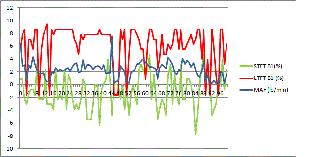

    In terms of fuel trim, the data pulled over that same drive time is as follows; and I am a novice, but I thought LTFT was essentially a moving average of STFT, so I was a bit surprised STFT was sitting around 0 while LTFT is sitting solidly on the positive side.

    If you are going to the trouble of removing the B1S1 sensor, I suggest that you actually replace it with a correct new Toyota part (not some generic). The reason for my suggestion is that if you are lucky, you may find that replacing B1S1 will allow the catalytic converter to continue to function sufficiently well enough so that DTC P0420 will go away.
    The engine ECU depends upon B1S1 to provide feedback regarding air/fuel mixture so that the ECU knows when to swing between a rich mixture and lean. If B1S1 is marginal, the ECU will take longer to move from rich to lean, which results in more emissions being produced and therefore more work for the catalytic converter.
    For the same reason, if the spark plugs are marginal, then they should be replaced with the correct iridium NGK or Denso plugs (as specified in the owner's manual.) The spark igniters should be cleaned and examined for damage such as burn marks, cracks, rust deposits, and corrosion on the electrical contacts. Replace if needed. If the engine is not misfiring, then there will be less HC being produced which needs to be catalyzed.

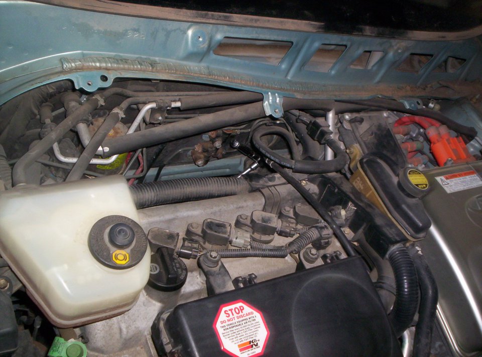

    You're correct. I was able to remove the upstream O2 sensor after removing the wiper cowl. I also removed the throttle cable bracket (in the way) and the exhaust manifold heat shield (moved it slightly away from the sensor) to be able to get a crows foot socket on the sensor. Please note that this is still a very tight access. I'm awaiting a new sensor.

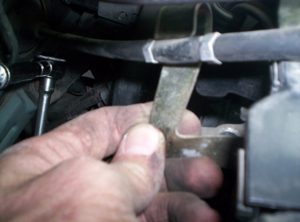

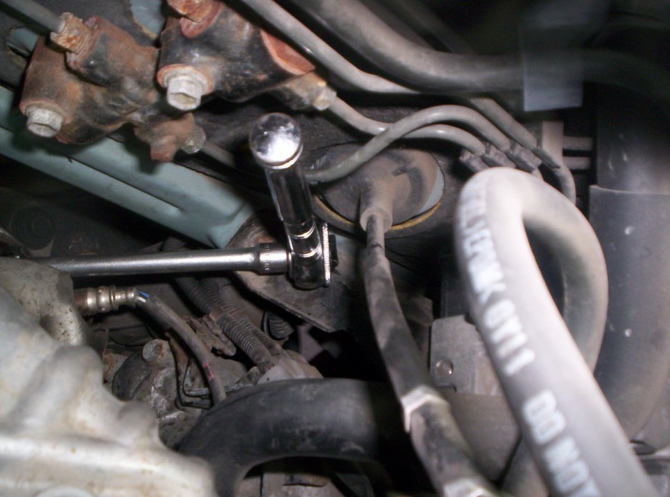

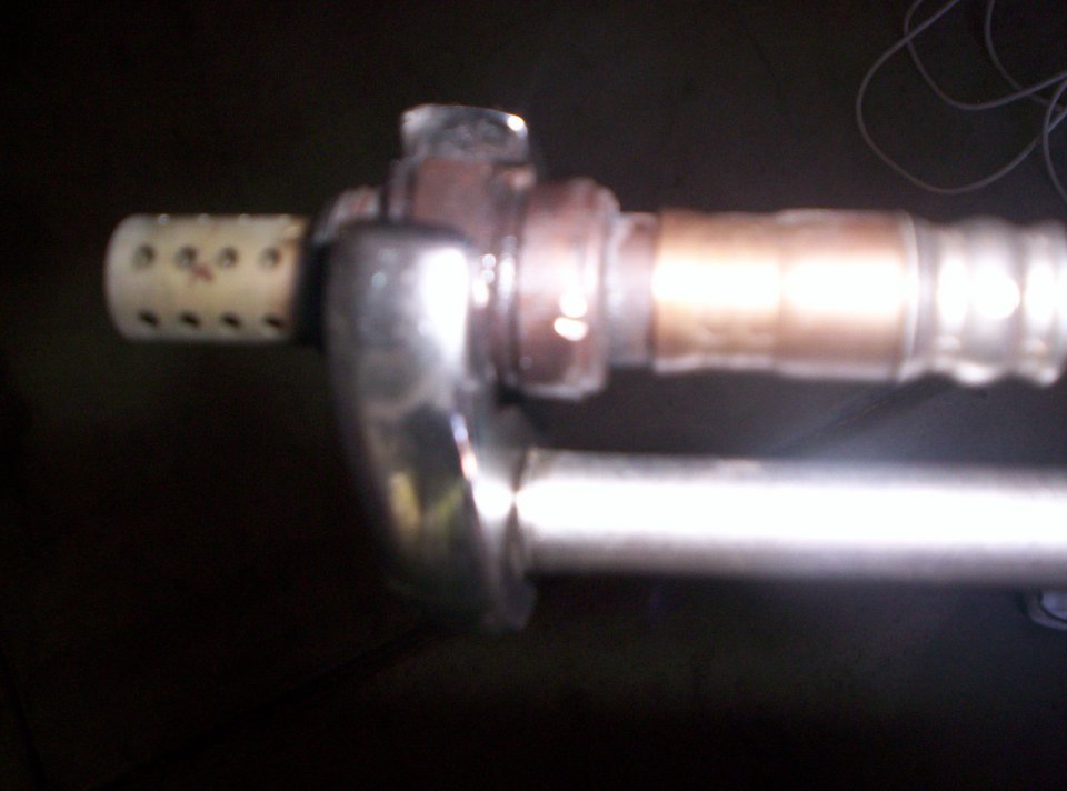

    The chain parts stores and some online Toyota parts stores indicated the 234-4623 was for both applications, hence my original question. I also ordered a new Denso 234-4624 from Pyramid Auto Parts on ebay at very discounted prices.
    Note: Recommend dousing any rusty bolts and the base of old sensor with Zep 45 or other nut buster a couple of times and let it sit for a while to try and avoid breaking off bolt heads. If there is an O2 sensor socket available, you may not have to move the manifold heat shield. This is also a good time to clean things up and treat any surface rust on parts (no thanks to road salts), and to change the spark plugs if it's close to that time. I removed the K&N air filter after 9 years. I'm now recommending quality OE type filters as a precaution to keep air clean and more oil free in the intake/emissions downstream.
    I'll come back if there is any thing to report after installing new sensor.

    Upstream O2 sensor installation went well. P0420 returned after a few trips. Next step - replace the cat.
