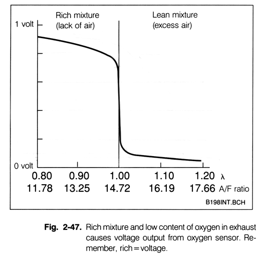

    Interesting point of view, but looking the article below, it looks like my Prius A/F is OK between 3 and 3.5V
    The O2 sensor 2 is showing LEAN in throttle
    From Google: The greater the difference, the higher the voltage reading. An oxygen sensor will typically generate up to about 0.9 volts when the fuel mixture is rich and there is little unburned oxygen in the exhaust. When the mixture is lean, the sensor's output voltage will drop down to about 0.1 volts.
    Please let me know if I'm getting something wrong
    It looks like my sensors are showing LEAN and LEAN

    I'd take a closer look at the O2 sensors. The front in particular seems to be alternating between a normal'ish range with ~.6V swings, and much smaller ~.2V-.4V swings. The graph of narrow band O2 sensor voltage on this page shows swings that are far more consistent than what your graph shows. The graphs of downstream O2 sensors also look more consistent than what you're seeing, which could be from the upstream sensor going sideways.
    https://www.discountconverter.com/tech-tips/news_page.cfm?Key=catalytic_converter-&News=218
    Also, a new narrow band O2 sensor is a lot less expensive than a new cat. You can get temporary operating permits from the DMV is need be. I think the max is 2 months or so. You can PNO it and get a 1-day moving permit for smog after you fix it. For what it's worth, I have 3 Toyota's with ~700k miles combined and I've never had to replace a cat converter.

    Was specifically referring to WB voltages in my earlier post.
    For reference, typical BOSCH NB O2 sensors respond as ALX suggests.
