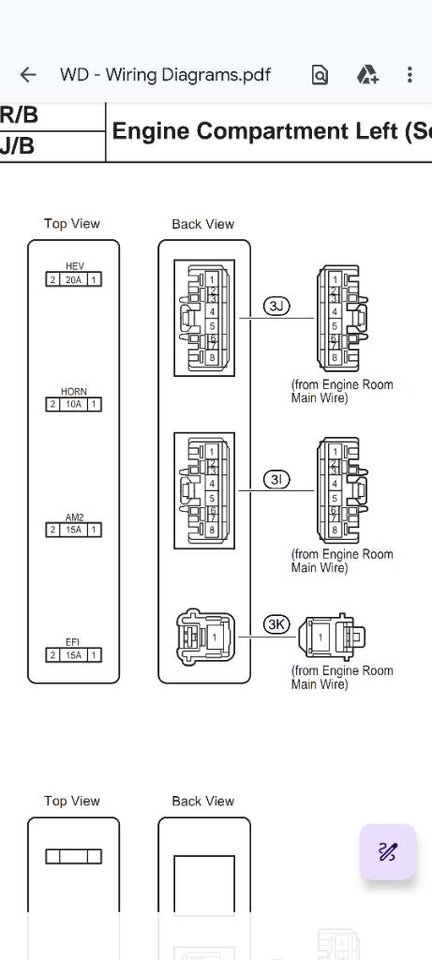

    So, you should google "how to backprobe a connector". This can show how to get a good voltage reading without damaging the terminal.
    If you do not have 12V "battery voltage" at the red wire for E7-6, then you have an open circuit somewhere. You need to physically inspect the wire harness from the ECM back through the firewall, to the engine fusebox.
    The wiring diagram shows a single wire from connector 3I-5 all the way to the ECM. 3I is on the bottom of "unit B" inside the engine fuse box.
    If you have confirmed power at both legs of EFI fuse, then I would check for 12V at 3I-5.
    Sometimes I consider running a new - separate wire (called an overlay) to bypass a faulty circuit, but I usually want to find the point of failure. There could be damage to other wires as well.

    I was able to get a better back probe of terminal e7-6 and I’m getting 3.5 volts. There’s no obvious sign of wire damage around or behind the ecm or along the firewall but visual inspection is limited. Would removing the wiper cowl allow better access to the harness? How difficult is it to inspect connector 3I on the back of the fuse box? It looks like removing a couple screws will allow it to pivot up.

    3I is on the bottom of one narrow, removable, four-fuse module in the fusebox. You spread some clips apart and that module lifts right out, and the wires plugged into 3I, 3J, and 3K come right up with it so you can access those plugs. No need to take apart the fusebox itself.

    Another update. I attempted removing the C module in the fuse box but could not get it to come out enough to inspect the connectors. I pulled the B module beside it out some but that didn’t help. I checked the E7-6 voltage many times while moving the module and the harness around but it stayed steady around 1 volt. I don’t think the issue is at the 3I connector since moving it around should have made the voltage worse or better. I did notice the voltage dropped to 0.5 after removing and replacing the EFI fuse and then slowly increased to a little over 1 volt, which was strange. The only part of the harness I can’t see is on the drivers side behind the inverter so I think my next step is to remove the cowl.

    Ok I tried again and got the C module out enough to take the 3I connector off. There’s nothing wrong with the connector or the wires underneath the module. The voltage on the output of the C module is good. I suspect the problem is in the harness along the firewall somewhere.
