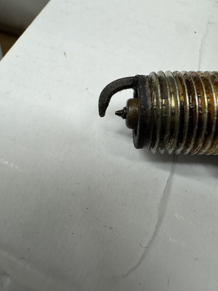

    thanks for the advice, will leave the 05 inverter in place. as a reward for finally getting this car going i pulled the plugs to see if it might need new ones... 0.062" gap!! 200k miles on it, felt like they'd never been out as i had to work them back and forth along with penetrating oil in the bore. they all came without damage but were very stubborn. NGK BKR5EIX-11 ... i don't THINK that is OE so they must've been changed once. check out the gap in the attached photo!

    They came in at 044 somewhere around that so they were 20 thou out

    The plugs specified in the manual are:
    • DENSO SK16R11
    • NGK --- IFR5A11
    I believe the Denso might have be superseded, I'm not sure about the NGK.
