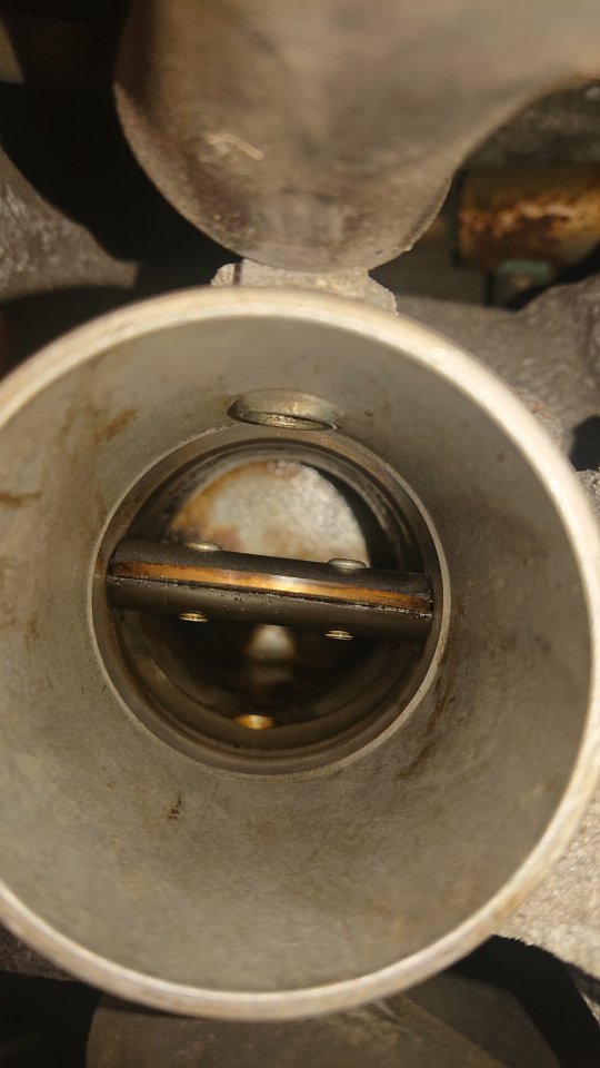

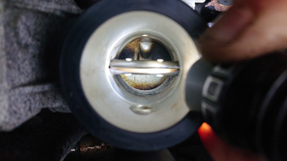

    One of the common causes is that normal carbon - goop deposits build up in the throttle body where the blade (flap) is. You want to clean that goop off the blade and the bore. I get throttle body cleaner, spray a bunch on a clean rag, then use that to "scrub" the deposits off while hold the blade fully open.

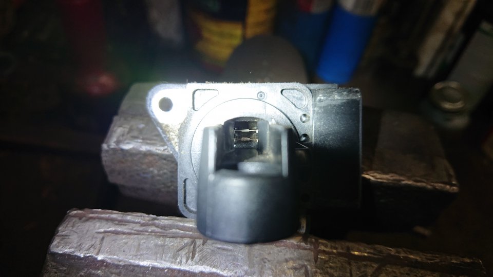

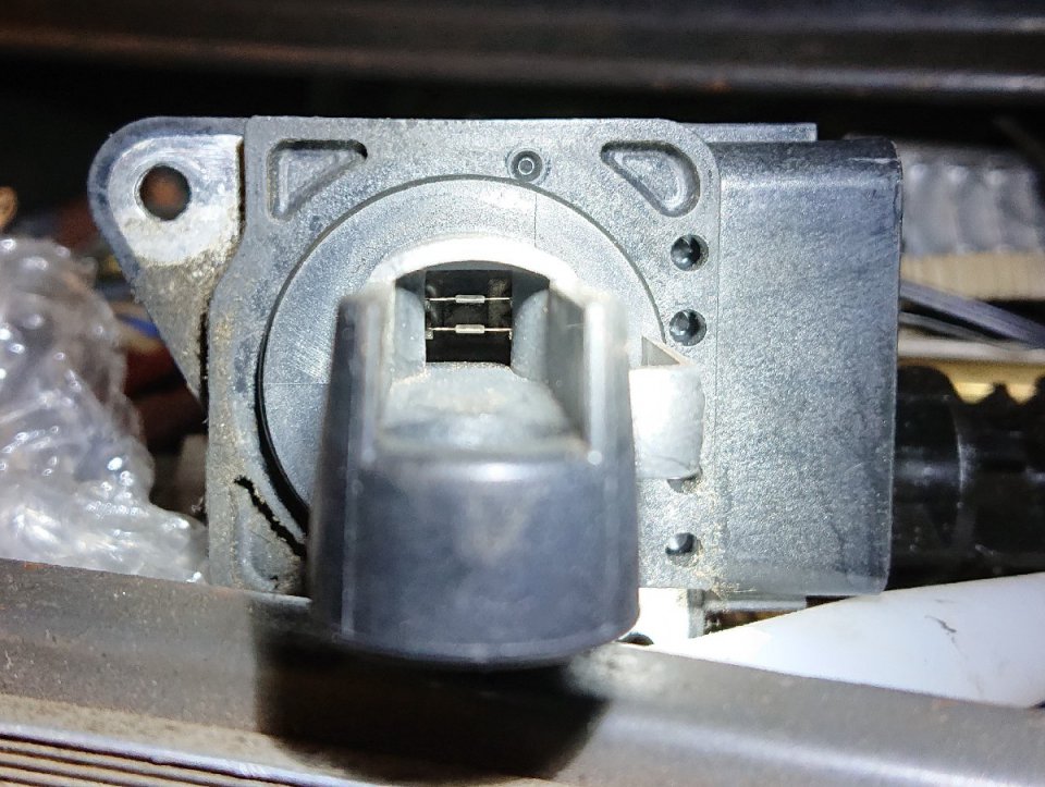

    Also you want to remove the Mass AirFlow sensor from the filter housing and carefully clean the 2 sensing elements that are recessed in a passage on the end of the sensor.

    DSC_3225.JPG Here's a pic of the MAF sensing elements and TB bore with the blade open. DSC_7605.JPG

    After cleaning. It's normal to have (some) oil pooled in the intake manifold on a Prius. DSC_2006priusTB.JPG DSC_3737_2.JPG
