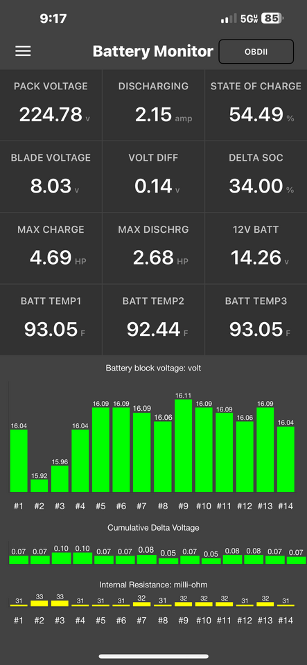

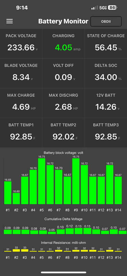

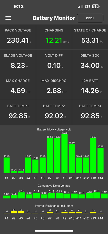

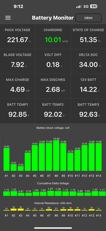

    IMG_7372.png IMG_7652.png IMG_7655.png IMG_7660.png IMG_7668.png IMG_7672.png So this last week my wife’s Prius had the check engine light (as well as a few other lights on the dash) pop up as she backed out of the driveway. Car is a 2012 with 200k and for what it’s worth it was 98 degrees out when it happened. I got home yesterday and scanned the car and am seeing P0A80. In other post I have seen people who get this code usually also get a message check hybrid system or something of the such pop up but hers never did that. I tested the 12v and it tested 12.42v. I cranked the car and it ran for awhile all like normal and the meter on the dash showed that the hybrid battery was indeed charging up while the engine ran. I took a few screenshots in Dr Prius hoping it would be of some benefit. The numbers seemed to fluctuate so I posted a couple. I plan to plug up techstream tomorrow to see if it can give me some more info. The car still gets good gas mileage and I have a prolong hybrid charger but have never used it on this car. Can anyone tell from these screenshots if there are any problematic cells that needs to be replaced first before using the prolong?
  2. Brian1954
    Brian1954 Senior Member
    Jan 31, 2021
    2,688
    1,073
    South Central PA, USA
    I think that the hybrid battery modules are okay based on the Dr Prius screenshots that you uploaded. The main problem is that the Delta SOC (state of charge) is 34.0%. What that means is that the battery modules are not balanced to each other. When that happens, the voltage difference between the battery blocks (two battery modules= one battery block) becomes large enough to trigger the P0A80 code during high current flow through the battery. A healthy balanced battery has a 0.00% Delta SOC.
    To balance the battery modules to each other, you need to use the Prolong grid charger to top balance the battery pack. Follow the instructions on Hybrid Automotive's website. Going from memory, you want to charge for 20 to 24 hours. Take note about the maximum ambient temperature in the instructions. Also, make sure you let the battery burn off the extra voltage in the battery by letting it rest fot 4 to 5 hours before starting the car.
    After doing this, monitor the Delta SOC of the battery for the next few weeks and then every month or so. When the Delta SOC starts increasing again, use the Prolong charger again. Hopefully, you can go 6 or more months between charges.

    Your screenshots show voltage values while the battery is being charged or a very small discharge. This hides a lot of problems. Your best condition evaluation will be performed when the battery is being discharged a bit heavier. You can do that by completely warming up the car, then running the AC on full blast while monitoring voltages. This way the car engine will stay off until the HV battery reaches 40% ish or a weak module shows itself and it needs to start for battery charging. Rarely ever can a good evaluation be performed of the modules when the HV battery is under charge conditions.
    Another question is about how long does the car sit unused? At that age and mileage, assuming the original battery, sometimes even sitting over a weekend unused will allow a weak module to self-discharge enough to drop the indicator to 2 or 1 purple bars. The good thing is they will usually charge back up, and as long as the car is used frequently, you'll never notice a problem.

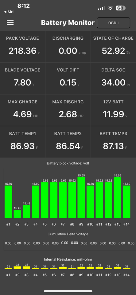

    All those Dr. Prius screenshots were taken with the battery charging or with a very slight discharge @ high SOC, outside of the delta SOC reading the rest of it isn't very useful.
    After it sat overnight and before starting the car, turn the ignition to ON, ready mode off by not holding the brake while powering on the car take a screenshot of the battery voltages. This will give us some idea of the self discharge of your battery.
    Start the car, let it warm up until the engine shuts down. Turn on the A/C on the coldest setting and fan on high, turn on the headlights including high beams, engage the parking brake and put the car in reverse, make sure it holds. This will put a 10-15 amp load on the hybrid battery, keep it there and continue to take screenshots. Post only the last screenshot you took before the engine restarted and began charging the battery. This will give us some idea of how the battery performs under a light load @ low SOC.

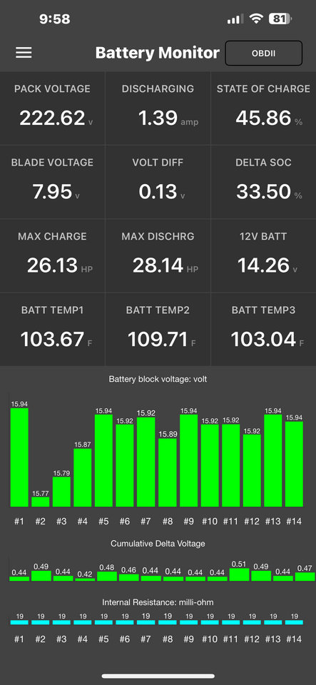

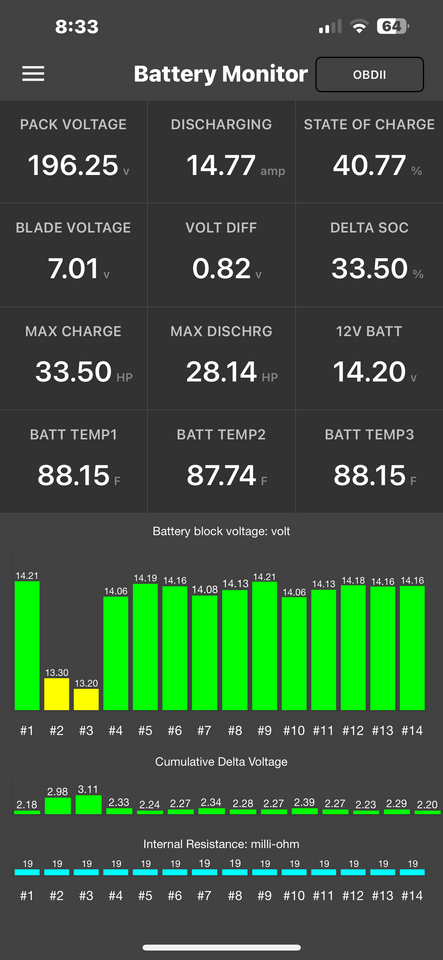

    So the first photo taken at 8:12pm is when I first started the car and shows the battery after it has set unstarted for 24hrs. The second photo was taken right before the ice engine kicked on to recharge the hybrid battery after running the air/lights/in reverse for a couple of mins.
    bars as the battery charges up. The last phto i overnight.PNG before engine.PNG

    If this was my car, I would do the following:
    (1) Remove the top metal cover above the battery pack.
    (2) Module pairs #2 and #3, measure the voltage of the individual modules. It is possible that just one module of the pair is the weak one. Cycle this module two times with a hobby charger. If both are weak, cycle both.
    (3) Now do the Prolong method.
    (4) Now do a test drive. While logging the pack voltages, do a full throttle acceleration from a dead stop. A healthy pack will deliver 150 amps. Weak modules will clearly be seen while doing this.

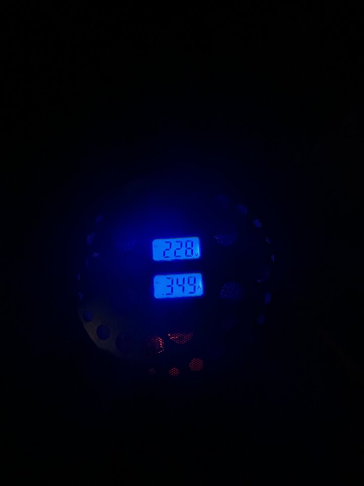

    Started the charging process last night about 9pm and its started the volts at 214v and ramped up to the highest i saw 237v and has been slowly coming down. Sat at 235v for a good while and thought about disconnecting but then started to switch between 234-235 so i have let it continue. It has now been at 233v for an hour maybe hour in a half. Just want to make sure it is fully balanced before turning it off, but overall i guess about 18hrs on the charger. last night and most of the morning it was nice and cool but is 89 degrees out right now but i have the doors open and have an idustrial fan blowing on everything plus the charger forces the cars fan to run. At 4pm if it is still at 233v I think I will take it off the charger, wait awhile before driving or cranking and then retest the battery this evening

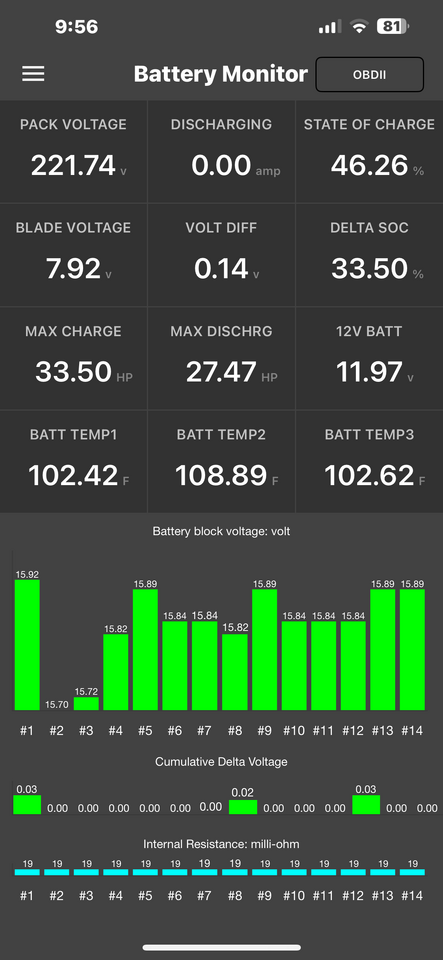

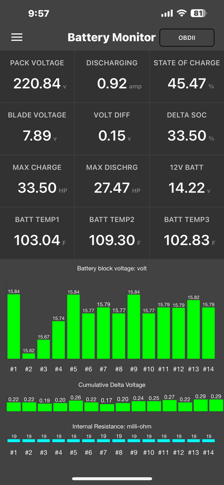

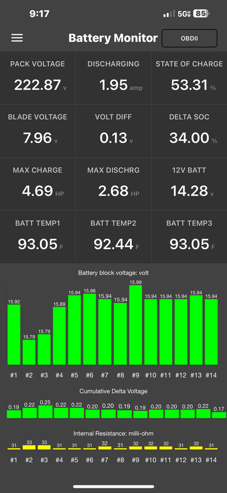

    Update: so after charging the hybrid battery with the prolong overnight I let it rest for about 5 hrs before starting it. The first screenshot (taken at 9:56pm in corner of the screen) is actually before I put it in ready mode, just hitting the start button twice with my foot off the brake to connect Dr Prius and get a base line. The next two images (taken at 9:57/9:58pm on the screen) are after I put it in ready mode and the ice engine ran for a min or two to warm up. No check engine lights popped up but my Delta state of charge appears to have not changed unfortunantly. Im not sure why state of charge is showing only 45-46% when the battery had been charging up all night? So at this point should I be looking at a few new modules to repair the pack and anything special I need to look for when buying units, i see a few ebay sellers that have sold thousands with good reviews. Thanks so much for your help guys

    The car needs to be driven for a while for the hybrid ECU to recalculate everything. So, drive the car for a day or two and then check again.

    Looking at your data, modules # 3,4,5 are the problem. Your options are as follows:
    (1) Replace the three modules. Doing this task for the very first time will consume an entire afternoon.
    (2) Deep cycle the three modules. This involves attaching the cycler leads to the module, pushing a few buttons on the cycler, and walking away. When you need to use the vehicle, remove 1200ma from that fully charged module. Module should be approx .1v higher than other modules in the pack.
    Note the attached chart, showing what cycling does to module capacity.
