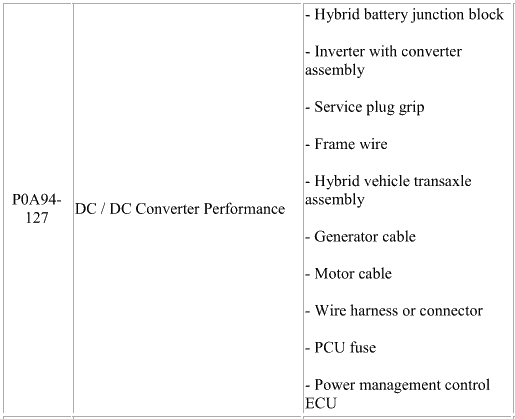

    When a Prius stops running and throws a hybrid code, you want to get a code reader and read that code. There are more than a hundred possibilities, and they are not all cataclysmic. If you're not sure whether to believe me or rjparker, take a glance in the repair manual and start counting.
    Even narrowed down to the main code P0A94, that code happens to be one with seventeen different subcodes that a good code reader can retrieve. Taking as an example just the first of those possible subcodes (127), you can see there are a bunch of possible trouble areas that could be causing it:
    This is why repair technicians have not all been replaced by robots that read trouble codes and blindly replace parts. There has to be somebody who looks at that code, goes to the car with some meters and tools, follows the troubleshooting steps in the manual, finds out what is causing the code, and then fixes that.
    If that turns out to be the inverter, by all means, replace the inverter. If that isn't the inverter, replacing the inverter will be quite the expensive way to not fix the problem.
    It all boils down to somebody finding out what the problem is, first.
