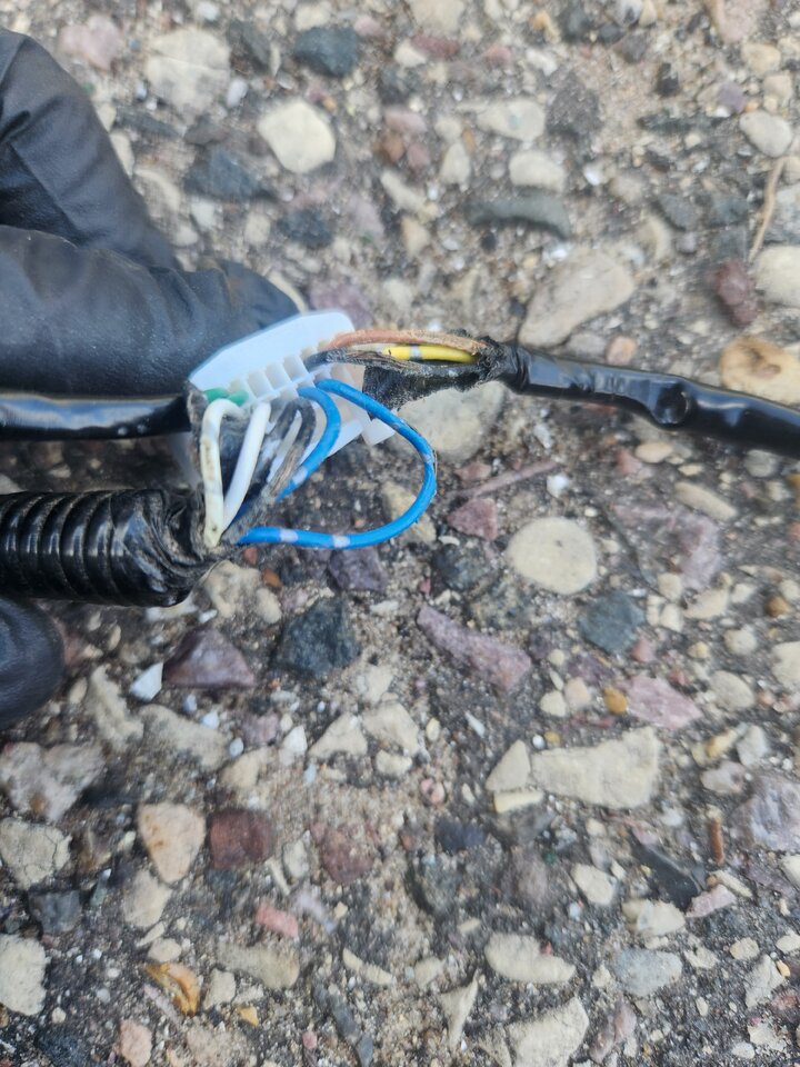

    You can actually buy the temperature sensor separately.
    It takes quite a bit of work to remove the battery and dismantle it enough to swap out the temperature sensor assembly.
    Not especially hard but lots of nuts and bolts. You have to remove all the modules from the case since the sensors attach to the bottom side of the modules.
    Here is an example of a chewed up wire harness. Sometimes of you are lucky it is simply dislodged rather than damaged.
    But you'll need to open up the pack to repair it.
