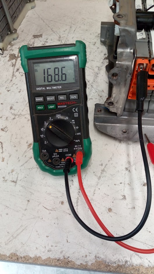

    Try to not kill yourself. This is not a project to undertake without a thorough understanding of the battery.
    You need to be very clear about that a high voltage leak means the battery case is a live part of the circuit.
    This reading was taken from a leaking Gen 1 battery.
    The battery will have high voltage present until all the bus bars are removed from one side. Once all the bus bars are removed leaks can be often be found with just a voltmeter. Measure between the case and every module terminal. Leaks can be intermittent. If the battery has sat for months the leaked electrolyte can dry up and break the voltage path.
    Be very careful.
