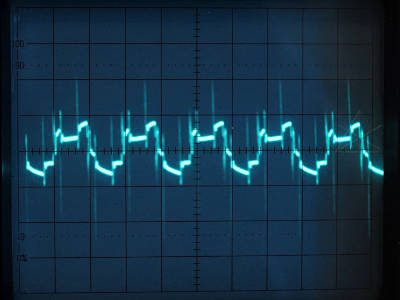

    As for what gets seen to set the code: the high voltage supplied by the battery is nominally DC (would look like a straight line on a 'scope).
    The battery ECU generates a weird wiggly wave to superimpose on that:
    When the high-voltage system is properly isolated, the battery ECU should not be able to recognize that waveform showing up between the regular 12 volt system and body ground. If it shows up there, that's a problem.
    The car decides whether to say 611, 612, 613, or 614 by paying extra attention next time it starts up if there's a 526. If the wave is already showing up before the battery's even connected, it has to be in the battery (612). If it doesn't show up until the car is made READY, but before sending any power to the transaxle, 614. If it doesn't show up until power goes to the transaxle, 613. If it only shows up when running the A/C compressor, 611.
    Gen 1 didn't have those fancy INF codes yet, but you could pretty much use that same procedure yourself to figure out where the fault is.
    In a scan tool that shows live data, there's a "short wave" item you can look at to see how strongly that wave is showing up.
    Funny translation glitch ... most English speakers would see "short wave" and think of radios and listening to Czech operas or something, but I'm pretty sure all Toyota meant was it's a wave ... that the car uses ... to check for a short.
