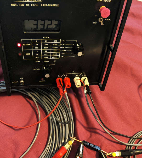

    Yes, 0.4 to 0.7 Ω is too high for a couple feet of heavy wire. But normally, when you're testing something like that with a general-purpose ohmmeter, your reading ends up being more about your test leads and how clean the surfaces are where you put the probe tips, than it is about the resistance of the thing you meant to measure.
    A milli- or micro-ohmmeter made for measuring such low resistances will have a four-wire connection, to make sure it can cancel out those lead and contact resistance effects.
