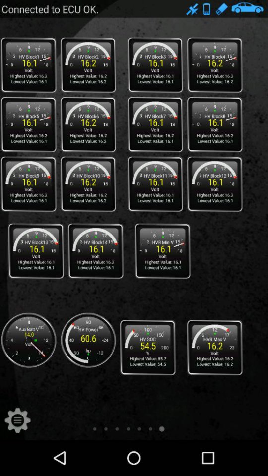

    Getting code P0AC2, red triangle, VSC, and some abs codes.
    Some tell me I need a new HV battery. I tried using torque as pictured to see if I could narrow down which blocks are bad but all seem to be very similar.
    Anyone had this issue/code before or any input as to what I should try next.
    I really appreciate any help!

    P0AC2 has nothing to do with module blocks. This code is : Hybrid Battery Pack Current Sensor Circuit High
    Potential Causes:
    HV battery assembly (wiring harness or connector)
    Battery current sensor
    Battery ECU
    As asked previously, has this battery been worked on recently or is it virgin?
    I would venture either the plug has backed out of the current sensor (located in the battery pack), the current sensor is going bad, or the ecu is having some issues. Clear up this issue and the other fault lights will go away.
