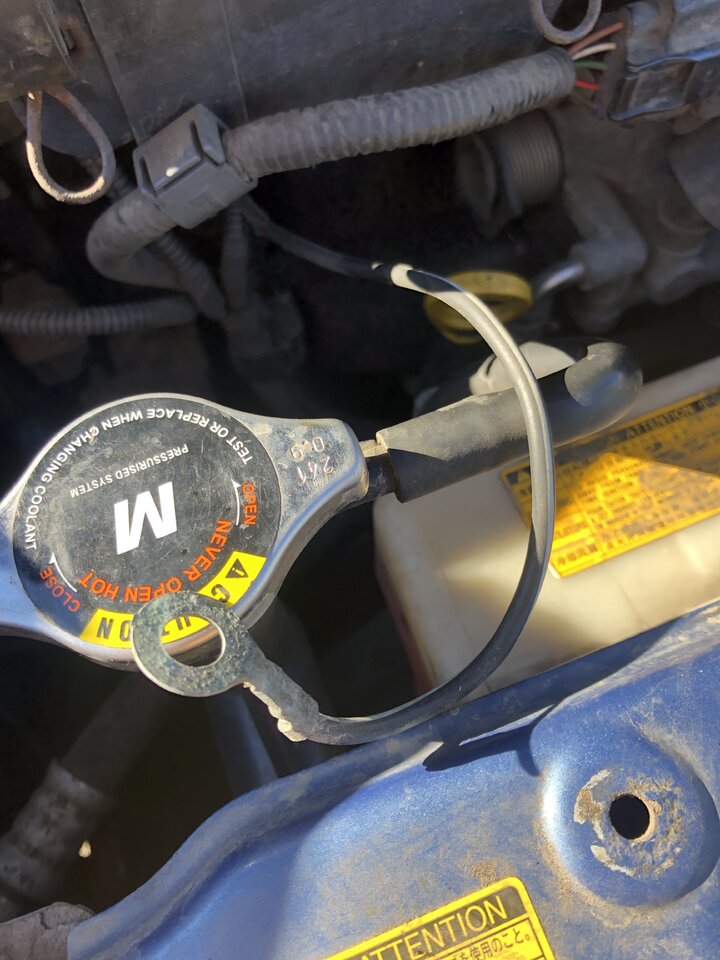

    The loose wire is an engine "ground". The ring terminal should be attached to the body somewhere near the radiator.

    The loose wire is an engine "ground". The ring terminal should be attached to the body sheetmetal somewhere near the radiator.
