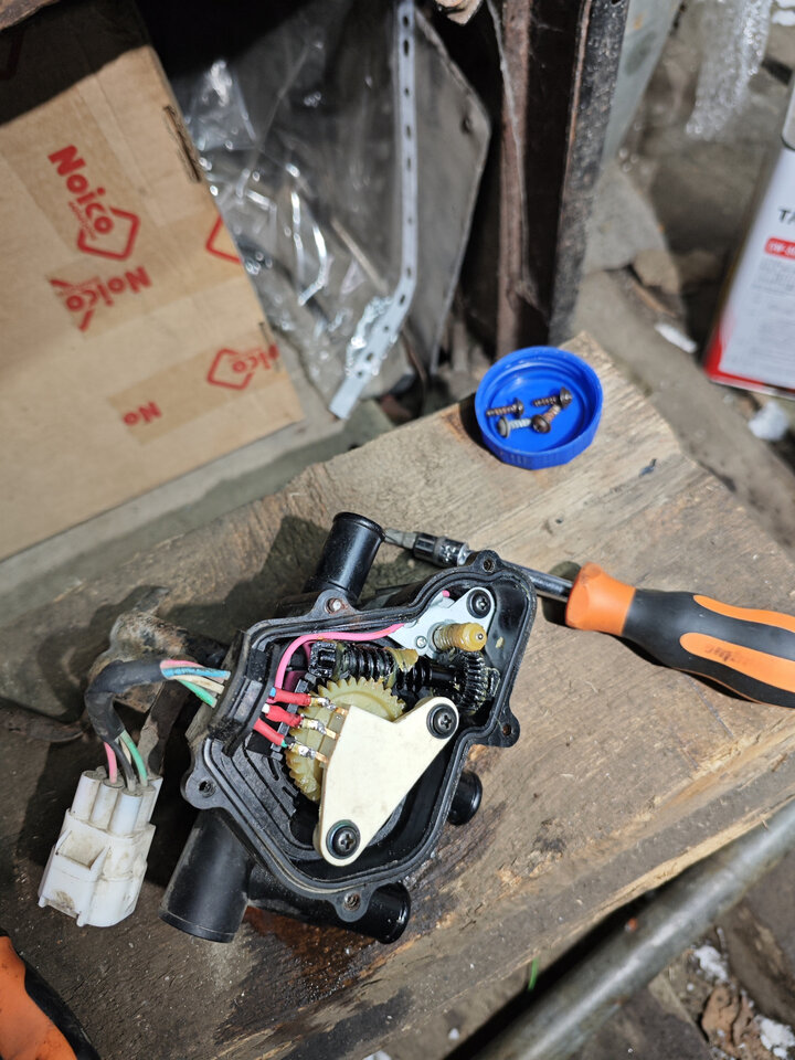

    The small potentiometer in the three-way valve breaks down.
    You can replace it yourself by disassembling the valve. This will save you a hundred dollars.
    TOCOS RVQ121 Ceramic Potentiometer 12V 502 5K with Plate PPS-GF40 360 1PC | eBay
    eluo and JC91006 like this.

    A three-way faucet has a motor, a worm gear, and a potentiometer that provides feedback to stop the motor when the desired rotation angle is reached. If the potentiometer tracks are worn, the incorrect resistance reading will cause the faucet motor to rotate or stop in the wrong position.
    The price RVQ121 on other sites may be less than $7 or $8
