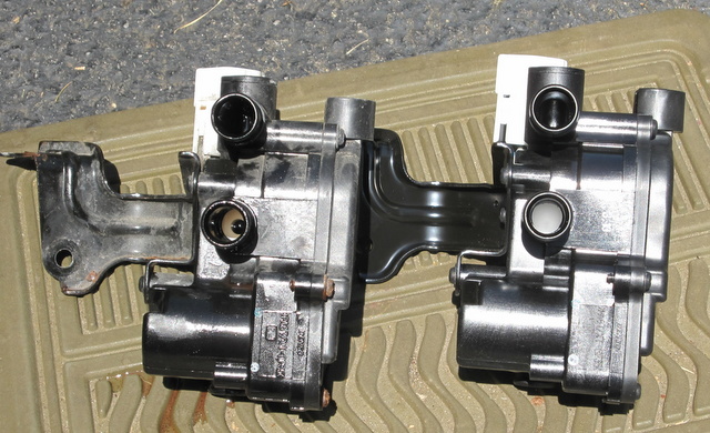

    I did this repair just recently. Thanks to all for all the tips, it really made things easier. I elected to move the inverter a few inches, without disconnecting anything, to gain access to the valve.
    I was curious to see why the valve had failed. I applied 12v to the motor and the valve turned, so I suspected the sensor. I took the sensor apart and found a dead spot on the resistance element. It looks like once the sensor starts to go bad the car will move the valve back and forth to try and hit the correct position, wearing out the sensor more quickly. You can see the dead spot on this picture.

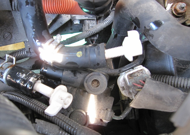

    Plug off the hoses with...(wait for it) wine corks! They fit perfectly. I also found some smaller corks for the valve itself. (see pic)

    You can see in the picture of the old valve how the interior white gate has gotten stuck halfway.

    I did it basically as outlined by redwald. Marked the top hose with a zip tie, and used those rubber stoppers instead of corks. Also used a cable driven hose clamp tool. However, these issues were encountered:
    1. The rubber stoppers worked great for the hoses but they were bad for jamming into the plastic outlets. They would go in and stop the flow, but the slightest bump and they would pop right out again. Apparently the interface between the rubber stoppers and the slick plastic was, well, just too slick. Not enough friction to hold them in well.
