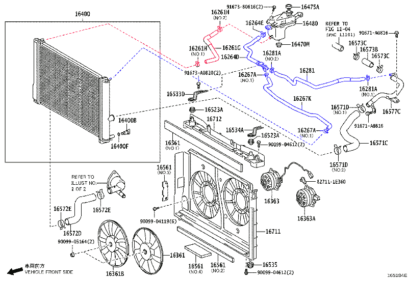

    It seems to me that people make a much bigger deal of burping the cooling system than is really warranted. It might be blending in people's minds with what they know about brake bleeding (where small bubbles can get stuck indefinitely and interfere with braking) or human circulation (where a bubble in the bloodstream can stop circulation because the heart pumps by pulsing).
    The engine's water pump doesn't pump by pulsing, it moves a steady stream of water that can carry bubbles through the system, and the hoses shown in blue here collect any bubbles constantly from high points in the system and deliver them to the top of the degas bottle where they belong. That's, in fact, what does most of the work for you after your initial fill, when you run the engine up to operating temp and let it run several minutes.
    As long as you had the bottle filled to B when you started, and the level dropped all the way to F after cooling when you were done, you're good.
