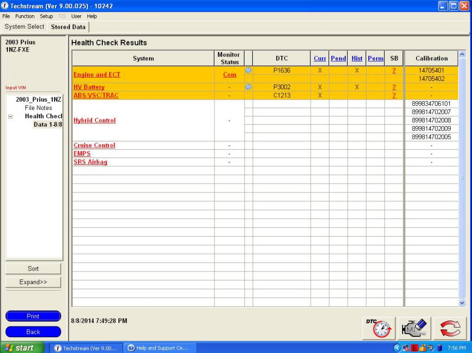

    Three Code P3002 P1636 C1213

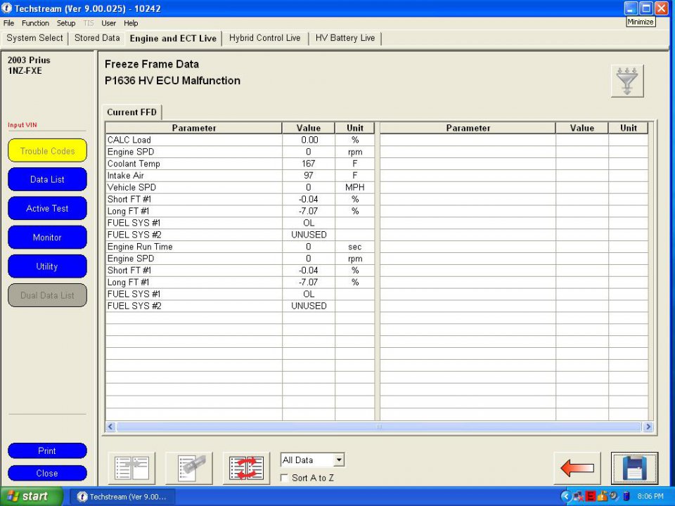

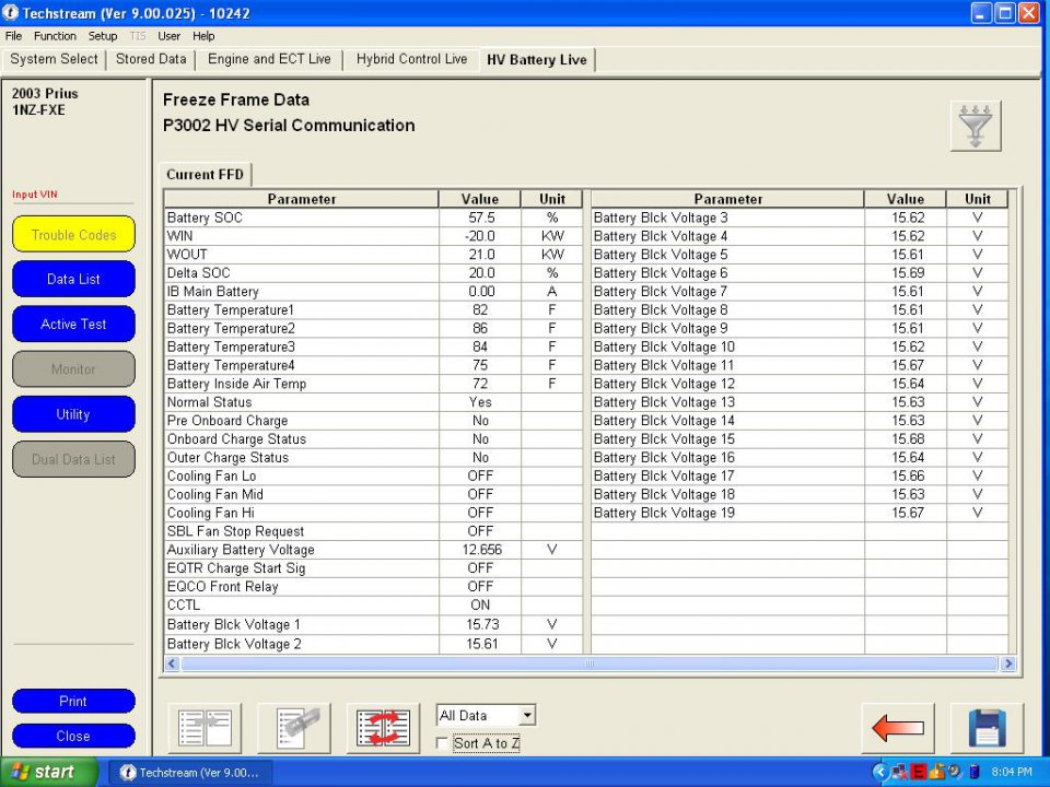

    Freez frame data attached (no C1213 FF data )

    All codes still active, if you need any more details pls write the techstreem steps so I can pull and post. Thanks.

    This may be a little tricky because I need a URL to identify an image and these are attachments to another post. Let's get started:
    • P1636 - When communications with HV ECU is interupted for 1.5 seconds or more. Ambiguity group:
      • Wire harness
      • HV ECU
      • ECM (Engine Control Module)
    • Signals HTE+ and HTE-, a private communications link, two wires between the HV ECU and engine ECU
      • Volume one shows the engine ECU removed with the third connector exposed to access HTE+ and HTE-. Turn the car to IGNITION and measure between HTE- and HTE+. Look for a digital pattern coming from the engine ECU (i.e. called beacon signal, +/- 2 V peak-to-peak.) No signal, the engine ECU is bad, replace it.
    Although not required, I am surprised there was no code in the "Hybrid Control" or HV ECU. Yet the Techstream did not identify it as failed.
    • P3002 - When serial signals transmitted from HV ECU. Ambiguity group:
      • Communication bus line
      • HV ECU
    • Signals HDT+ and HDT-, a private communications link, two wires between the EV ECU and battery ECU.
      • The recommend disconnecting the connectors and ohm out the two lines. If the wire harness is OK, they recommend disabling all other electrical loads, clear the codes (disconnect the 12V ground for a minute or so) and retest. I car returns the code replace the HV ECU. Otherwise, stepwise re-add the loads to identify the problem source.
    So looking at the antilock brake ECU, we find:
    • C1213 - When the ignition switch is ON, abornmal communications with HV ECU continues for 0.5 sec or more
      • HVI+ or HVI - circuit
      • HVO+ or HVO- circuit
      • HV ECU
    • Signals HVI+, HVI- and HVO+ and HVO-, two private communications wire pairs
      • Ohm out the signals. If wires are OK, replace either HV ECU or brake ECU.
    Notice all three codes include the HV ECU so this becomes a part of great interest. So the formal process is to test the engine ECU signals. However, it might be faster to bring up the HV ECU status on the Techstream to see if it 'working'. The HV ECU reads the shifter position. So while looking at the EV ECU, switch shifter position and verify the HV ECU is reporting the different positions. This does not give the EV ECU a clean bill but ensures we are seeing at least part of the HV ECU is working.
    But it would be nearly as fast to access the HV ECU; remove each connector to look for visible damage, and; reseat connectors and test. Reseating connectors very seldom works until it does. But you want to see if perhaps some liquid might have gotten to the HV ECU and connectors.
    Apparently the car was running (i.e., coolant hot) when the original fault occurred. Kind of a hot day, 97F.
    The battery ECU looks excellent and you still have plenty of charge on the traction battery. All of the modules look good and temperatures are moderate (time of running Techstream.) Also, the 12.656 V means the AUX battery is looking good.
    The common ambiguity group element is the HV ECU. So I was start looking hard at the that one and consider swapping with another. HOWEVER, I understand there is a 30 minute ON state required so the immobilizer will let the car start.
    Does this help?

    Strange thing is sometime I drive 200+ km after clearing the codes and no codes come back, it happens after 3 or 4 cycles, most of the time when all codes present, the MIL light on the dash is NOT on. I am consistently getting 50+ mpg (mixed).
    This time engine light on the dash is ON but techstream somewhere showing in red MIL=OFF.
    is 167F coolant temp ok, not very hot ?
    if you notice even though FF data showing coolant hot but rpm and engine speed showing zero ?

    That is fine, 167F = 75C is perfectly fine. It means the car is capable of auto-stopping the engine.
    The "rpm and engine speed showing zero" does not bother me as the car can turn off the engine at any speed under 42 mph. This is a normal, hybrid operational mode.
