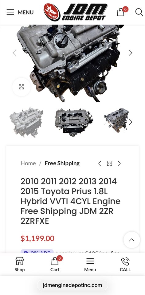

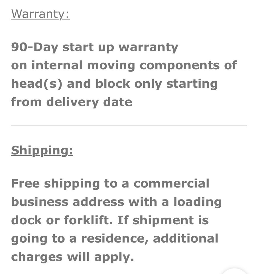

    I would find an independent hybrid shop and get their diagnosis. It is worth it to drive an hour or more. If it needs an engine I would consider a JDM used in Japan engine with a guarantee.

    So an update to the saga. Got a JDM engine replacement that measured compression at 165psi. Swapped the engine out but used original egr, intake, map, maf, cam timing, crank timing, oil pressure, vvt, coils, clutch thing, fuel injectors, 02 sensor, water pump, thermostat, temp sensor. Old engine measure 140 psi compression. Fired it up and it still has the same misfire. Now I also have the temp light on, but I read the temperature rising from 70 to 90 degree F with OBD2 so why the light? Can a water pump fault set the temp light on? Since I still have the misfire I have tried swapping cam sensor and vvt since they were easy to access with the JDM engine leftovers but still no change in the misfire. I also tried shifting to neutral while idling to try and rule out any transmission influence, but still a misfire. It wasn't using coolant before the engine swap, and I haven't driven enough to know on the JDM engine, but it is behaving with the exact same symptoms as before the swap so don't think it is a headgasket. I'm thinking Air, Fuel, Spark, Timing is all that is needed to run an engine so breakdown as follows:
