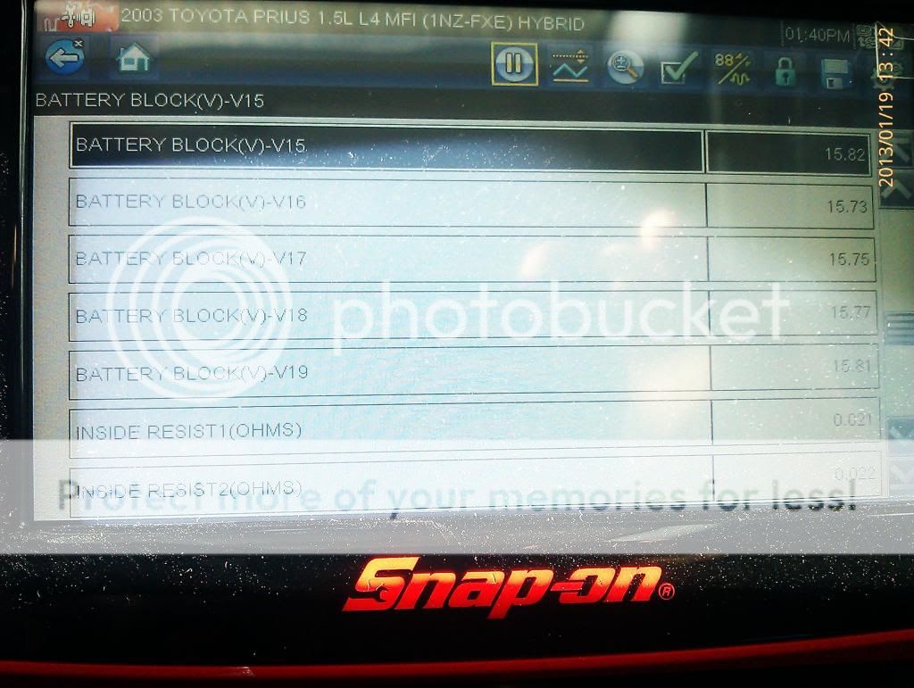

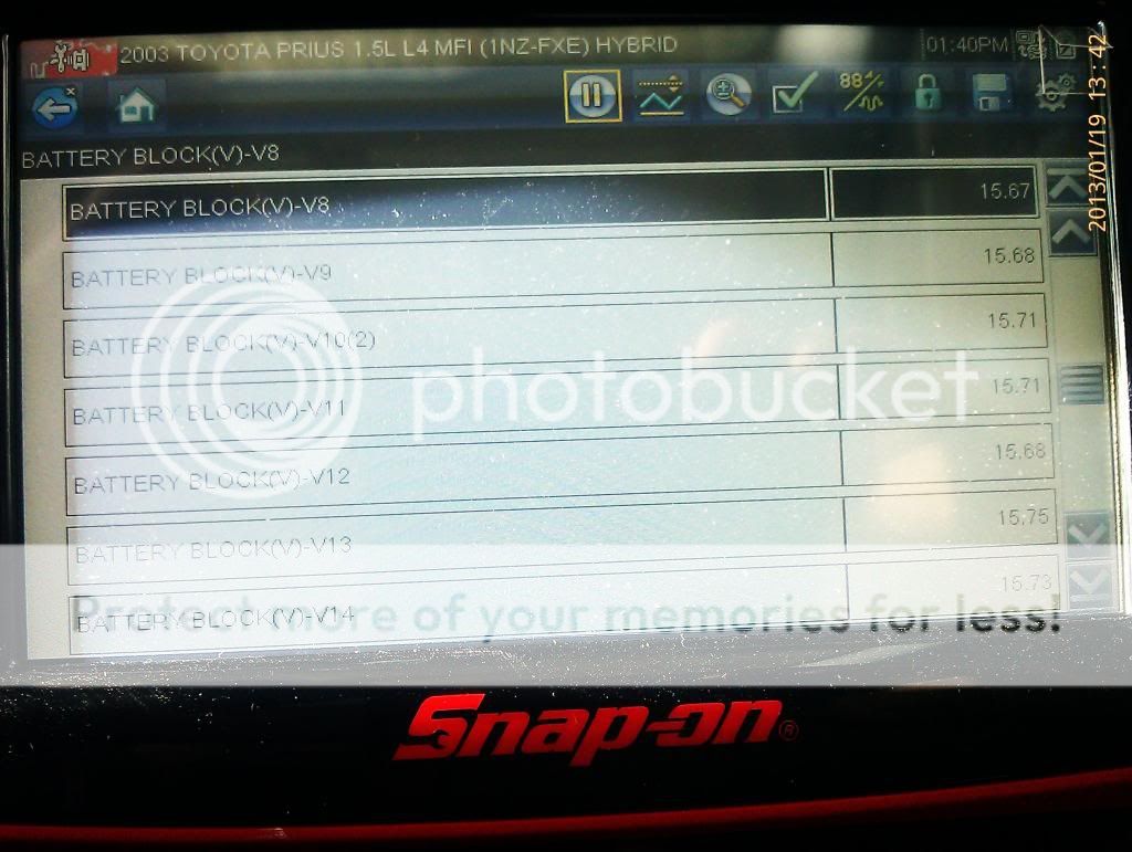

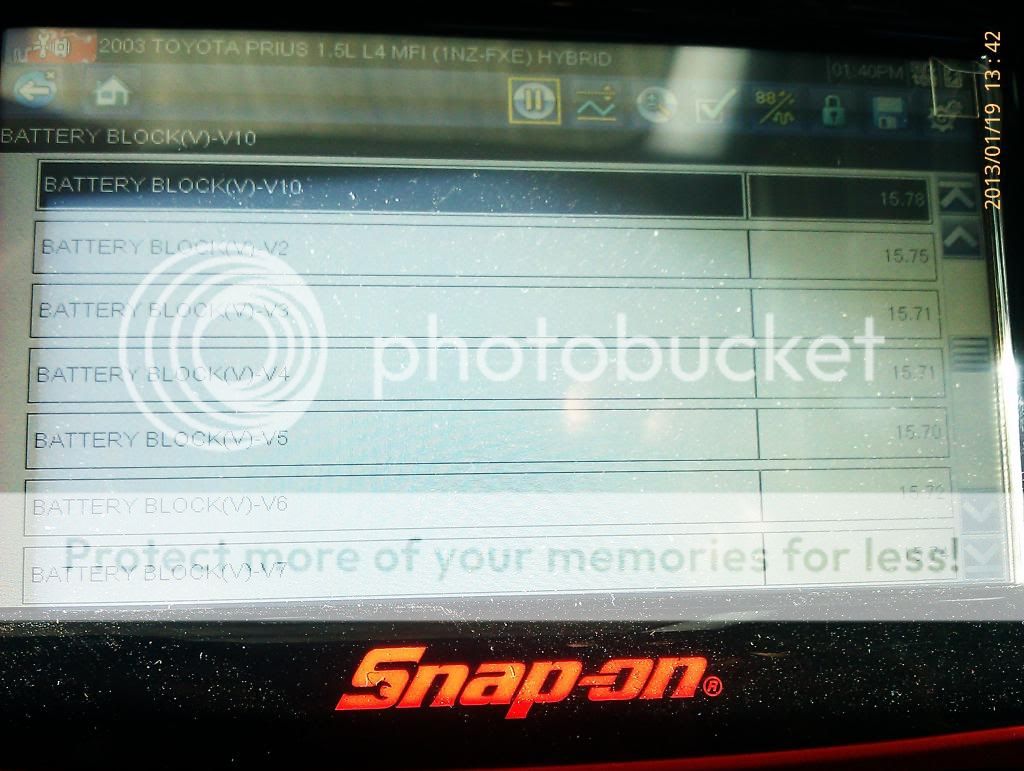

    I am working on a 2003 Prius with 120k. It died when the owner was coming to a stop. He had it towed to the dealer who told him it needed an inverter and quoted $4600 to replace it. I replaced the inverter with a used unit from a wrecked car. After clearing the codes the car starts and runs but after a few minutes the triangle of death comes back and codes P3000 and P3009 are set.
    Battery voltages are as follows.
    Any ideas of where the best place to start diagnosing the leak is ?

    Yeah, unfortunately, it sounds like the transaxle but run the test to confirm. The inverter could also cause those symptoms by not providing the right power to the MG's. So really its pretty much narrowed down to the inverter or the tranny. I know you said you replaced the inverter and that's why I'm leaning tranny but that test will narrow it down.
    Remember when you run the test tonight we're looking to see when the p3009 fault comes back (not just the check engine light which will probably come on right away). Also look for other fault codes (of course).
    The battery block voltages look fine.
