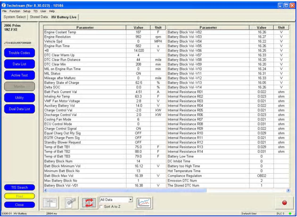

    I was finally able to get Techstream set up and collect data using the mini VCI cable:
    The internal resistance values all look good and don't jive with what I measured at all. I'm wondering if these are real values being reported by Techstream. Battery block 14 (the one that threw the P3024 code) is one of the lowest voltages, along with block 8. This was only a short drive and both of the times I got the DTC were at the end of a ~50 mile drive. I guess that's what I could do next.
    The battery temp is low, so I wonder if that could be a factor. When the DTC was thrown, the cooling fan come on.

    Yes, the challenge is to get the battery ECU to log the DTC again, and at that point run the diagnostic report and see what it looks like.

    I was wondering if that was going to happen, seeing as your measured values looked so high. I am guessing that what you measured was the DC resistance and that what the Prius battery monitor system (as read by the tech stream) is measuring is the AC resistance.
    In the simplest possible model for a battery there is just the the one voltage source and the one internal resistance. This simple model doesn't take account some electrochemical dynamics of the cell, and more complex battery models include various capacitors and resistor in series/parallel to help model these dynamics.
    In essence, there isn't really one single number that truly represents the series resistance, so the result you obtain will always depend to some extent on how you measure it.

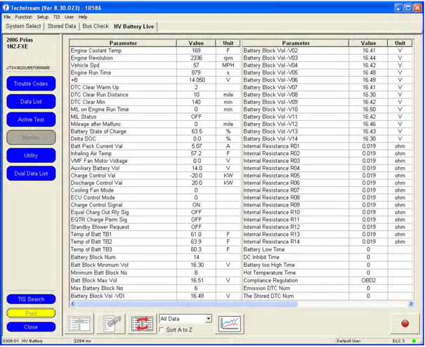

    Well, I drove the car long enough to get the P3024 code again. It came on after about 30 miles of highway driving. Speaking of the Techstream resistance measurements, here's what I got after the code:
    The range is from 0.021-0.031 ohm. I wish it broke it out by module, so I could pair them up.

    Yes. Given the data you have, why not replace all eight modules from blocks 8, 10, 13, and 14.

    Your weak modules have a lower capacity than the others and note the variation in series resistance. Pair 9 is also suspect (low capacity).

    There's about 50% more resistance between the high and low pairs, which sounds significant.
    I realize (now) that my images are a little blurry. The resistance on pair 9 is 0.22 ohms, similar to the others we're considering good. Was there another reason to consider pair 9 as suspect?
