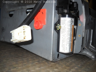

    It might be worthwhile to pull the SMR and take a good look at all connections. For comparison, there are some good close-up pictures of the SMR here: 2001 Toyota Prius NHW11 battery components
