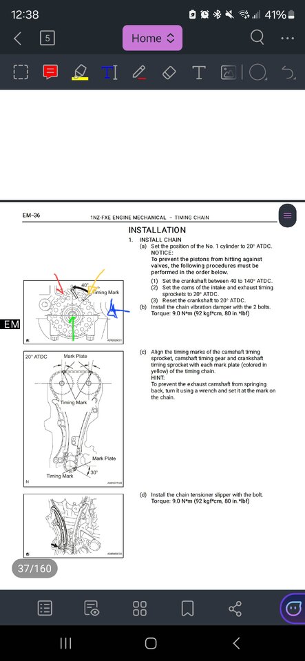

    I replaced the timing chain on my 2008 Prius this weekend because I was getting the P0016 Crankshaft Position/Camshaft Position error. After reading the manual, I decided to replace it. With 300,000 km on the odometer, it seemed like the right time to do it before encountering any other issues.
    Everything went smoothly, but I couldn't start the car again after replacing the timing chain, and now I'm getting the P3190 code for "Poor Engine Power."
    I believe I made a mistake while aligning the cam sprocket/pulley with the crankshaft. If I did indeed mess up the synchronization between them, what would be the best way to adjust it?
    After replacing the timing chain, everything was aligned with the marks, and I was able to move the crank without any friction between the pistons and the valves.

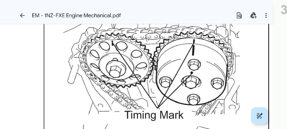

    Go back "to the scene of the crime". Remove the valve cover, then use a wrench to turn the engine clockwise until the notch on the crankshaft balancer lines up with the "0" timing marker on the front cover. This is TDC (top dead center) for cylinders 1 & 4.
    Both marks on the cam sprockets should be visible, (that means you are at TDC for cylinder 1 on the compression stroke). If not, rotate the crankshaft 360° and try again.
    Both sprocket marks should be 90° from the valve cover gasket surface (ie, the cylinder head surface is "9 and 3 o'clock", the marks should point exactly to "12".)
    You may have to reset camshaft timing. Hopefully nothing is so far off that valves hit the pistons.

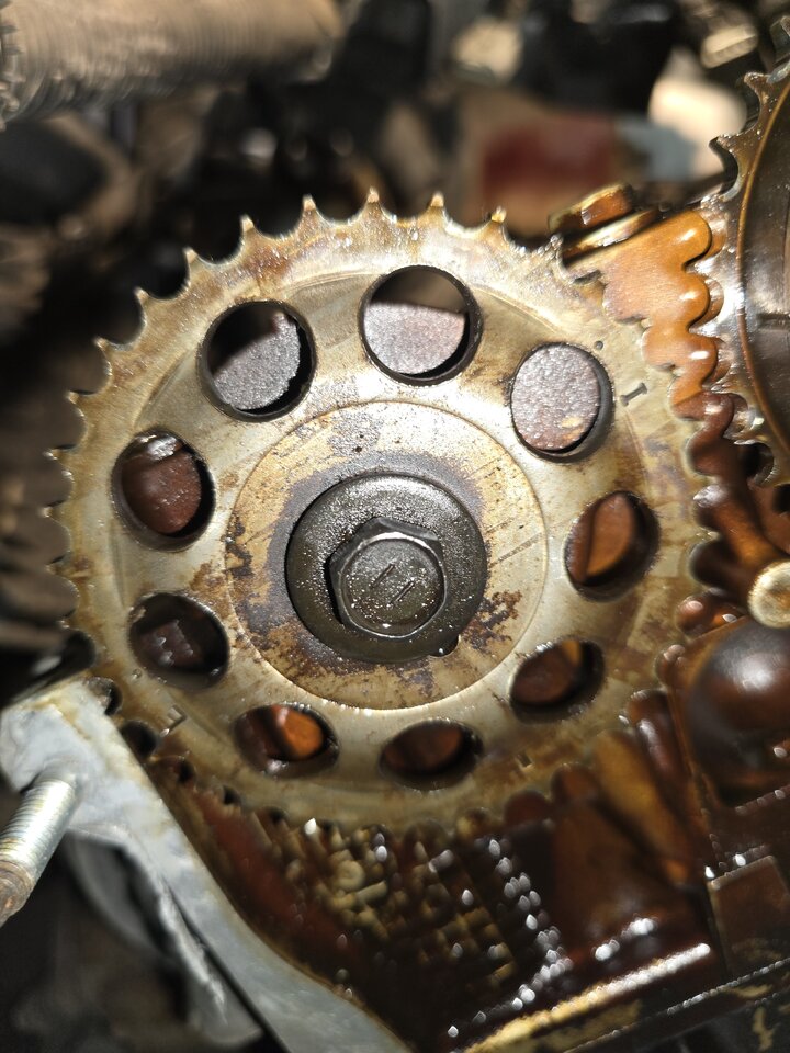

    I am back to the crime scene.
    My pulley is a bit different than the one in the manual. I am assuming the mark is the one that aligns with the keyway.
    I will setup as per instructions and send more photos.
    If any adjustment needs to be made?
    Is there any problem to rotate the camshaft manually?

    Found the problem!
    The previous owner did not install the crank shaft sprokets at the right position.
    That is why it was not working as per manual instructions.
    I thought the chain had slept 1 or 2 teeth but not.
