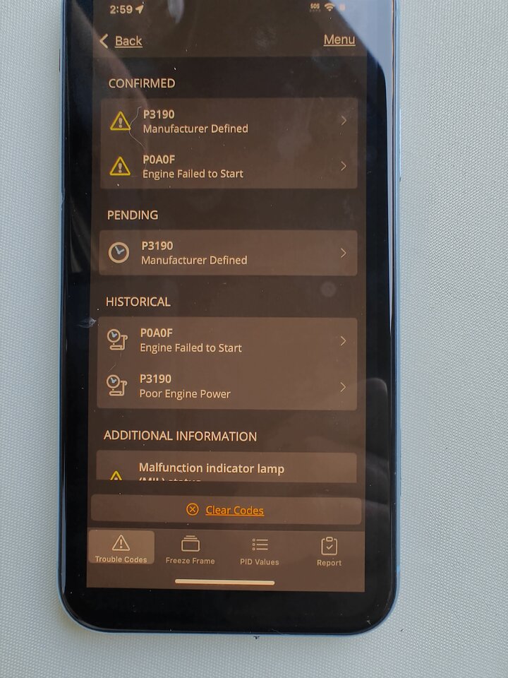

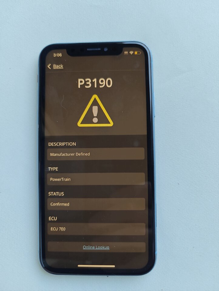

    So, bought my daughter a car. It ran well. 2004 Prius. I had to change the cat and find the evap leak for title and registration. Those went fine and were the only codes.
    While I was at it I did some other things. I haven't worked on cars much, and don't know a lot.
    I changed the exhaust manifold gasket and the air fuel ratio sensor down there (denso) when I was doing the cat. I also changed the head gasket, pcv valve, and cleaned the throttle body and intake manifold. I replaced the spark plugs (denso platinum tt) and coils, and put in remanufactured fuel injectors (denso by aurus), a bit of fuel came out of the metal bar they attach to.
    There was tons of oil-gummed gravel and sand embedded onto the top of the engine and it took forever to clean to prevent it from falling into the spark plug shaft, or fuel injector wells. A little might have fallen in but very little like a few grains of sand.
    Anyways,

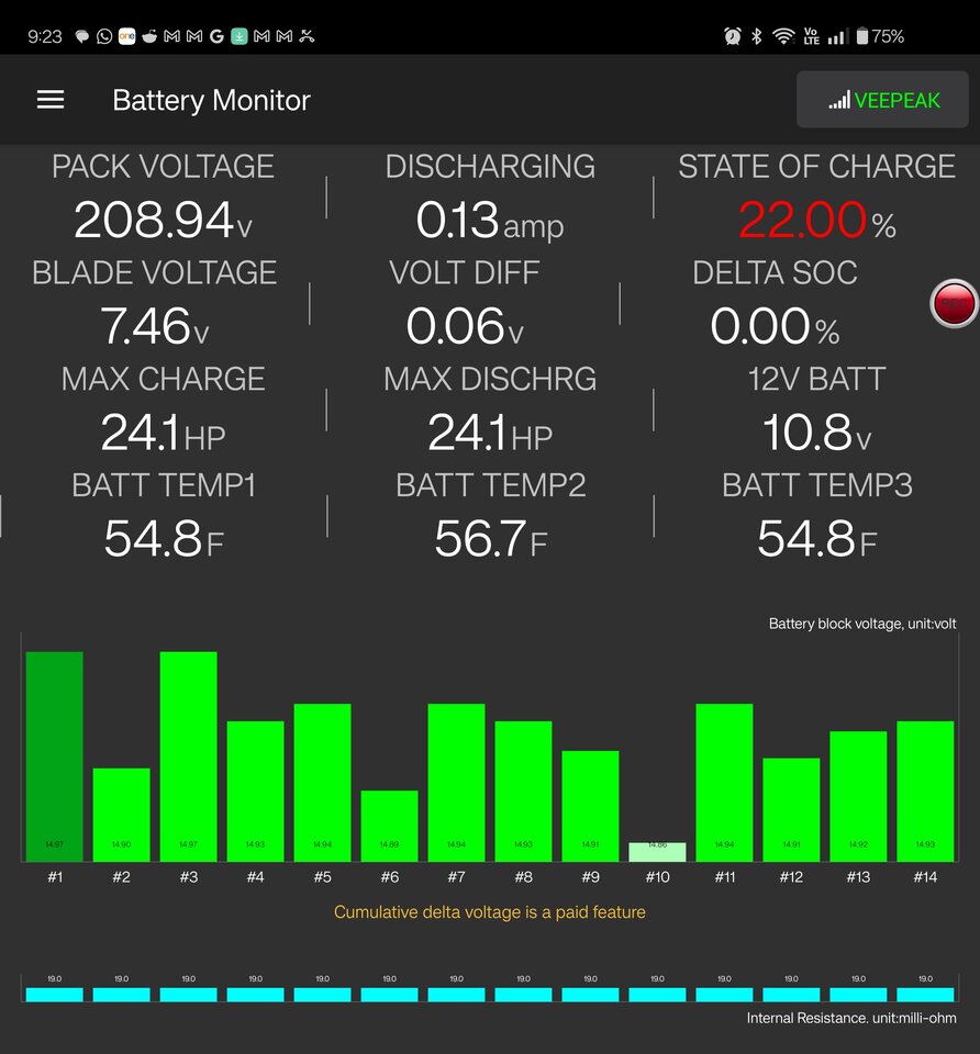

    The main 202v battery has only one purple bar of energy left, which alarms me as the car uses it after start but is shutting down prior to charging it.
    The car runs very rough. Knocking. I thought it was air in the fuel bar above the injectors, or a bad vacuum seal since it sounds like that.
    And after running a few times it knocks and knocks and then after 5-8 secs of knocking it runs smoothly like no issue for 10 seconds then while running smooth it instantly shuts down with a red triangle.
    Where can I start backtracking and looking for my mistake?
    But in reading on what I did wrong I didn't gap the spark plugs. I didn't know to do that.
    It's at half a tank of gas. On this repair segment I did run smoke (baby oil) in the fuel line to find the leak.
    But there might be other things too, so I'm hopeful you guys who knows so much more can make suggestions.

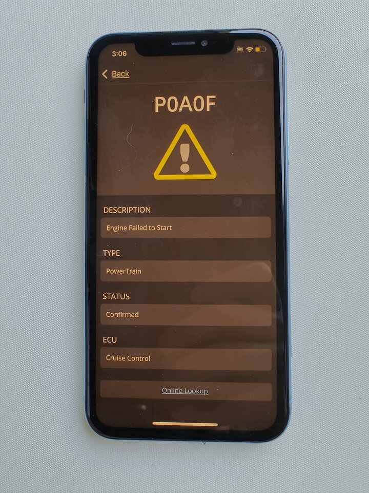

    Your car did not start. The engine is turned over at (I think) 1100 - 1200 RPM by one of the electric motor/generators (MG), and that sounds very much like the engine is running, when it isn't.
    The codes you posted at the top reflect this. P3190 - Poor Engine Power and P0A0F - Engine Failed to Start. The first code has 5 subcode (INF codes) that could norrow down the problem area.

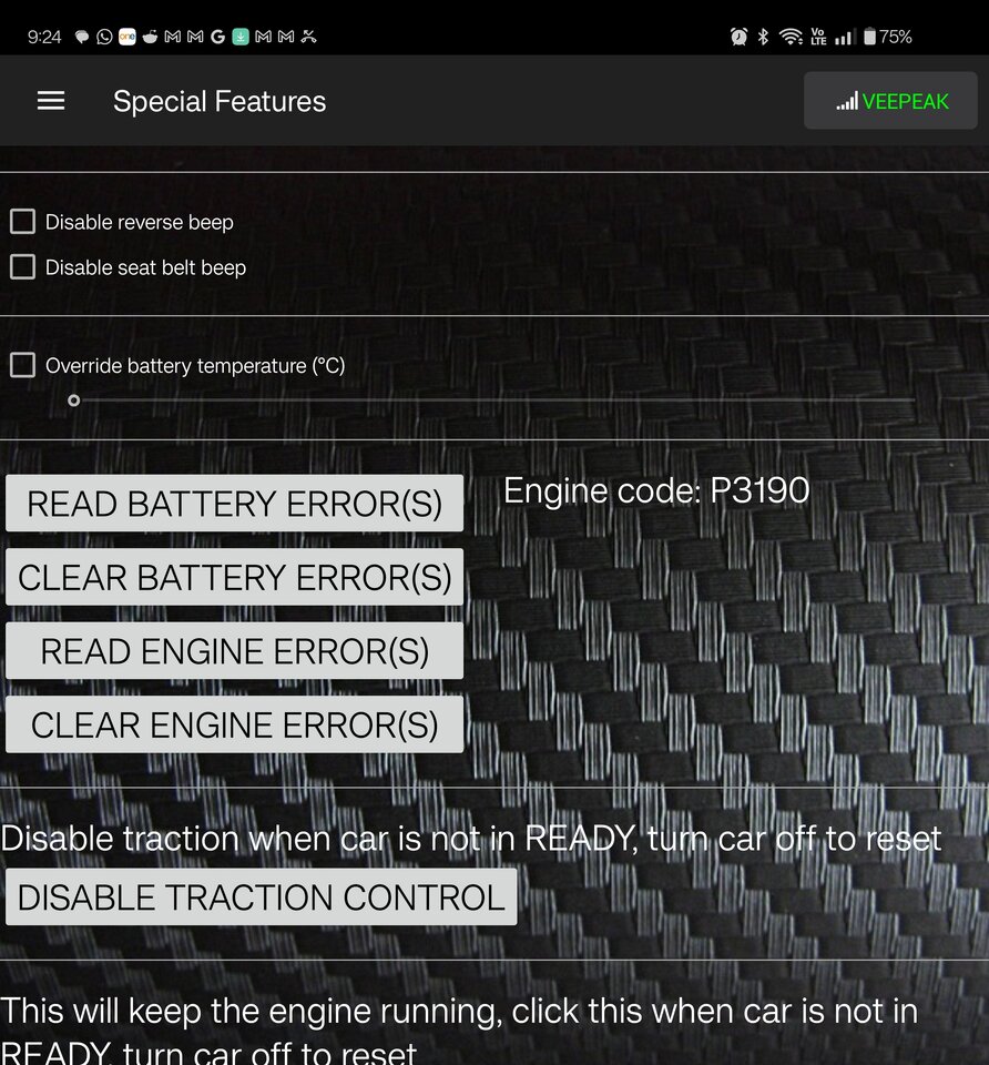

  4. Shapechanger
    Shapechanger Junior Member
    Jan 18, 2009
    Portland
    •Yes it was the valve cover gasket, my apologies.
    •I was using CarScanner and Veepeak2 ble+ that is compatible with elm327 V2.2, purchased nov'24.
    •Thank you, that is quite a thorough thread on the app review.
    -I'll download DrPrius, HA, and OBD Fusion, and see if it's effective (I'm on Android but only recently, still figuring it out) with the veepeak2, it appears to be based on some searches, but if not I'll follow the Dr Prius page recommended one modules (isn't listed there)
    •Hybrid Assistant has pretty cool realtime battery and fuel information.
    •DrPrius gives only the generic engine code. I'll read further in the recommended thread and see if this app does give engine sub codes.
    •Frustratingly I cannot use OBDFusion yet, as I've been an Apple user for 15 years, and my Google profile is outdated after my marriage name change, and they have locked my payment account while they work that out. Who knows how long.

  6. Shapechanger
    Jan 18, 2009
    Portland

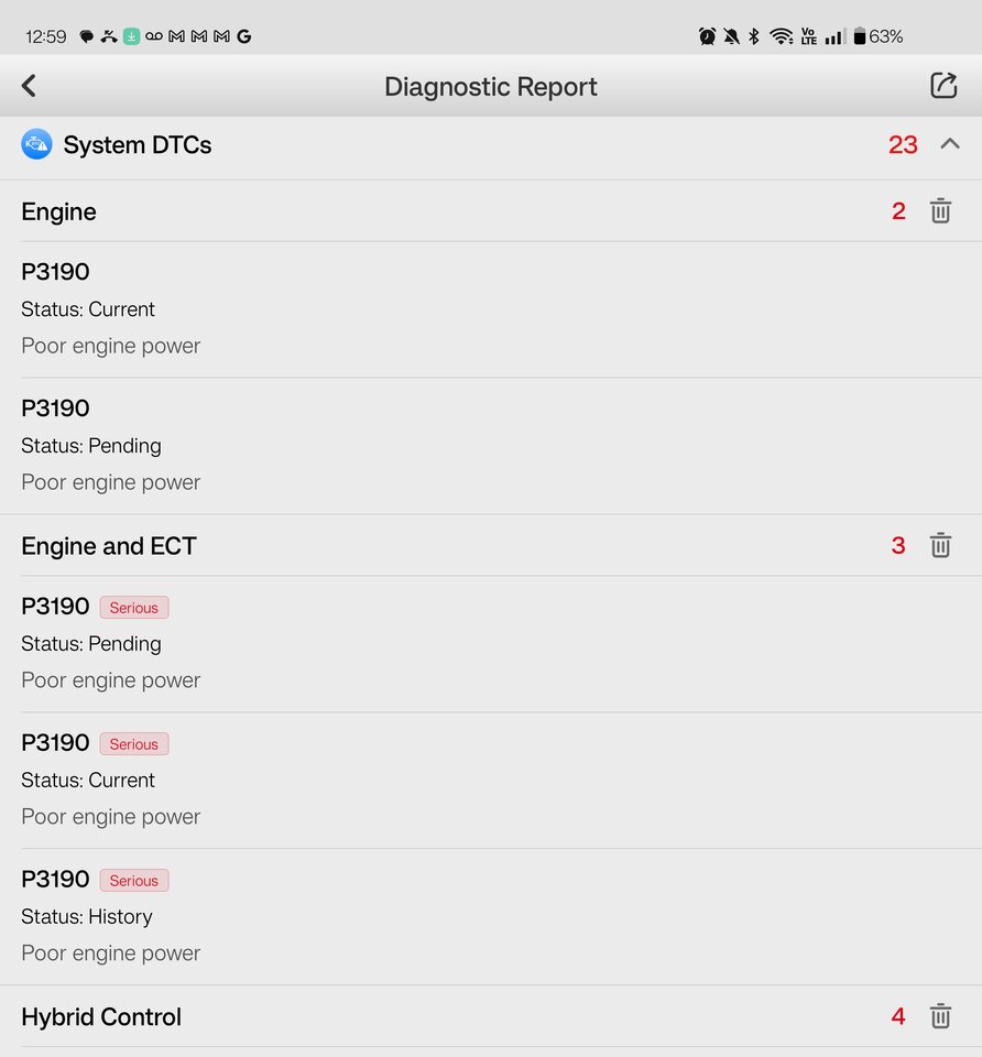

    Using OBD Fusion with the model/year specific upgrade, on an Veepeak Elm327, the updated code is here but all it says is poor engine power.
    Just waiting on the Autel obd device to go with the app, now.
    #6 Shapechanger, May 1, 2025
  7. Shapechanger
    Jan 18, 2009
    Portland
    Well, no additional info at all from it, no subcodes.

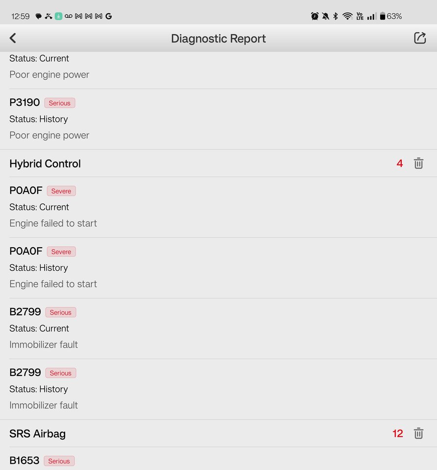

    B2799 Error on immobilizer. Have you rearranged the units, changed the key fobs from another car?

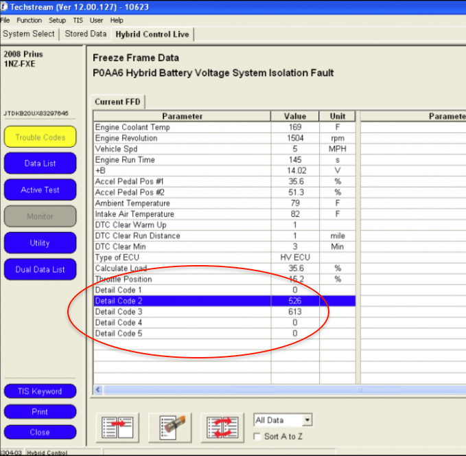

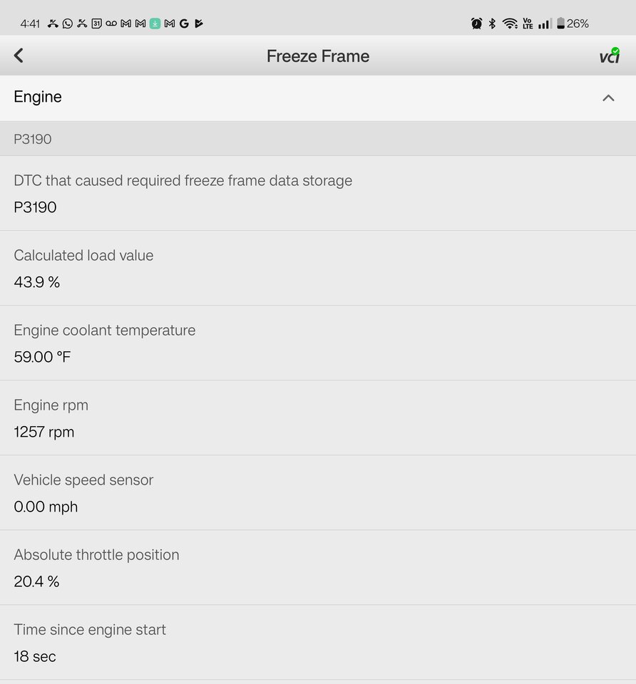

  10. dolj
    dolj Senior Member
    May 14, 2012
    8,652
    4,404
    Wellington, New Zealand

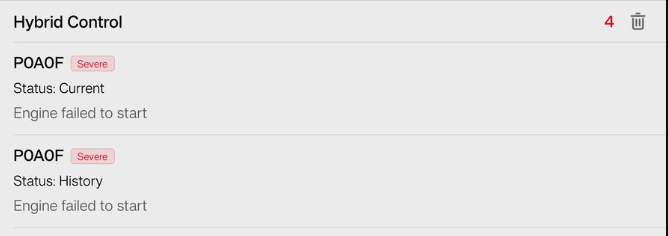

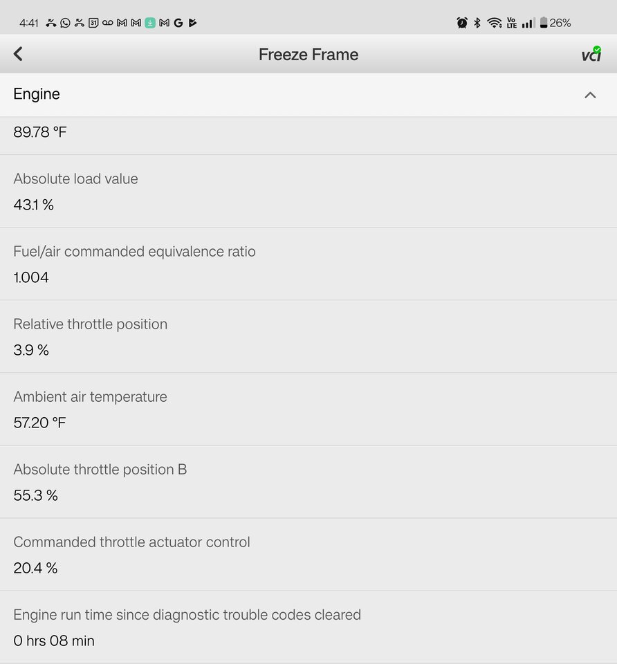

    You need to click into the Freeze Frame detail info for the P0A0F and look at the top or bottom of the displayed data. There should be lines that say Detail Code 1, 2, 3, 4, etc (or INF). One or more of these will contain the code(s) you need.
    This is an example from a different code, but the idea is the same:
    Shapechanger and mr_guy_mann like this.

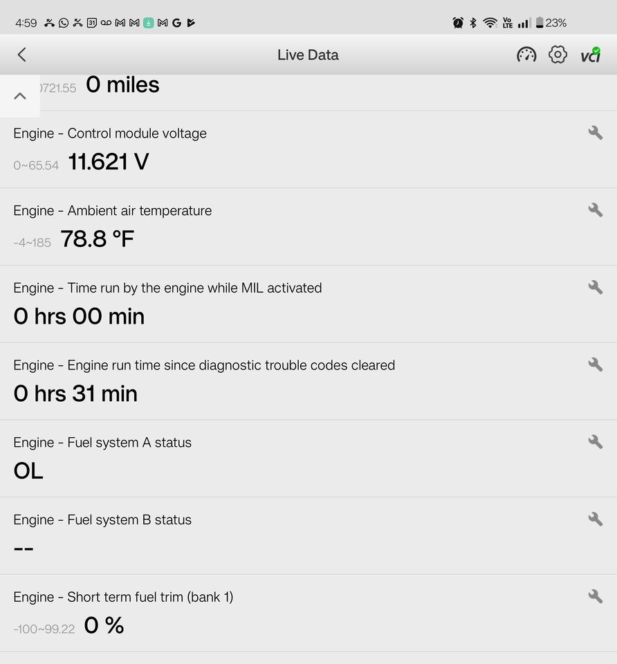

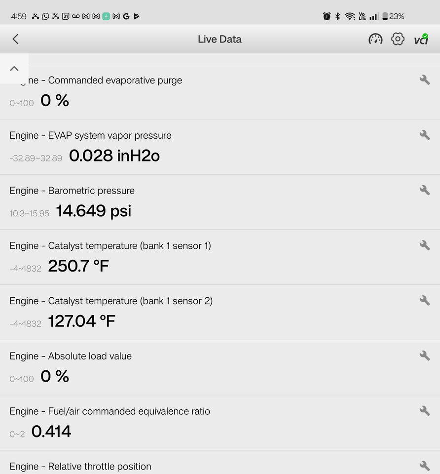

    Slightly different data from "live". Only in accessory mode.
  15. Shapechanger
    Jan 18, 2009
    Portland
    Okay. I'll check it, again. Maybe I somehow overlooked it.

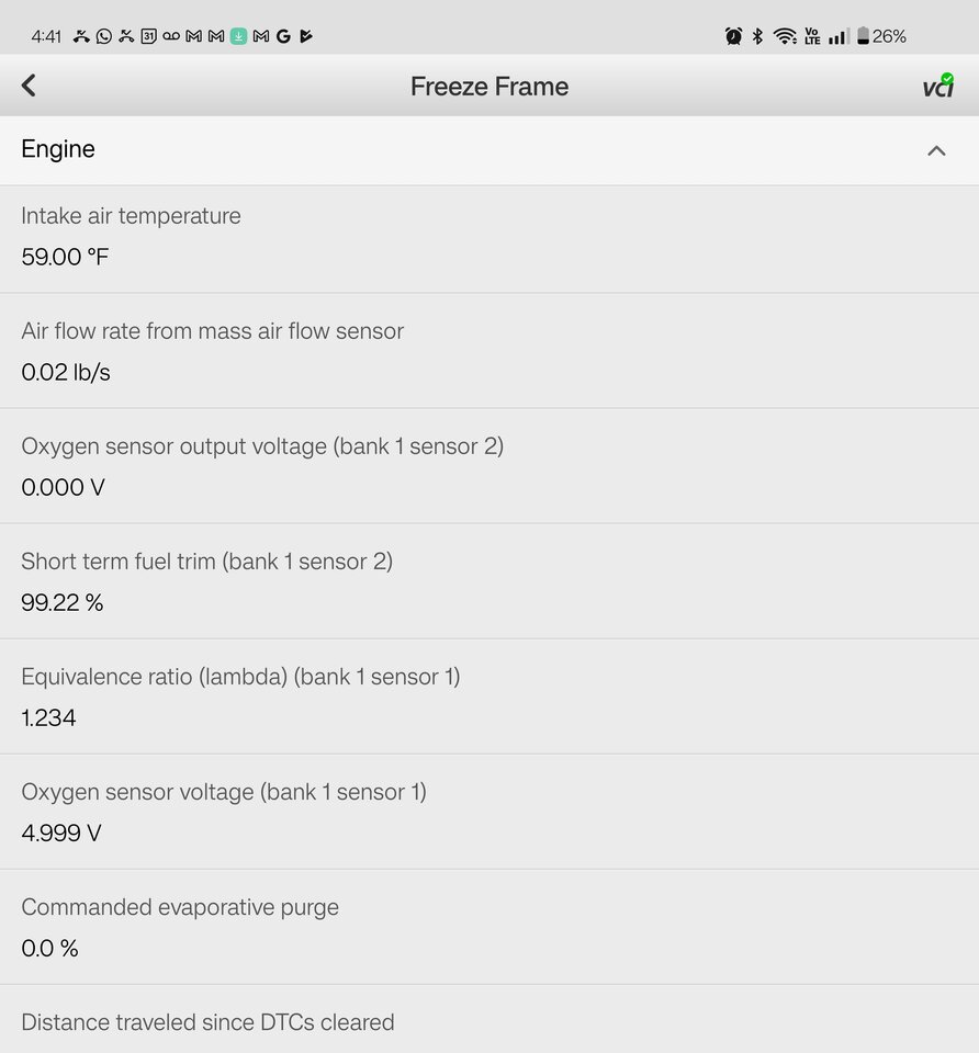

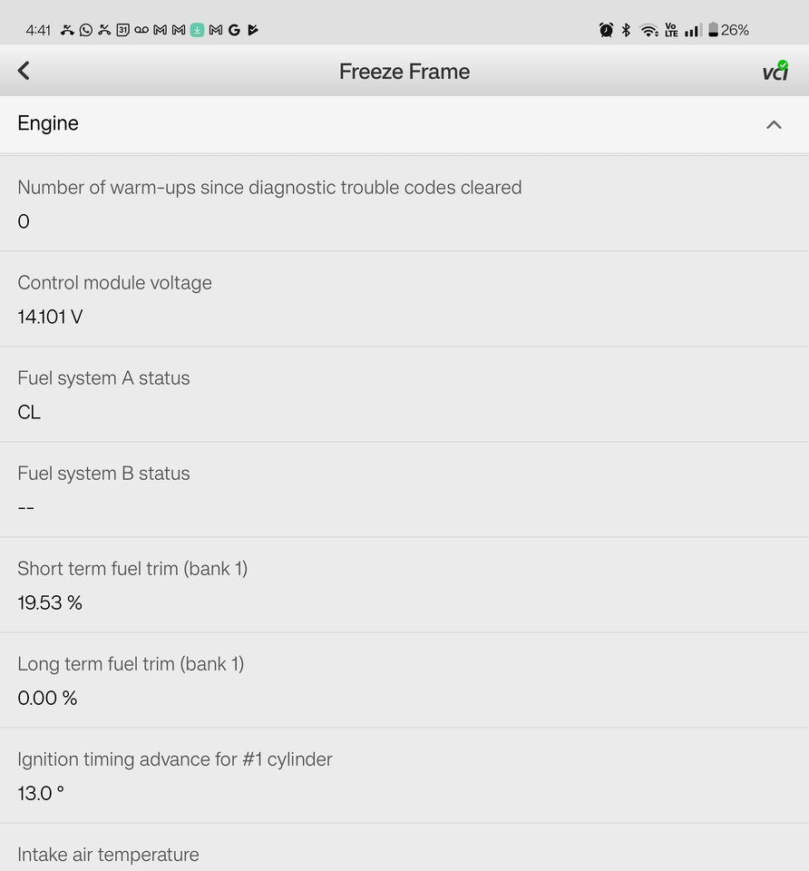

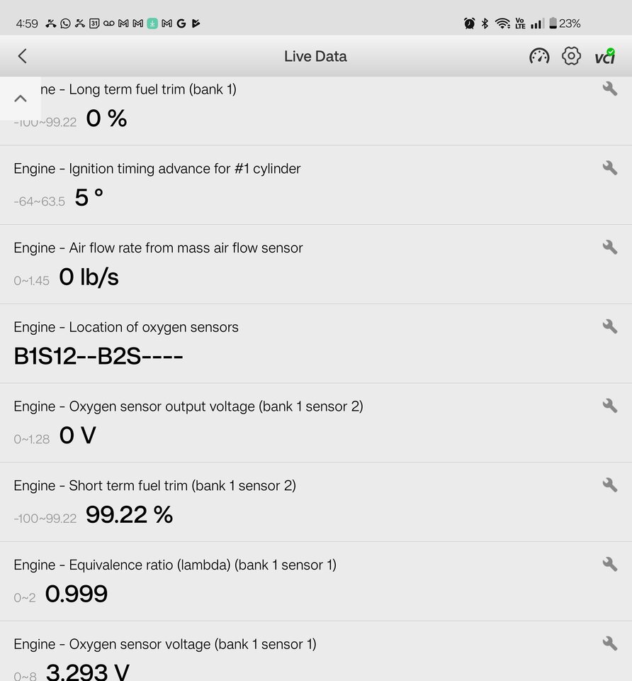

  17. dolj
    dolj Senior Member
    May 14, 2012
    8,652
    4,404

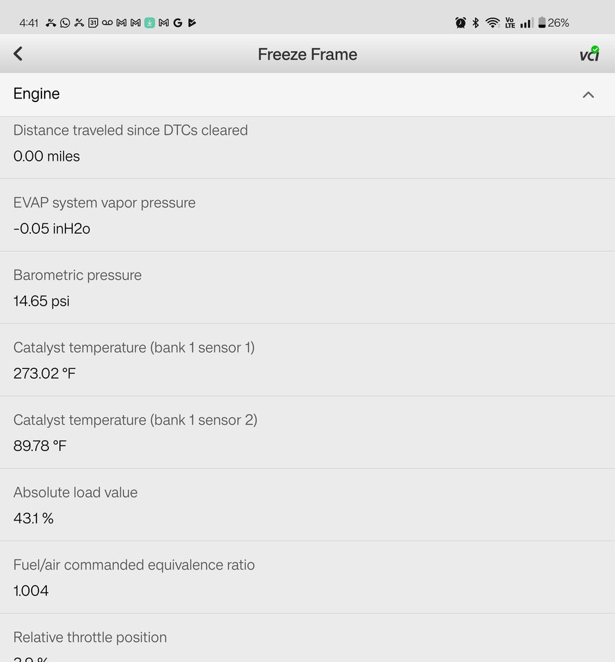

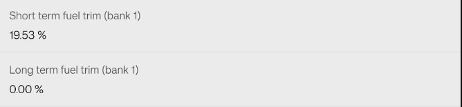

    As you say, these are from the Engine section. The fuel trims look off:
    Then further down, it show this again for STFT: What is B1S2
    Does the FF for the Hybrid Control section show anything different for the fuel trims, either the current or history?

  18. Shapechanger
    Jan 18, 2009
    Portland
    The FF lists nothing at all for Hybrid Control :(
    Is it possible B1S2 is referring to the -downstream of catalytic convertor- O2 sensor applying a control to fuel?
    Except it was also replaced 2 months ago and car ran fine. I double checked that I didn't forget to reinstall it.
  19. dolj
    dolj Senior Member
    May 14, 2012
    8,652
    4,404
    It does, but I don't recall that it measured fuel trim info for that sensor. Though, as the engine was not running, I'm not sure what to make of the 99.22% that is shown.

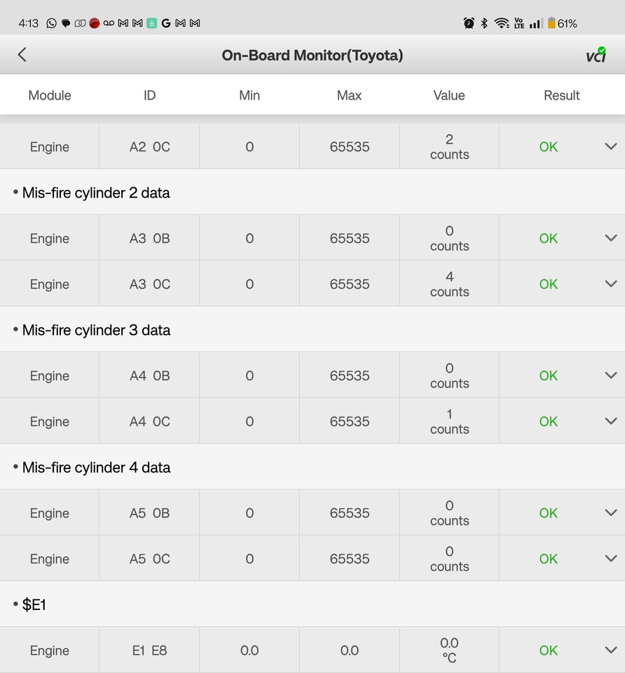

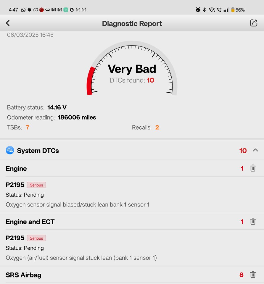

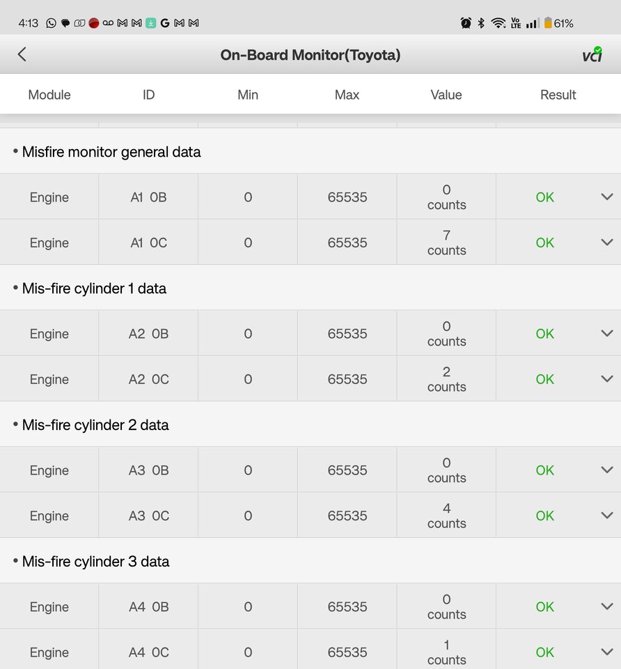

    UPDATE:
    Discovered the air leak was from using an adjustable crescent wrench to change the PCV valve, and cracking the valve cover beneath it as the curve of the wrench steadily leverage the top
    Prior codes gone, but now facing a P2195 code, only.
    I replaced with Denso if available the MAP sensor, O2 sensor, PCV, coils, plugs, injectors (refurb denso), valve cover gasket, rear manifold gasket, catalytic convertor, air filter, oil filter, oil change - (main issue it was failing DMV and did the rest "while I was at it").
    Using propane while the engine runs (misfiring a bit and shaking a big) gives no smooth running locations.
    The injectors used to have very tight orange seals in the block, but stupidly I tossed them, and now have black. 1 & 4 do not fit snug, easy in and out. I bought two new sets of seals including an OEM at $8 and $11 per seal, but 1&4 are freely loose with all sets, while 2&3 are tight or just snug. I used wheel bearing grease top and bottom careful to not get any at the end of the injector, see if it affected the running. It runs better with the grease and I assume it's a tiny leak on 1 (left most facing engine from bumper?) which without grease I could hear just a faint airflow via a 1/4" hose stick in my ear.
    Any more tips would be great. I haven't driven it, and it's only now just running enough to get the nickel battery up past one bar, which was a big worry.

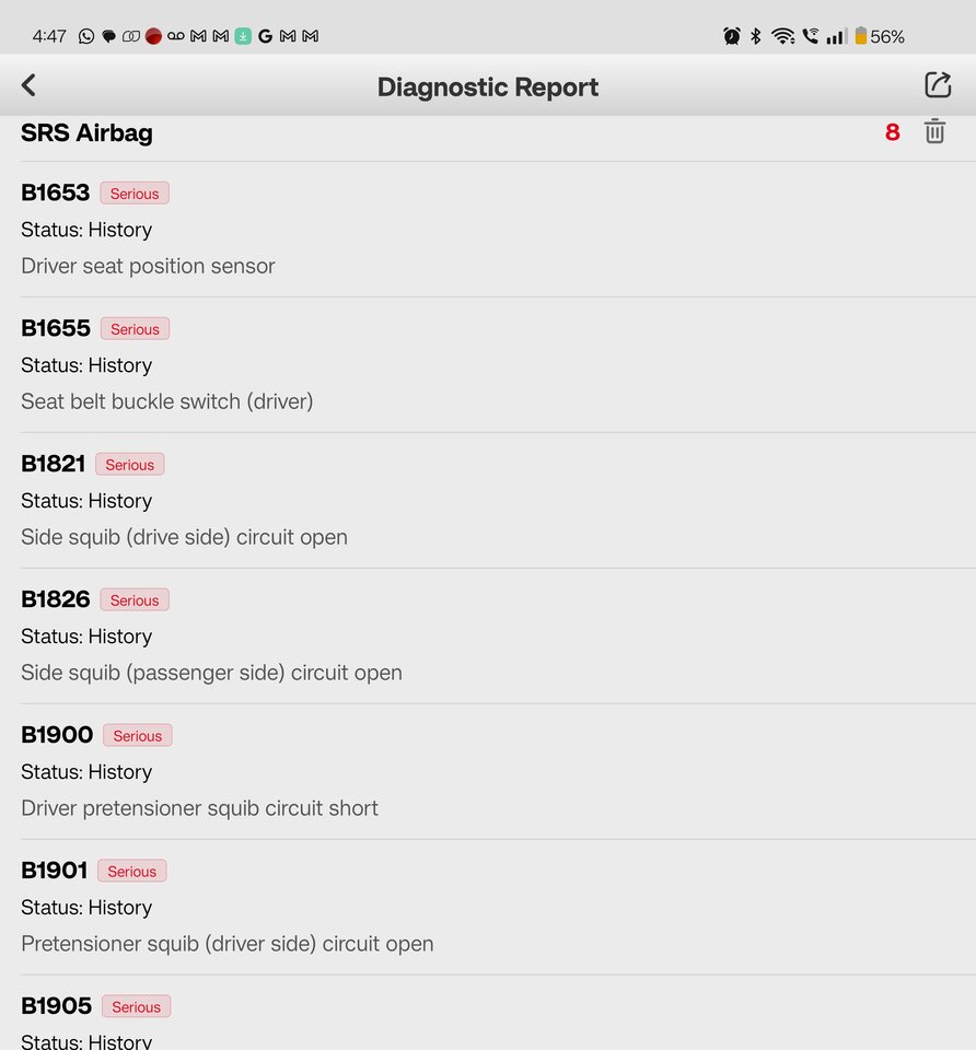

    I've been through everything so many times. I don't know what I'm missing. I feel exhausted by my own ignorance and incompetence.
    (The interior codes are from removing the cars interior to clean the carpet etc. it's reassembled but I havent troubleshot what's going on there yet)
