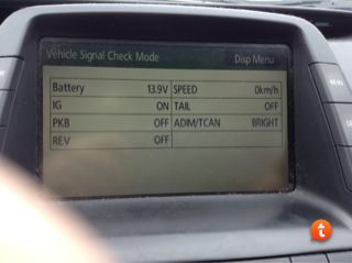

    I tried to do the battery check when I got home from a 30 min drive, but the headlight method wasn't working. I had to run upstairs to get the other method, which worked. Here's what it said:
    13.9v
    The gas engine had kicked on when I pulled up the battery check (I had to repark my car anyway, now that enough snow has melted to see the lines in the parking lot), which sounds like it was starting to charge again. Should I try it again when I haven't put it into ACC mode 4+ times?

    BTW. You are supposed to test the 12V with the ignition off. Ignition on does not tell you anything because the inverter is supplying the power in ignition on. Also, you should perform this test after the car sits overnight for a true reading. Furthermore, Patrick Wong is one of the best people to receive help from on this forum... Alienating him with abusive comments is equal to you going to the bank and setting up a direct payment link to your local Toyota Dealer. Just sayin'.

    Also, if you really want to check the 12 volt properly do it after the Prius has set overnight. The 13.9 volts really doesn't help you much other than showing that the charging system is working. What really tells the most is the voltage in the first part and the second part of the test.

    The non-headlight instructions said to turn the power on, if it wasn't already on. It didn't specify ignition on or ACC mode. It also said in those instructions to check it after the car has been driven for 30 minutes, giving it a chance to fully charge. I'll recheck it tomorrow morning, seeing as I got conflicting information.
