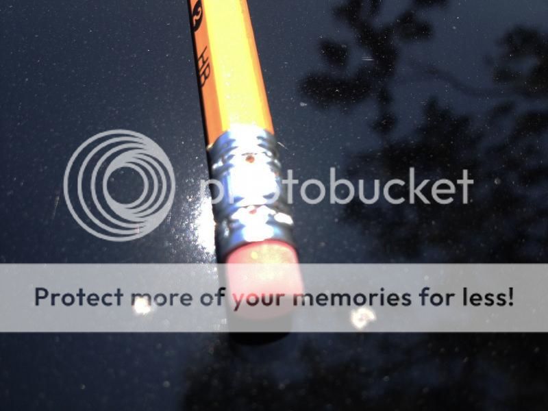

    Here is my chips, just above the front glass line.[​IMG]

    Yap, this as well as hood is the rock impact zone. They are quite big indeed.
    Pardon my asking, but is this your first car?
    Most people know to fill the defects with touchup paint before surface rust sets in. The paint may be soft all right, but this damage is not going to be covered by warranty.
    BTW, Black paint is way the hardest to keep in any decent shape as any defects will show like crazy.
