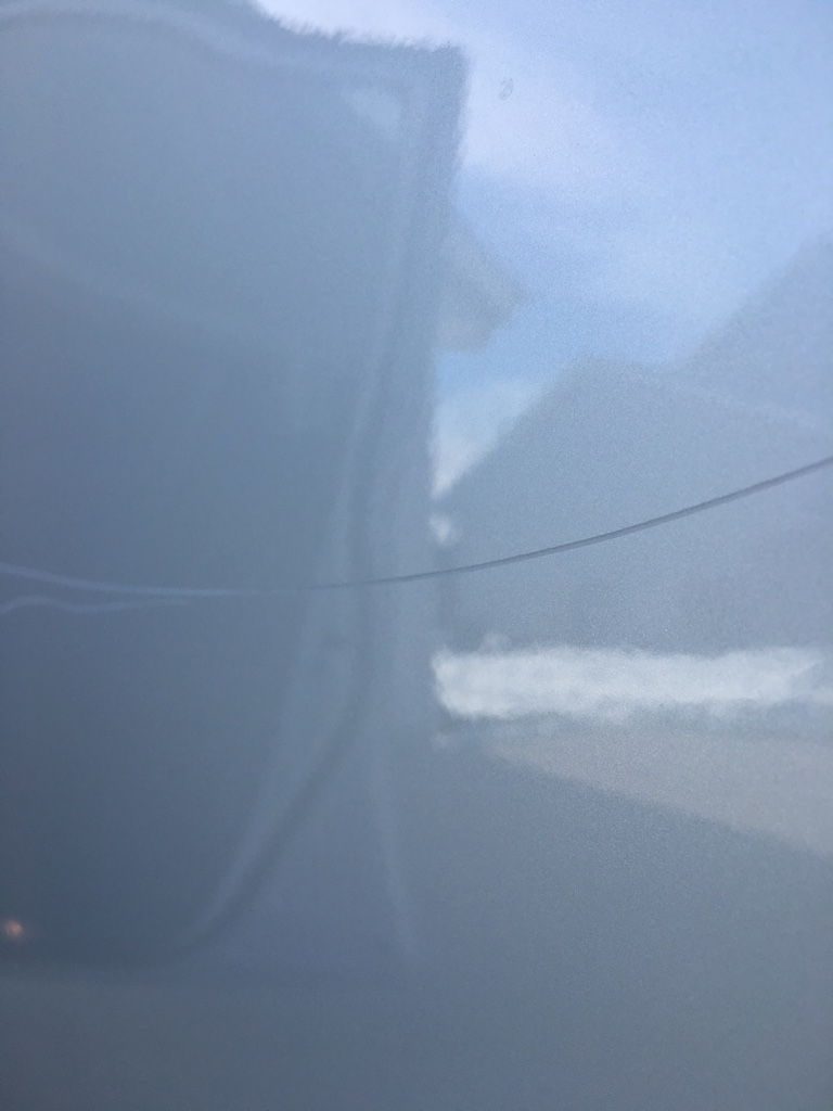

    I was the victim of someone scratching the rear door on the left side. I can feel with it with my fingernail. Is it best to have a pro fix it come Spring time? WI is very cold at this time of the year. I have a '15 Pearl White Persona.

    Since I can feel it with my fingernail what would be a do it yourself technique that may conceal the scratch without going to a professional?

    A shop might be able to wetsand and clear coat it? Worth stopping by a couple places and ask thier opinion.

    The scratches might be too deep but you could try a high quality rubbing compound followed by a polishing compound...

    A DIY job can fill in the scratch but I'd be very surprised if you'll be able to match the paint. In some or most light the scratch is going to be visible.
    I'd get a professional opinion from the body shop? Did the scratch go down to the metal just past the junction of the Y or is that where it didn't do down to the primer?
    If the car was 10 years old I'd vote for touching it up yourself at minimal expense but the car is too new so I'm voting to do it right so you won't be reminded of it every time you see that panel.

    ^ Plus 1. Bite the bullet and get a body shop to look at it. Up here that'd be called a "comprehensive" claim, a catch-all for vandalism, hit-and-run.
    Your picture's so close it's hard to tell the scope, how close it it to adjacent panel/seams. Depending on how far it is from a border, they may be able to blend it within that panel, but more likely they'll need to extend to adjacent panel.

    Polish or scratch remover products will aid in reducing the appearance of those scratches but sorry to say you will not buy anything that will make them unnoticeable without repainting the area. Whoever did it went deep enough that it isn't easily polished away...
    Because a bottle/tube of scratch remover is cheap and it is good to have on hand anyway, I say buy it and try it. If you're ok with the scratches being visually reduced but not gone, you're done. If not, you are only out a few bucks.

    The scratch starts off dark on the right end, but moving left it gets lighter.
