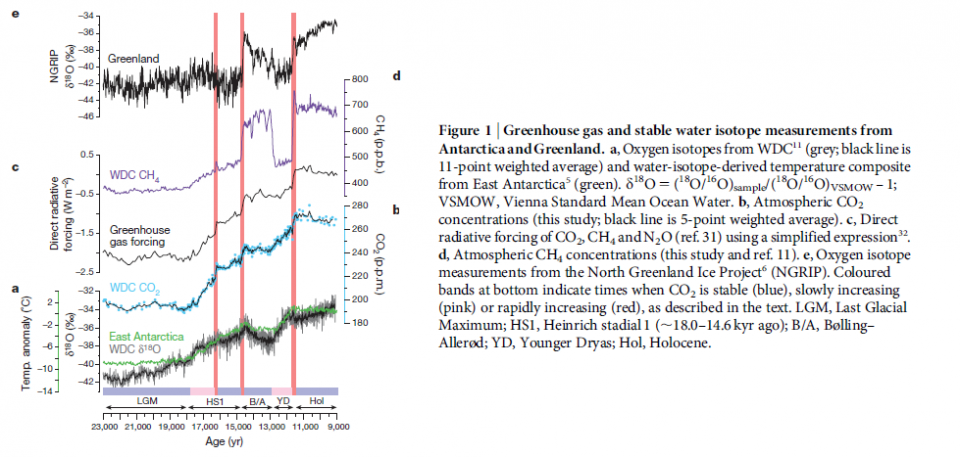

    I did not expect it to be hard to find. Without permission I show their Fig. 1 here. The bottom two squiggles are CO2 and temperature from their new, better-resolved Antarctic ice core. In the first two 'bumps' CO2 and T seem tightly linked in time. The third bump has T leading CO2 by about 1000 years, which is has has been inferred from lower-resolution ice cores in the past.
    About two years ago (?) I posted a link here to a study of marine sediments that suggested much tighter correlation between T and CO2 than the classical 1000 (or 800) years. Shall I go back and look for that?

    Thanks! That is one gnarly looking set of graphs. I'll have to get the article. I see the methane step function but the first set is a bit obscure to me.

    For me, the oddest aspect of the gnarly graph is labelled WDC CH4. It shows three step changes. The two up could be considered possible by way of methane clathrate release, although they would need some sort of trigger. However, I can't imagine a mechanism for getting methane out of the atmosphere so suddenly. It is gradually oxized by hydroxyl radical. That 'OH dot' is totally the rate limiting step. This means that adding more methane does not make the reaction happen faster.

    I will get the paper and agree the methane data does not look right.
