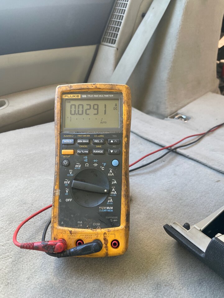

    I've read somewhere on here that ~57mA is acceptable battery draw when the car is off. This car seems to drain its battery if not driven for about four days.
    During this troubleshooting session the aux battery has had a battery charger connected at all times so its voltage level is fine.
    I've tried disconnected the brake control module in the back and saw no change in the current draw disconnecting or reconnecting.
    I've tried removing relays.. all of the relays under the driver's side dashboard and all of the relays under the hood. Doing that didn't seem to make any difference.
    I located the J6 connector and tried disconnecting the CM and Body ECU wires one at a time and that didn't seem to make a difference. I tried disconnecting the radio.
    What DOES make a difference is disconnecting the DOME fuse however that's not an acceptable solution.
    Watching the current draw it's ~160 mA for typically 24 seconds then it drops down to ~55mA for about 2.5 seconds then goes back up to ~160mA.

    Watch the youtube video link I posted. That's exactly what I have done I'm using a fluke multimeter set on the 10A setting.

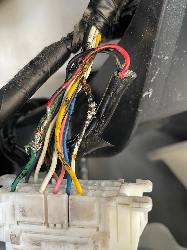

    Under dash driver's side I pulled five fuses to start with: 6,7,8 16 and 17. The current draw went down to ~30mA and stayed there!
    I put the fuses back in one at a time and discovered fuse #8 (ODB) made the current draw go back to 170mA.

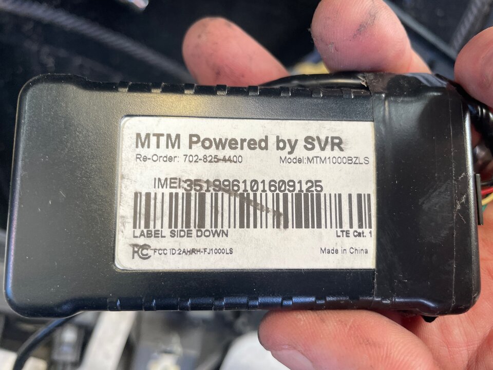

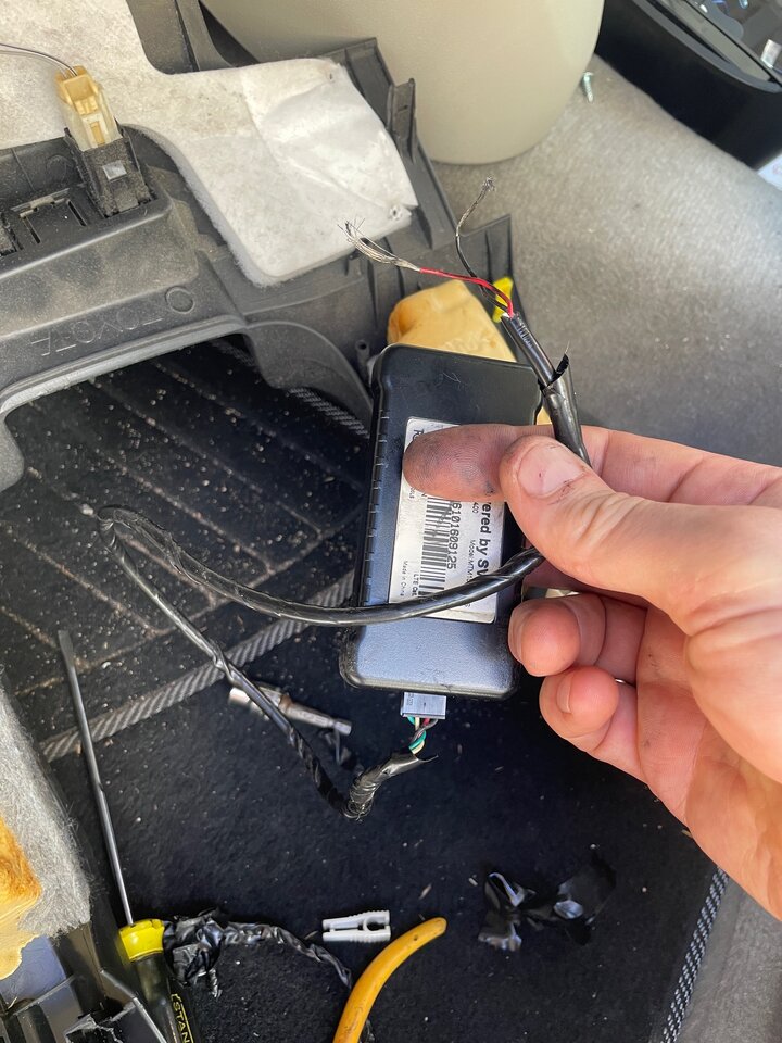

    I looked around the ODB port and saw a suspicious cable with two wires cut off and two not cut off. I followed & pulled on the other end of cable and this small black box came out from behind the center area.
    Some sort of cellular gps tracker? Maybe the car was a taxi at one point in its life?
    Well it's been removed and tossed into the garbage and the problem has been eradicated.

    Googling "mtm powered by svr" is interesting.
