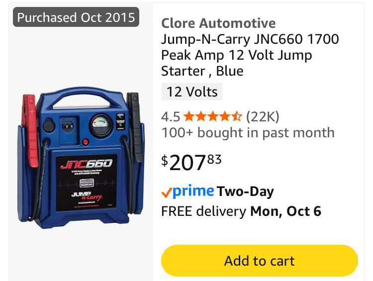

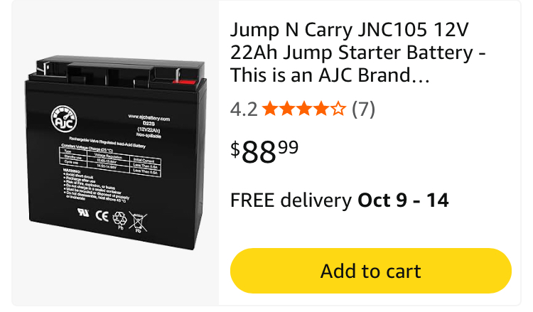

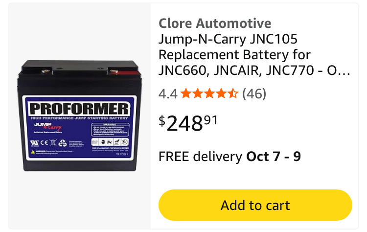

    I’ve got a Clore Jump-N-Carry 660 (JNC660), with an aging battery, and a bit of a quandary:
    So, buy a conplete new one for $207~, or just replace the battery, for $248~…to be fair, there are third party batteries, much cheaper, but I suspect for “reasons”:

    Yea; don't buy from the vendor. Those are 'off the shelf' batteries and usually has better specs. than original in the same configuration. I didn't pay more than $30 for mine - But that was before tariffs. :(:mad: Mine has a pump built into it; so it's a nice all in one.
    I don't know if you have battery+ stores up there. You can drag that old battery in an they'll give you the current specs. n options for better specs batteries in the same package configuration. I've been getting 8+ years out of those old gel cells. Don't switch to lithium, your old charger wasn't designed for that. You can buy a lithium jump pack during Amazon Prime days.:p:whistle: Don't have a clue what the life cycle of those are.
