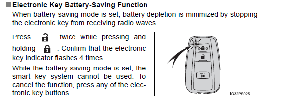

    Not totally necessary but you could also enable the SKS battery saving function. (It normally does it after not being used for 14 days but why waste that 14 days?)
