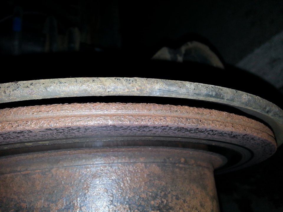

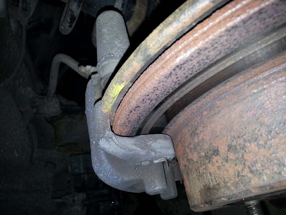

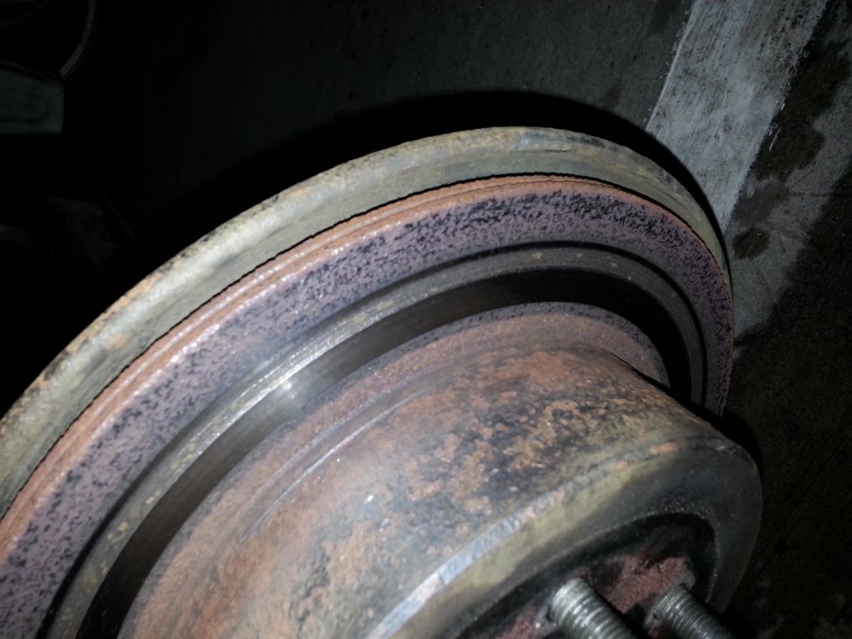

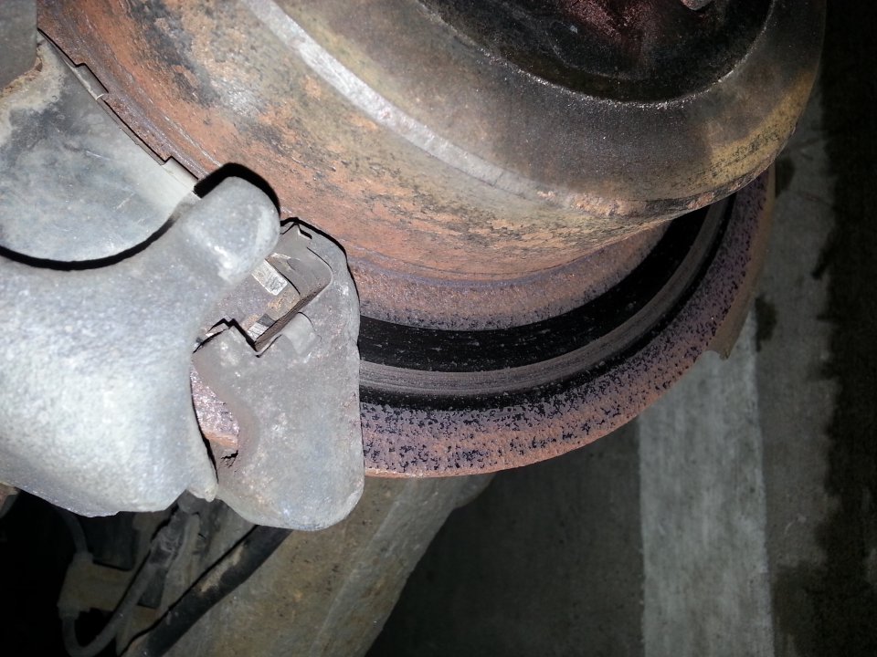

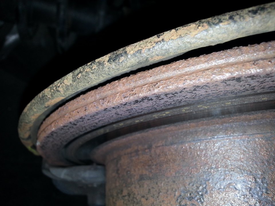

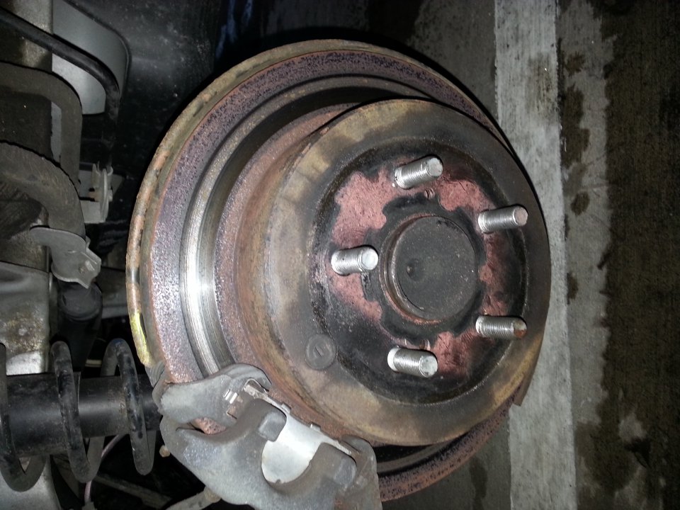

    photographs of my current rear discs at 186,000km with the location close to the sea.
    Could you please give me your opinions if I can make another months of driving with these discs or whether I 'really' need new discs?
    I would prefer to use the current ones for another while (just replacing the pads, cleaning the brakes, the pins, lubricating the pins within callipers and continue to use as they are.

    If I were you I would replace the discs and pads at the same time if possible.
    The problem with just changing the pads (after freeing the slide pins) is that the new pads will ware to the shape of the old discs. However you could continue the old discs as the brake performance will be no worse than it is now. This is assuming you do not do a 1000 miles a week, but some reasonable figure.
    Your discs look about the same as mine when I replaced them at about 80,000 miles.
    When you replace the discs the new used pads would not bed in for a long time, because they will not be flat. This will cause the new discs to rust where the pads do not contact the new flat discs.
    You could fit another new set of pads, but these are about £30 so could be as much if not more than new discs. The alternative would be to rub the new "used pads" flat on some sand paper before refitting.
    You will probably find when you remove the discs the back of them "the side you cannot see" will be worse than the side you can see.
    Hope this helps.

    Replace them.
    I'll wager that the inboard surfaces are even worse.

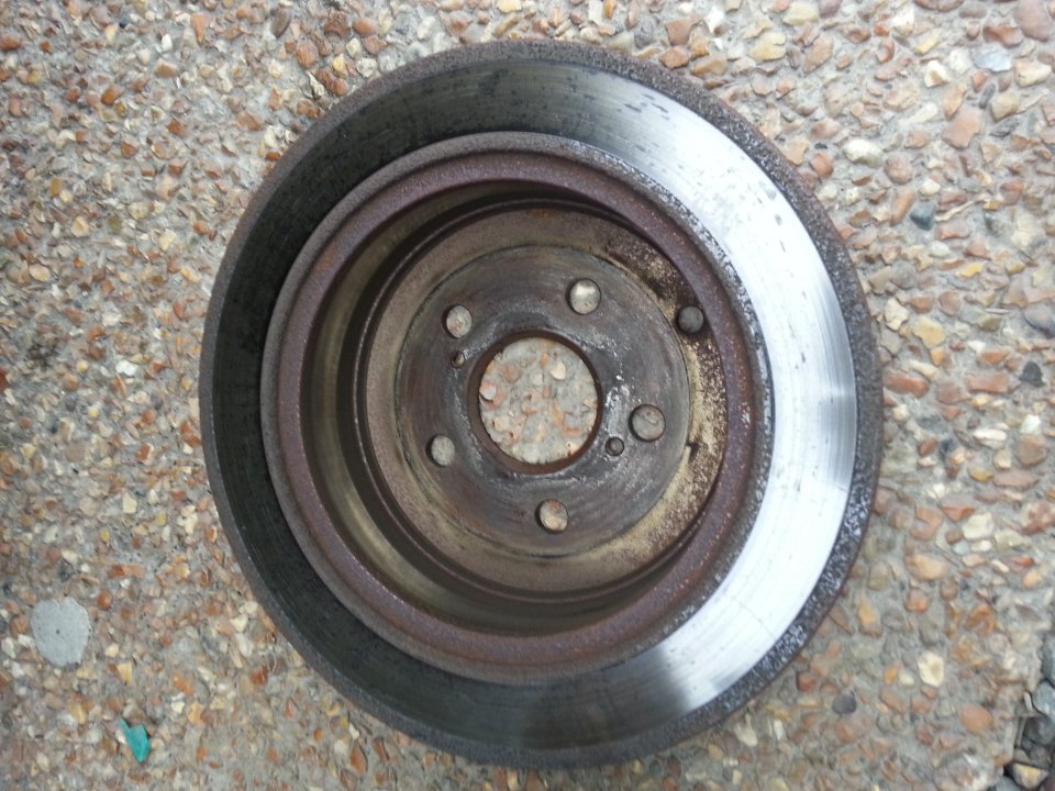

    Not a bad price at £23 delivered. Removing delivery cost around the same price as I paid nearly 18 months ago. The hole with the dark ring round it in the first picture is the parking brake adjuster hole.
    Make sure when you fit the discs make sure you clean off all the anti rust coating particularly inside the drum and the inside flat face of the drum. If you do not do that area when the brake warms up the coating melts and runs onto the braking surface of the drum as it spins.
    You may have to slacken the the brake shoe adjusters off to get the new drum/disc on. Inspecting the manual adjusters with the drum/discs off will allow you to see how they are adjusted and there relative positions.

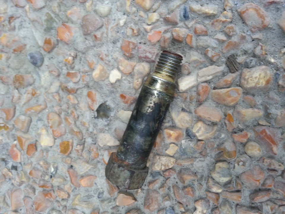

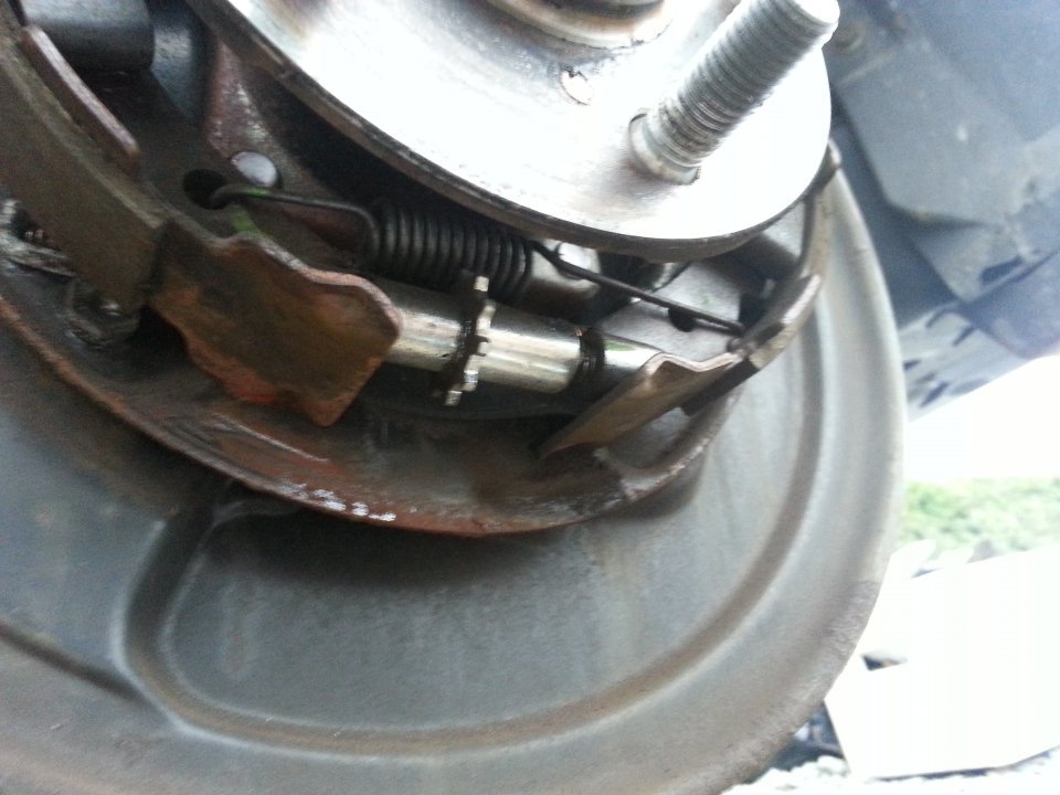

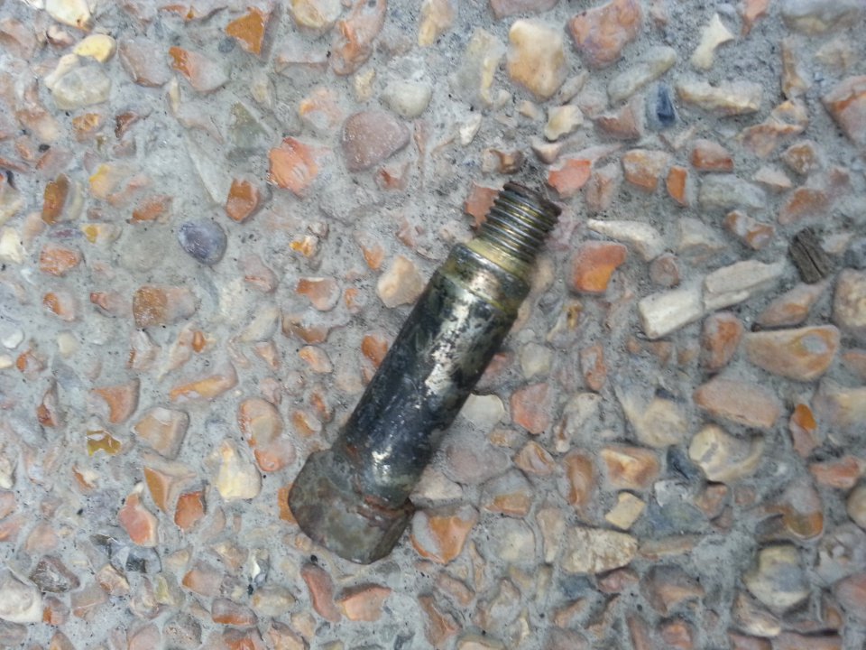

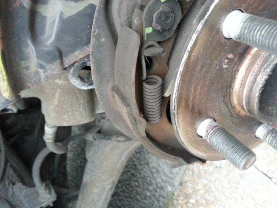

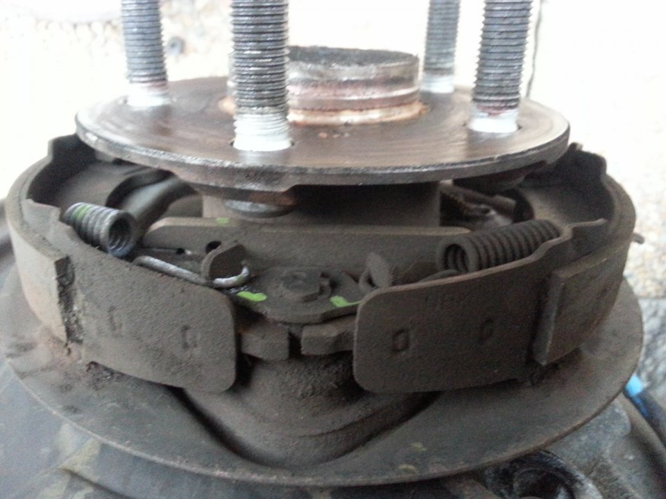

    I decided to check what caused one brake pad to wear and others to stay in tact.
    The two reasons: 1) calliper pin dry and dirty with no grease on it. 2) the metal plates which pad moves in and out were too dirty so the pad couldn't travel and seized. These were not shown on the pictures.
    Most of the pictures shows the brake shoes for the parking brake.
