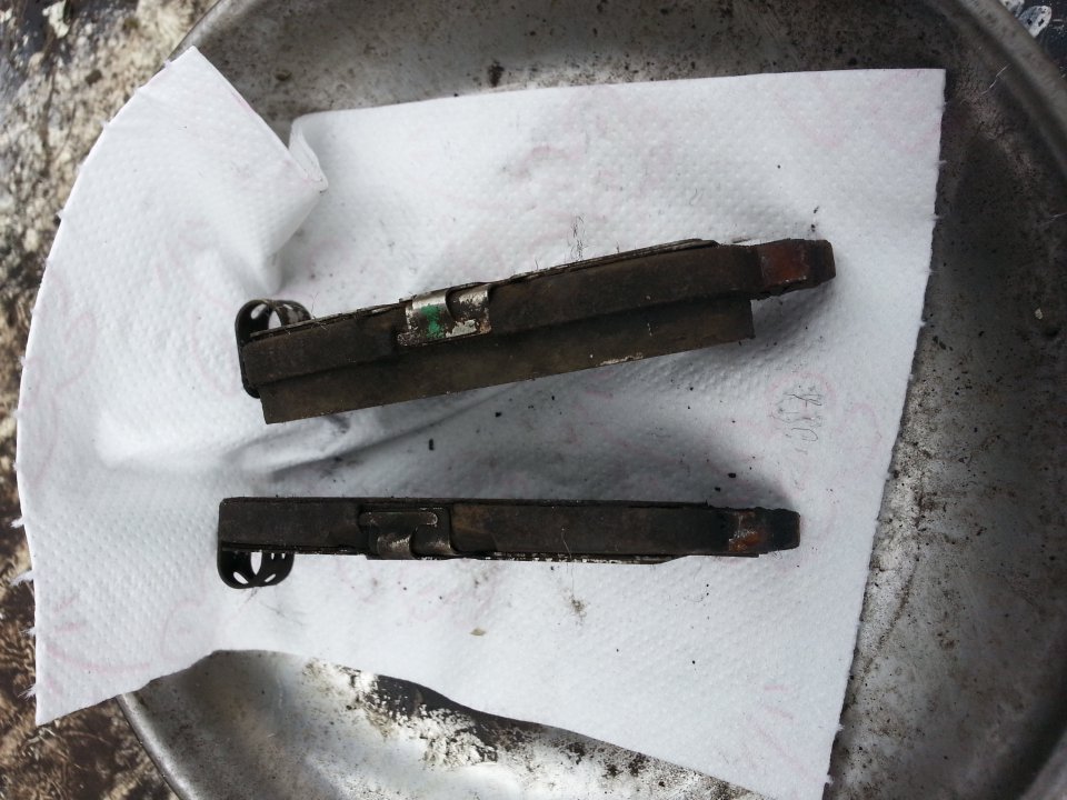

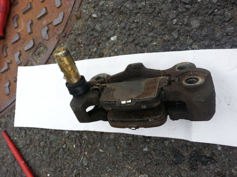

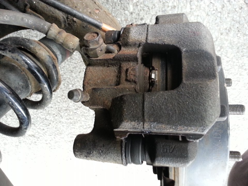

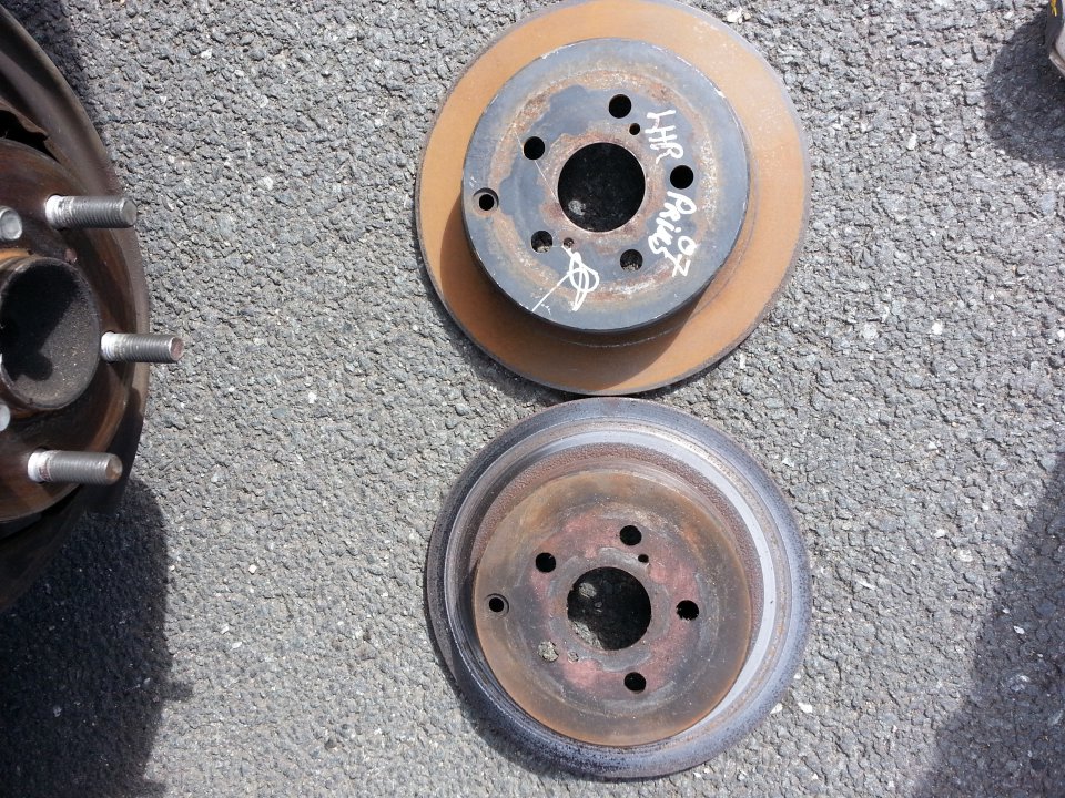

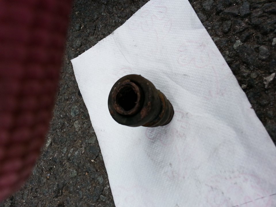

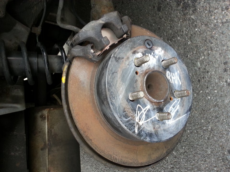

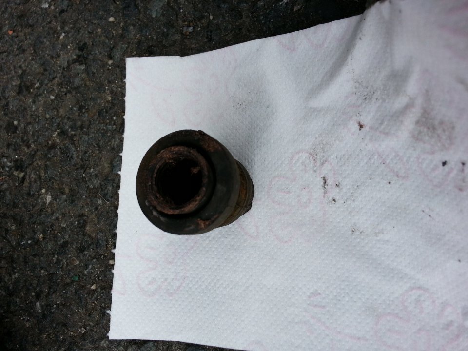

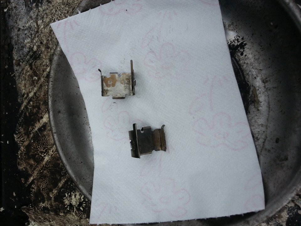

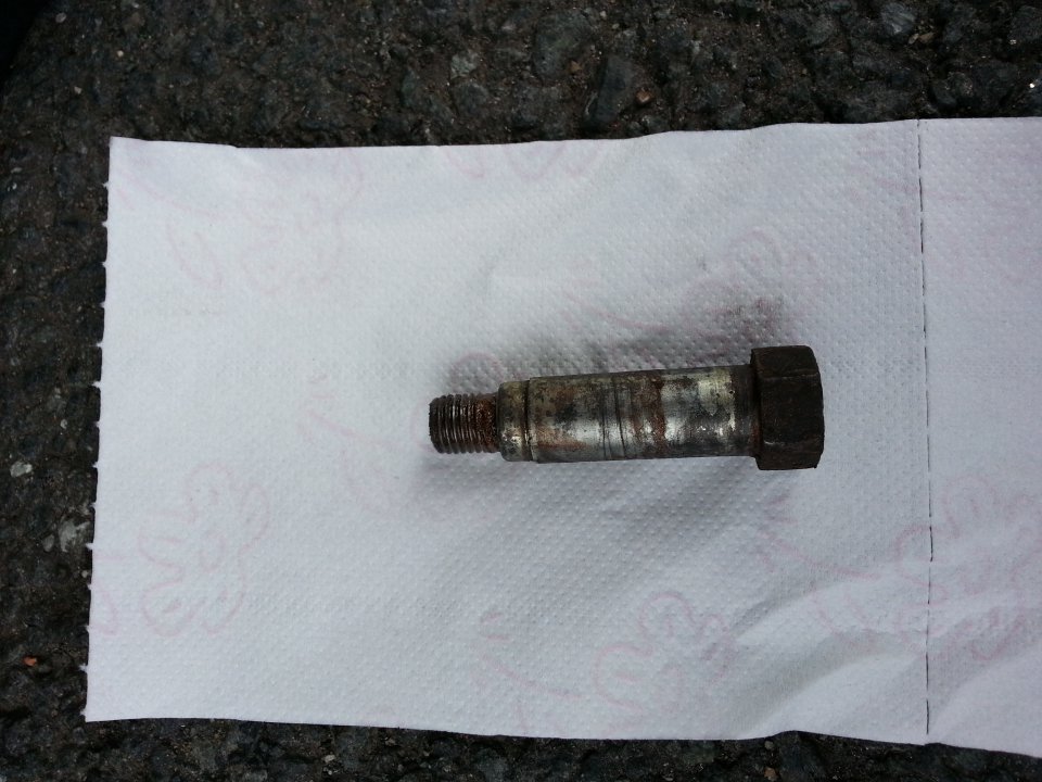

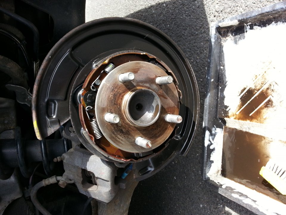

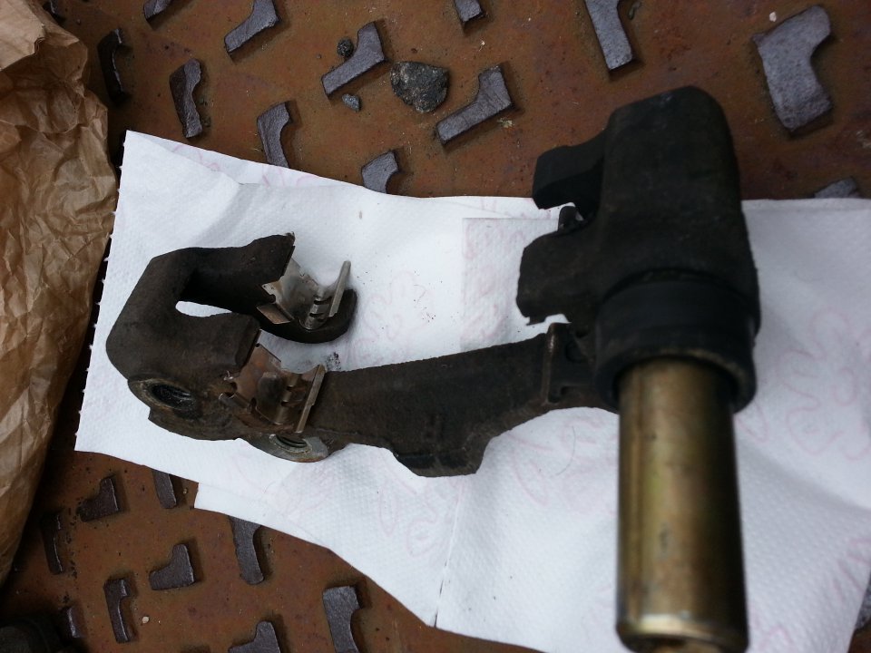

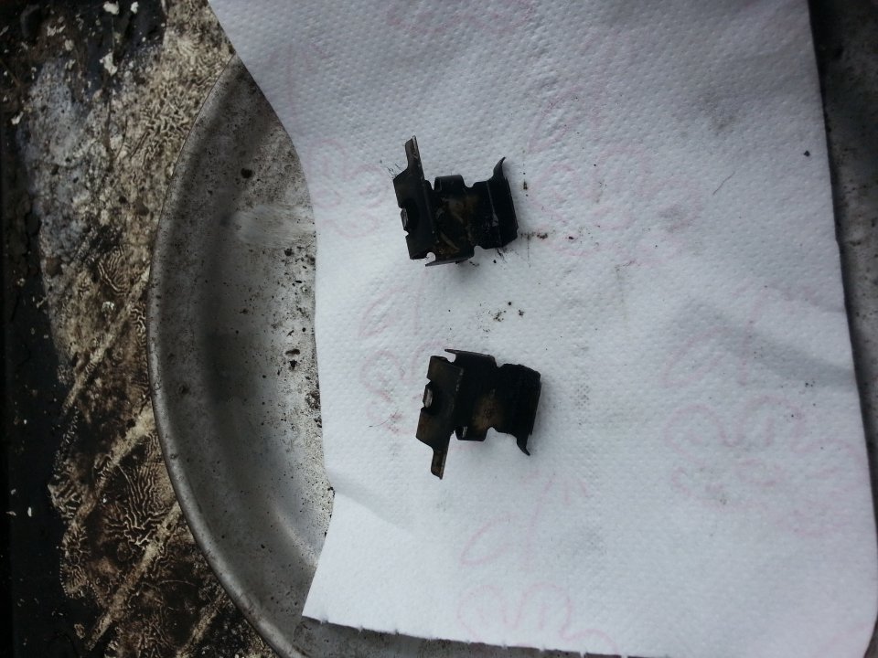

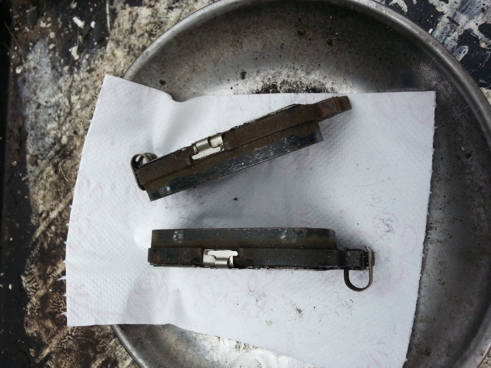

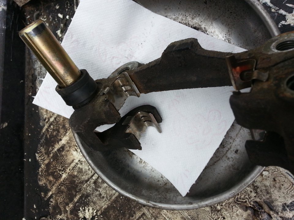

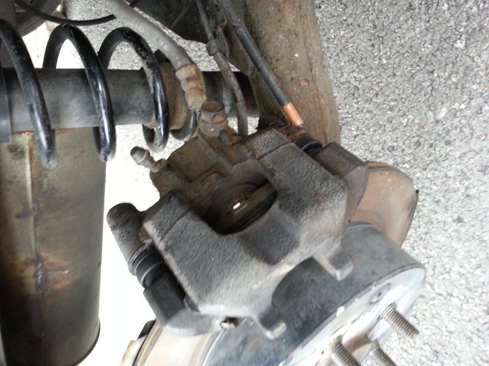

    Irish/British prius (read discs/pads with inner shoes)[make sure you disconnect 12v battery or remove capacitor prior to the brakes service, do not touch the hydraulic hoses with tools]
    Rear brakes service performed. About 4 hours. 2h spent at each of the wheels.
    I'm 100% sure that using copper grease is big fault. There is no space and the copper residues plays damaging effect on effectiveness of the movement of calipers and pin sliders as well as other components attracted to copper grease. Plus it's a terribly dirty grease and hard to clean in case if you decide ti use the correct high temperature grease.
    The reason behind this being an incorrect product is simple, the copper grease due to it's thickness and lubricant attached slides from the pin completely on the edges of the calliper pins once slided into the rubber, so all the grease is wasted to the top of the pin and none stays on the pin (adding copper grease inside the rubber slides doesn't help either as the grease moves along with the pin once slided. Therefore copper grease has no lubricating effect on the pin, similarly with the application on the edges of the brake pads, the metal plates on which the pads slides once applied with the copper grease have a tendency to attract the dirt and then to cause more troubles than help intended in the first place. These sliding metal plates/ elements which touch the brake pads needs a proper cleaning as well as the edges of the pads, then they work together correctly. The high thickness of Toyota grease allows the for lubrication, the proper grease looks like wax and appear to be the only correct solution).
    My test with one week of copper on one side of the rear brakes shown that copper has seized, attracted dirt and was too thick to allow the sliding of the callipers.
    Now, while I'm pretty sure the lithium grease I obtained is also incorrect at the standard lithium grease has a melting point at 120°Celsius ans some soap based lithium greases have the melting point increased to ~150° Celsius, we already know that brakes can reach 400-600° Celsius.
    Looks like I will need to order proper soap glycol based high temperature grease from amazon.co.uk.
    Dealerships tried to convince me that copper is suitable, I'm sure it isn't.
    I have a theory that garages and dealers use copper grease on purpose, so the customers will be back to exchange the pads, discs and perhaps other components due to use of copper grease. Once the part seizes then next is the temperature effect where things get overheat and other parts gets damaged. For some reason Toyota uses soap glycol based high temperature grease on these components and now I can understand the reasons behind. Pity that this product isn't available on the shelf in Ireland.
    At least I have cleaned everything where the movement is required.
    Dirty metal plates which are the first contact with the pads caused plenty of friction and pad seizures. These had to be cleaned with a wire brush (which I didn't have so I used screwdriver) and metal wool.
    The technique John mentioned to adjust rear parking brake was extremely helpful and saved me trouble.
    As well as the idea with using petrol for cleaning was great for cleaning these parts.
    The advise from css28 to use metal wool was uncompromising, I used Fine metal wool which was brilliant for this task.
    I called the salvage yard to ask if they can source front discs and pads.
    At 187, 230 km's such service is a must ( you may perform it sooner depending on the climate you are in )

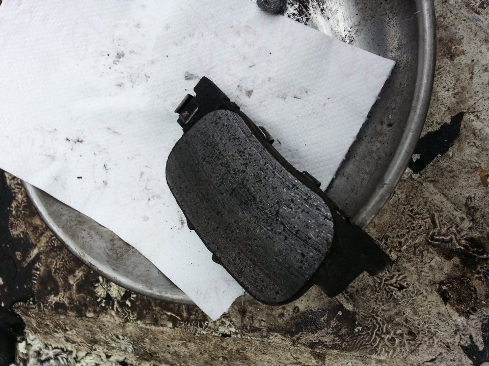

    On the other side (RHS) I also noticed premature wear of the inner brake pad.
    Pictures attached.
    This will need another go once I get the correct high temperature soap glycol based grease.
    For the time being this troubleshooting attempt remains open for corrective completion.
    Thanks everyone for help to date.
