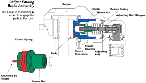

    Start by putting that nut back where you found it, to the best of your ability to remember how many turns you moved it. It's not part of the game unless the parking brake pedal or cable have been replaced or the cable has been stretched by Sasquatch driving the car. Cable stretch, if involved at all, would have happened over years, and would have been noticed starting before the brakes were changed.
    Did you replace the brake calipers, or only the brake pads and minor hardware? If you replaced calipers, where did you get them?
    One key is to start by applying the service brakes (properly bled first, if need be) enough to bring the pads fully toward the rotor. That movement of the piston, under fluid pressure, is what spins the sleeve nut outward along the adjusting bolt so that the pads will meet the rotor when the parking lever cam pushes on the bolt.
    If that doesn't take care of it for you, check whether you see the piston move at all when you move the parking lever on the caliper by hand. (You'll also see then if anything is weird with the parking cables' connections to both those levers.)
    If moving the lever doesn't move the piston at all, or applying the service brake doesn't advance the piston along the adjusting bolt, something is amiss inside the caliper. The storyline splits here according to whether you still have original calipers or you put replacements on that came from somewhere.

    If there's anything about the original calipers that calls for rebuilding, the rubber kit is inexpensive. The caliper body is aluminum and probably just fine to rebuild and reuse.
    More about testing the return of the caliper piston (easy enough to check, I would do so on any caliper, dealer, rebuilt, or aftermarket, before going to the trouble of putting it on the car) can be found in this post. (That post happened to be about gen 1 calipers, which were iron and could get rusty too, unlike the later aluminum ones you've got.)

    That raises an interesting point about the rubber kit available from Toyota—as far as I can tell, it doesn't include that seal. So if a caliper starts leaking from that one, there's no fixing it with the Toyota kit.
    Other than that, rebuilding is pretty straightforward. With the right red glycol / lithium thickened grease on the seal (a little packet of it comes in the Toyota rubber kit), inserting the piston shouldn't be too hard. Not a strength exercise, make sure the piston is straight, easy does it.
    Confession: that's from general experience; I've never rebuilt one of these rear ones, where you have the added challenge of getting the sleeve nut threads started onto the adjusting bolt, with the clutch spring in position and anchored in the piston, then rotating the piston as you press it in. Maybe easiest to hold things with the piston down. Still, I would not expect it to be too hard.
    If you rebuild the originals and the parking brake then works, it could be interesting to take the aftermarket ones apart to see why they don't. Maybe it could be as simple as the clutch spring being left out*, or not anchored in the piston as shown. Wouldn't say much for any functional testing done by the rebuilder ....
    I'd check the piston return after rebuilding, as described at the link I included in #8, before putting the calipers on the car. No surprise there—I would do that test in any case. But this just reminded me of it because I seem to recall the Toyota pistons having a kind of matte finish from the factory, which might be part of the magic giving the rubber seal a good grip to retract it. I remember an aftermarket caliper that had zero piston return, and that rebuilder used a piston with a very smooth mirror finish, which I speculated could be part of the problem. I assume all you did with the 3000-grit paper was lightly clean the piston, but not really leave it with a 3000-grit surface finish.
