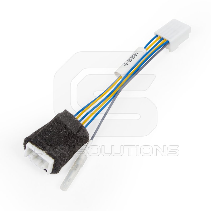

    Just thought i should jump in here, in my 3rd gen i got a front camera, and three things to notice (atleast about 3rd gen)
    First: dont buy a reverse cam, the image will be mirrored when used as a front camera (duhhu, i shouldve thought of that lol)
    Second: The wireless transmitters do react to other signals, so when u r in town or driving around a city or houses or something the camera might flicker, not that i care about that just thought i should tell ya

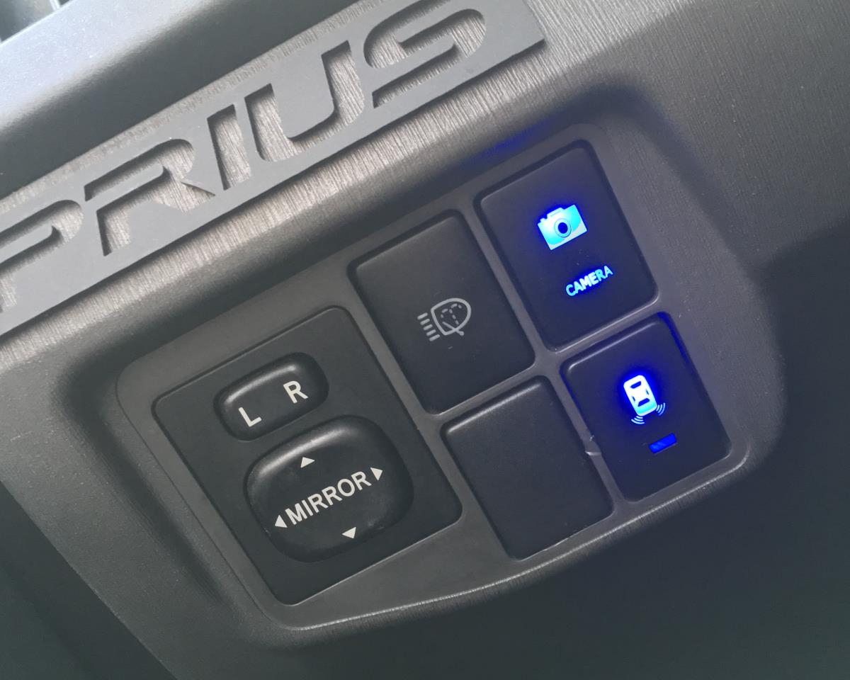

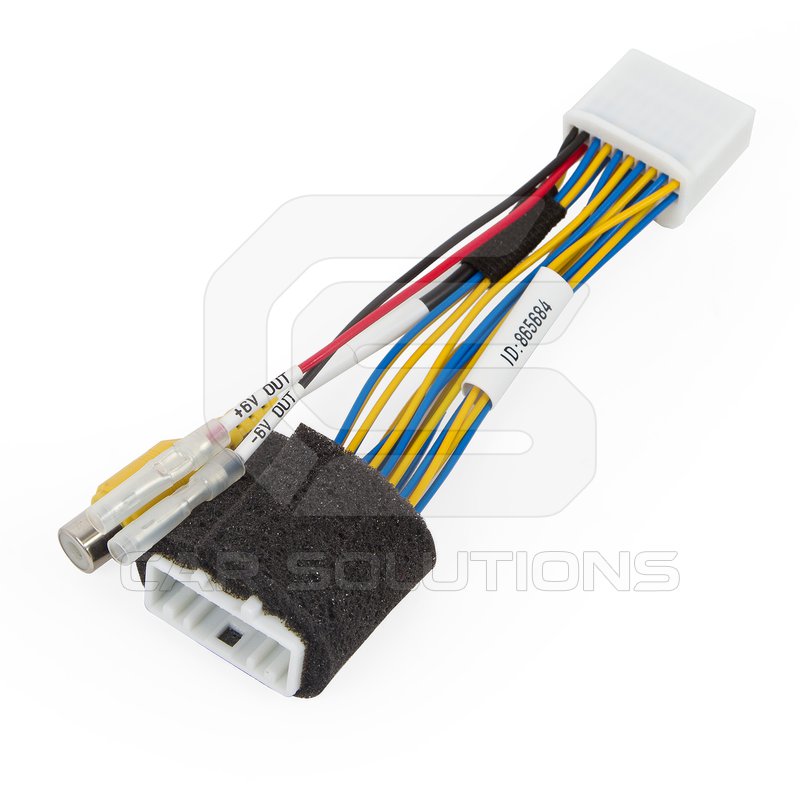

    third: i got the version with parking assist, and i stumbled into a problem when i tried to hook the front camera up with the navigation with the extension harness for the nav unit i bought, i thought that since i got the parking assist the rear camera is hooked to the assist then the asist is hooked to the navigation with another cable, so i installed this first and second harness (pics below), the second one is the activation harness, like for the activation button. i got everything ready and i used a 2,4ghz reciever on the nav unit and a sender from the camera thats in the front (so i diont have to go through the fire wall). But yea.. i hooked it all up and when i pressed the camera button the rear camera came up.......................... not the front.............. so yea... that was uselss, i wouldnt try to add a front camera into the nav unit, if i were gonna add a front camera to the nav unit i wouldve bought a car that doesnt have cameras at all, then bought the extension and a split screen box so i could hook up both cameras to the split screen box then putting the video cable from the split screen box into the nav unit, that way u got both cameras installed and it looks like factory made.
    This is the video cable extension thingy i bought [​IMG]
    and this is the activation cable [​IMG]

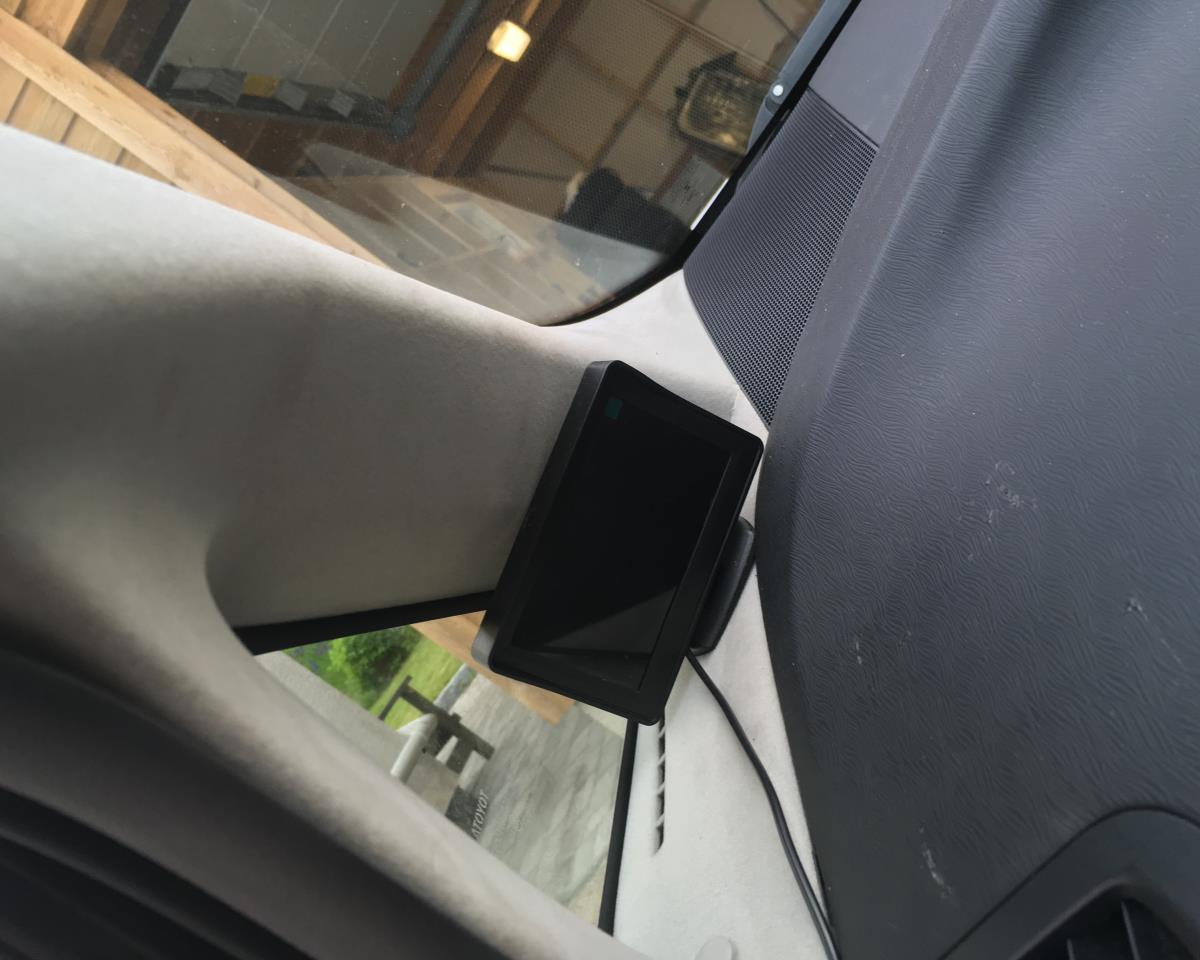

    So i ended up buying a second screen to have the front camera on instead of messing around more with it [​IMG][​IMG]

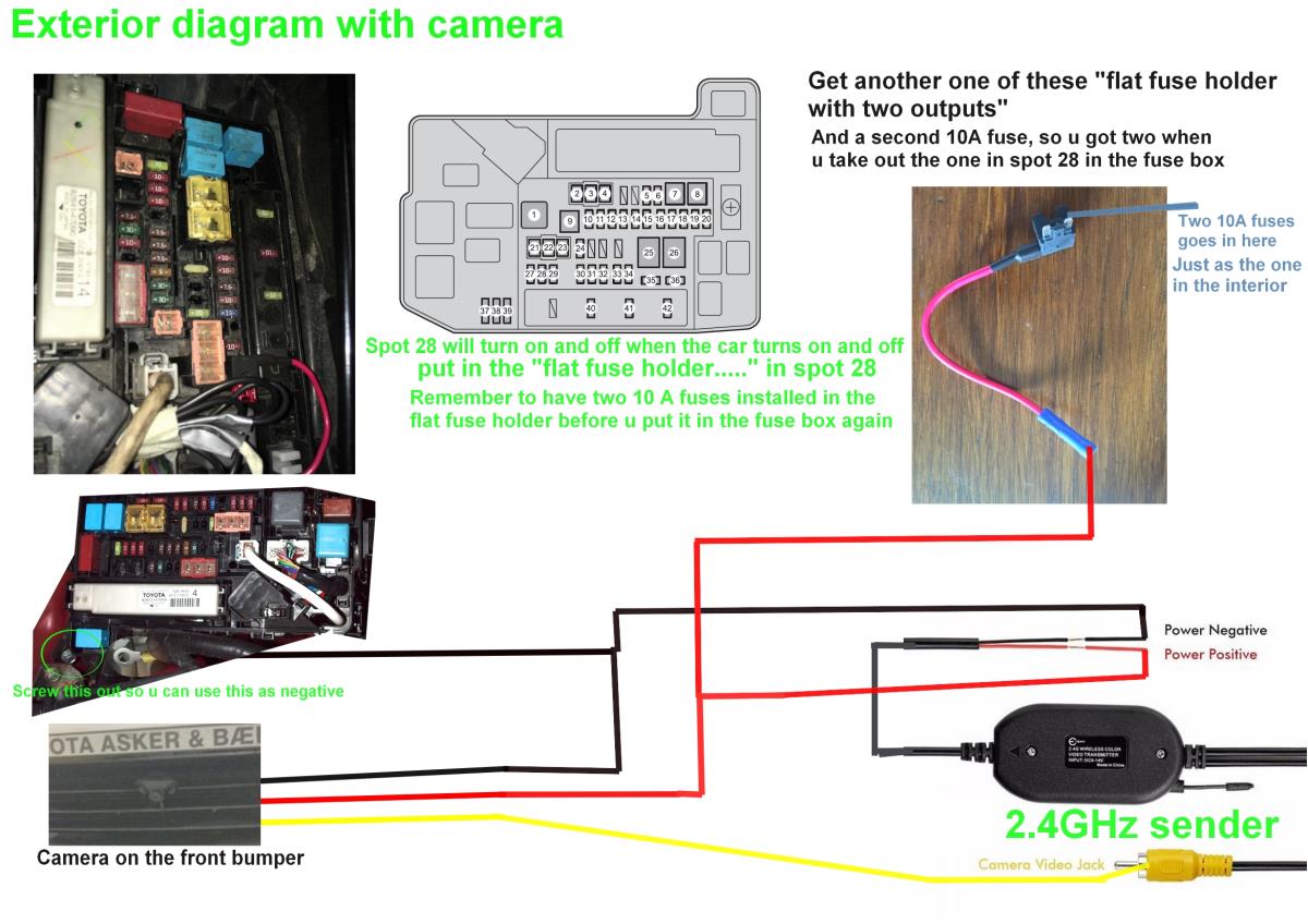

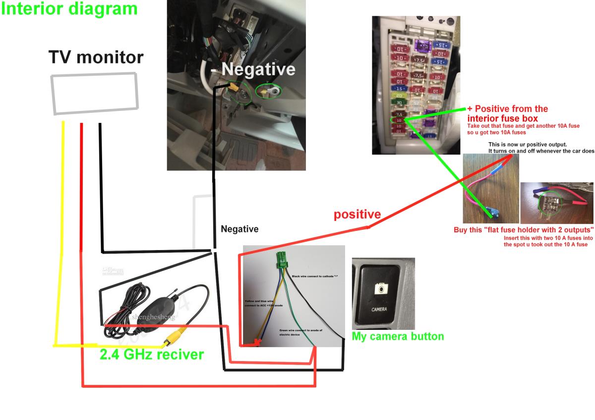

    ill leave the wire diagram i made and used in the pics below here, who knows, maybe it can help u or make ur job easier. [​IMG][​IMG]
