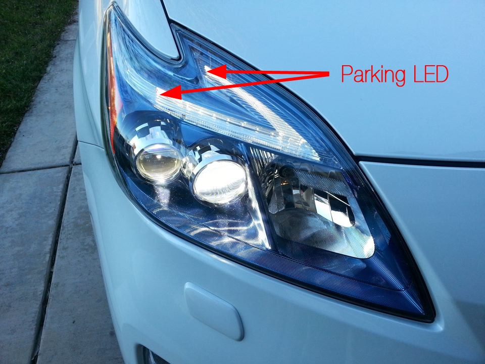

    Hey guys!!! I'm new to here and I'm looking for your assistants regarding the parking LED light issue.
    Anyway, the problem is the one LED light not working properly and I think its burned out. So,
    * Anyone know how to replace that LED light?
    * What is the type of the LED?
    I really appreciate your help.

    Those are not user replaceable. Take it to the dealer for replacement under warranty.

    Actually I'm using a JDM auction car and I haven't a warranty for my car but I can go for the TOYOTA company to fix it.
    So, anyone know what will be the total cost for that(approx)?? Also will it replace the head light?

    They will replace the entire lamp housing and swap the headlamp bulbs (and any other removable bulbs) to the new housing. Except for the LED headlamp equipped cars, that means any other LEDs are integral to the housing, and the housing must be replaced if they burn out.
    It is possible to take the housing apart by melting the thermo glue that holds it together, then replace the LEDs, and then reassemble it. That takes some skill, a good oven, and about 50 cents per LED. The housing is typically in the $100 and up range. Probably closer to $300. Someone can look it up, but there are several different designs for different countries, and even different designs in each country. You could just order the housing from Japan but you will need a detailed description as there are several different types. Exact date of manufacture of the car, which side, and type of headlamp are a good starting point.

    If you have no warranty on it I would just leave it be. It's going to be very expensive to fix just for that one bad LED.

    I’m experiencing the same issue with my 2012 PiP Advanced and it’s SO annoying.
    But as another user mentioned, it’s insanely expensive to replace the LED headlamp unit. Out of warranty Toyota dealer quoted $750 for a new housing unit and $250 install *cry.
    Sorry to revive an old thread, but figured I’d throw out the most recent quote info :)
